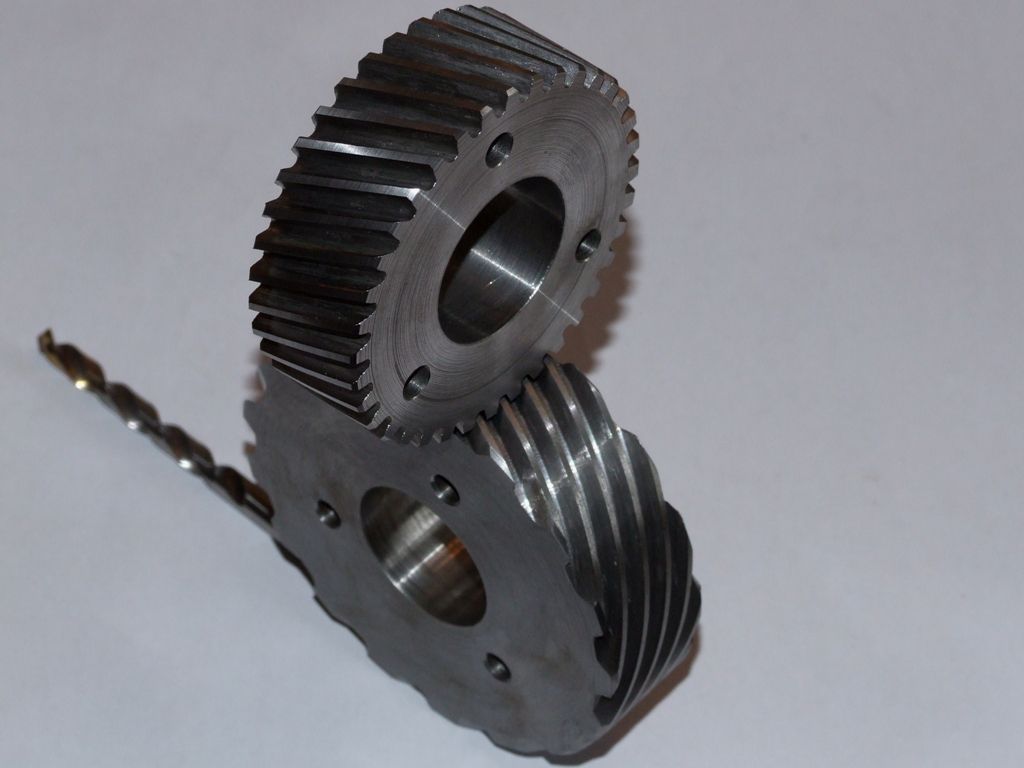

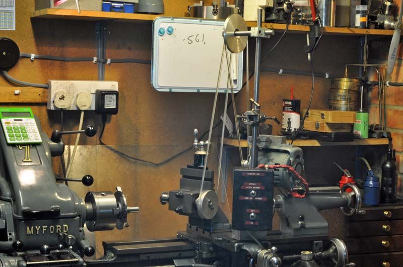

          Probably easier to arrange a milling spindle on the lathe and rotate the leadscrew by hand. That's how I made the helical gears for my Wyvern engine.
          On the mill you will need to connect a gear on the X axis leadscrew to something like a dividing head. An alternative might be a timing belt. One way or another a bit of construction will probably be involved.

            In the absence of smartypants equipment I'd be with Rod; use the lathe but using the leadscrew to drive the spindle. Whether one uses a single point lathe tool to cut the thread or a milling spindle would depend upon the thread form. A square thread could use either method but Acme, V or buttress might be simpler with a single point tool.
            The problem with Rod's method for cutting a short lead tap is that the milling cutter needs to be larger diameter than the milling spindle so the tap can pass under the milling spindle. Again milling machine manufacturers used to advertise short lead or rack milling heads which had a small diameter to pass over the work while still being able to cut the thread, or rack.
