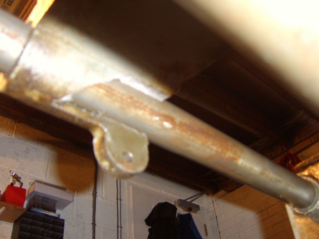

        I thought my hamfistedness was receding into the past but I was wrong
        I have broken the locking mechanism on my tailstock. The lathe is a roundbed Barker from 1947 so finding a spare is probably not an option. Imagine two parallel iron bars with the tailstock base being two round sleeves over them with a flat jointing piece.
        In one of the sleeves is a slit to allow a handle to close it to secure the tailstock against the bar. Well I have over tightened the handle and snapped the casting so the opposite side with the thread in has broken.
        After nearly punching myself I began to think of possible solutions:
        1. Have a new one cast but goodness knows what that will cost
        2. “Glue” the two halves and then drill small holes to take carbon steel rods which will be glued or somehow welded in or the whole until somehow heated up to get them to bond
        Can anybody suggest anything else or advise on the above?
        I can get by with a temporary fix using timber stays of several lengths to brace the tailstock against the end of the lathe
        Thanks for any help in this time of crisis

          I suspect that it might help if you could post a picture or two of the damage. I can’t imagine that a repair would be impossible, though – these things are usually manageable one way or another.

              I don’t know the lathe apart from the pictures on Tony Griffiths’ site, but going from those I’m sure a repair can be effected. It looks to me as though the clamp that you are talking about is under the tail-stock at the rear, and the lugs that give the clamping action project downwards. If it’s one of those broken off your best bet will be to find a welder used to or capable of dealing with cast iron and get them to do the repair. You’ll probably have to clean the bore that goes on the bed afterwards but you’ve got a long contact with the bed so local filing should be ok and not affect the accuracy. if the worst comes to the worst it look as though the tail-stock is in two parts. The upper barrel assembly and the lower carriage. If so it looks as though a carriage shouldn’t be too difficult to fabricate from steel sections by welding, and you could make the parts and pin them together on the lathe for alignment before welding or brazing to make permanent.
              Not a quick fix but both solutions do-able and shouldn’t be too costly.
              As a temporary expedient can you make a clamp to fit around the split sleeve to squeeze it up or use a G clamp?

                I like Keith’s second idea, so I offer the following as something to at least think about…
                I had a look at the pictures on T.G.’s lathe site (good idea, that!) and I think I can see how this works now. And it strikes me that if it’s possible for this to happen once, it could happen again. Also, unless I’m mistaken, the locking mechanism itself looks somewhat inaccessible. Which means that Keith’s idea of fabricating a new carriage could be a positively good idea – because you could then re-think the clamping mechanism so that it was more accessible, and probably end up with a more rigid tailstock carriage as well.
                I would have thought that if you fabricated an assembly out of steel so that the split was effectively horizontal, then you could even fit the new assembly without dismantling the end of the lathe, if you extended the slit across the entire horizontal plane. In other words, you’d end up with a carriage that was sandwiched across and between the bars. So you’d bolt and shim the two halves at the front, and have a locking bolt facing upwards at the rear – in the middle of the carriage rather than at the end, where it is at present.
                Okay, it’s not a quick fix, but it might be a better one.

                  Posted by Keith Long on 12/02/2011 11:02:20:
                  Yep that’s how it is. There is more metal in the lug than in the bit of the casting that broke hence the over tightening caused it to snap where it had the least strength. My brother in law is a coded welder so I shall ask him.
                  Thanks for all the suggestions. After a day with the kids away from the garage I feel more positive about things and can see a way out of this. When it happened this morning about 8am I could have happily punched myself for being so dumb at over tightening it.

                            Posted by Terryd on 12/02/2011 23:02:54:
                            Any chance of posting a couple of photos in your album? There are some other methods of repair you could use but it depends on the casting.
                            Now added
                            Here is the underside (sorry for the out of focus)
                            And here’s the broken lug

                                You have my sympathies – that has to be one of the worst bits of design I’ve seen in a long time – I’m amazed that it hasn’t snapped before. Not only are you expected to try and close up the slit in the casting to lock the slide, at the same time the action of clamping is trying to force the whole end of the sleeve into a cone shape – hence the 45 deg or so line of fracture from the end of the slit to the “hinge line” for the lug. I suspect you’ve had a the beginnings of a crack on that hinge line for some time.
                                If you can get it welded I’d concentrate on getting the lug welded and not worry so much about the angled split (I’d even be tempted to file in a bit of clearance), clamping then would close down the intended slit with out trying to distort the rest of the sleeve which the original design is doing.
                                If the broken piece won’t go back in and weld satisfactorily then look a making a steel strap that can be brazed to the outside of the sleeve, braze the broken bit in as well so that it will clamp down on to the bar but eave enough give in the strap to allow it to close when clamping. Mild steel will put up with the stresses better than cast iron anyway. It probably wouldn’t look very pretty but I think it would be stronger, easier to get a good result and you’ll get the lathe back and working with it’s original parts.

                                    From the pictures it looks weldable, if you are handy at Arc welding you could try “Magna 770” rods after V-Ing the joint out then short welds & peen after every weld.
                                    I’m no expert but have done some creditable repairs on “unknown” dirty cast iron with these rods.

                                        Posted by _Paul_ on 13/02/2011 12:33:49:
                                        I’ve got a 160 Amp MMA stick welder and my brother in law has the skills (it’s his day job!) so if I got some of these would they be the right ones?

                                          Point taken. I think a bit of redesign should go along with the work to restore it (cosmetically at least) to original
                                          If my brother in law says it’s weldable with the rods suggested by Paul then I think I might get him to do it so it looks original, but then design something else to actually lock the tailstock
                                          First thoughts are a kind of handcuffs arrangement that clamp over the two bars but then each cuff has a horizontal lug facing outwards that is slit with a locking screw or bolt. At least that way the forces are distributed evenly rather the locking being done on only one of the bars, as with the original design
                                          Thanks everyone. I really am feeling an awful lot better now about my cock up and have stopped beating myself up about it
