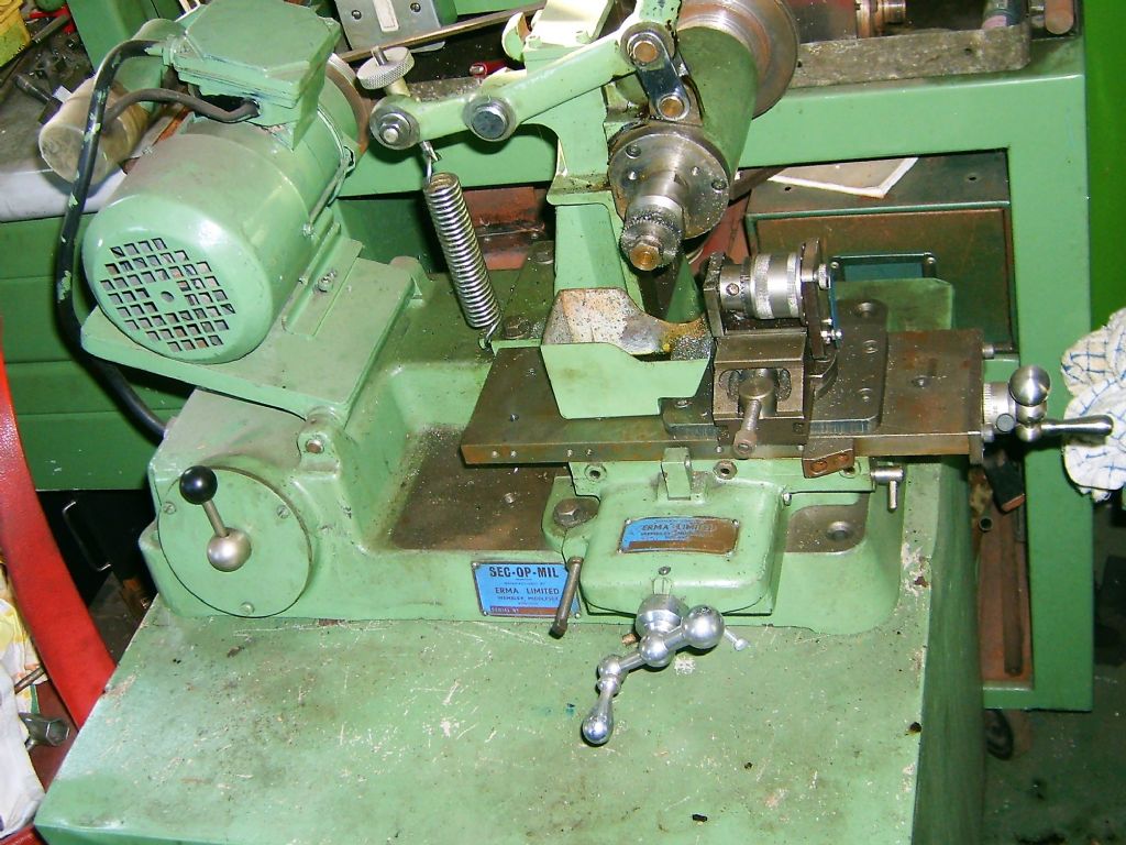

Has anybody come across one of these
Home › Forums › Workshop Tools and Tooling › Has anybody come across one of these
Viewing 21 posts - 1 through 21 (of 21 total)
  • #330056
    Paul White 3
      @paulwhite3
      #18759
      Paul White 3
        @paulwhite3
        #330057
        Paul White 3
          @paulwhite3
          This verb age should have been with the photo above.
          The name of this item describes the tool. its robustness indicates an industrial purpose. The photo shows my use of it to reduce the size of hexagon heads.
          Any info would be most welcome.
          Thanks. Paul.

            Paul White 3
              @paulwhite3
              Alan, thanks for the reply. The item is a horizontal mill for second operations, made up of a very solid base with a powered vertical slide and a 2 way table.
              Do you know if the Erma you mentioned were at Wembley?
              Paul.

                                  SEC-OP-MIL – could that be short for 'Second Operation Mill'?
                                  Second operation lathes had all the bells and whistles removed. They were used to keep costs down in production work to avoid swapping tools, chucks etc on the main machine, perhaps a fully populated capstan or turret lathe, that did most of the work. Perhaps the same idea was applied to milling machines, this one being a horizontal mill with a single axis.

                                        I can see what looks like a modified keyed chuck with a small indexing plate at the back. There is also a very dinky swarf bucket. But I can't see a hexagon head. Am I missing something?

                                            Alan, the vice ,indexing chuck and swarf tray are all items I made to use the tool. The mandrel has 2 cutters with a spacer to suite whatever across flat dimension I want to produce. In the photo. there is nothing shown in the chuck. It can of course be used with end mills.
                                            Thanks for the responses.
