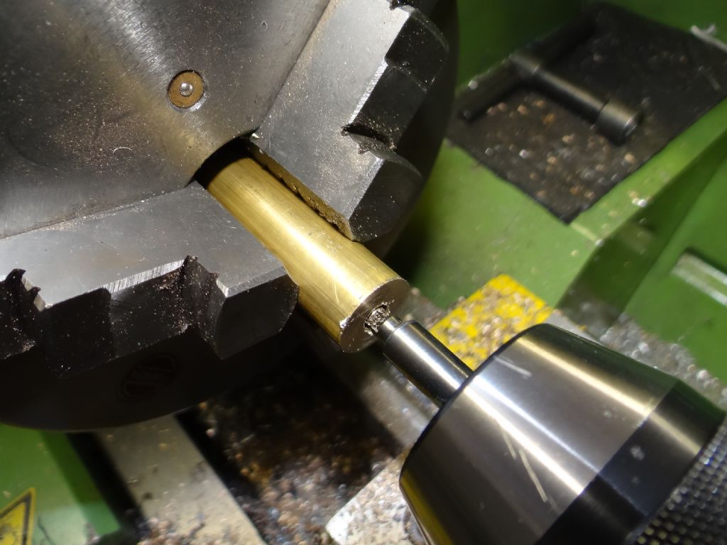

              Success!
              Can't be seen in the photo but the cutting diameter is chamfered into the main body as suggested by Nigel. Heated to bright red-heat in a dim room, then plunged vertically hole end-up to reduce chance of an airlock. Polished whilst still warm and blunt end heated on an insulating fire-brick until the yellow line reached the cutting tip as suggested by Hopper. Camera isn't capturing the colours accurately – the silver steel is rather bluer at the drill-chuck end than it appears.
              I have to make another one to prove it's not a fluke!

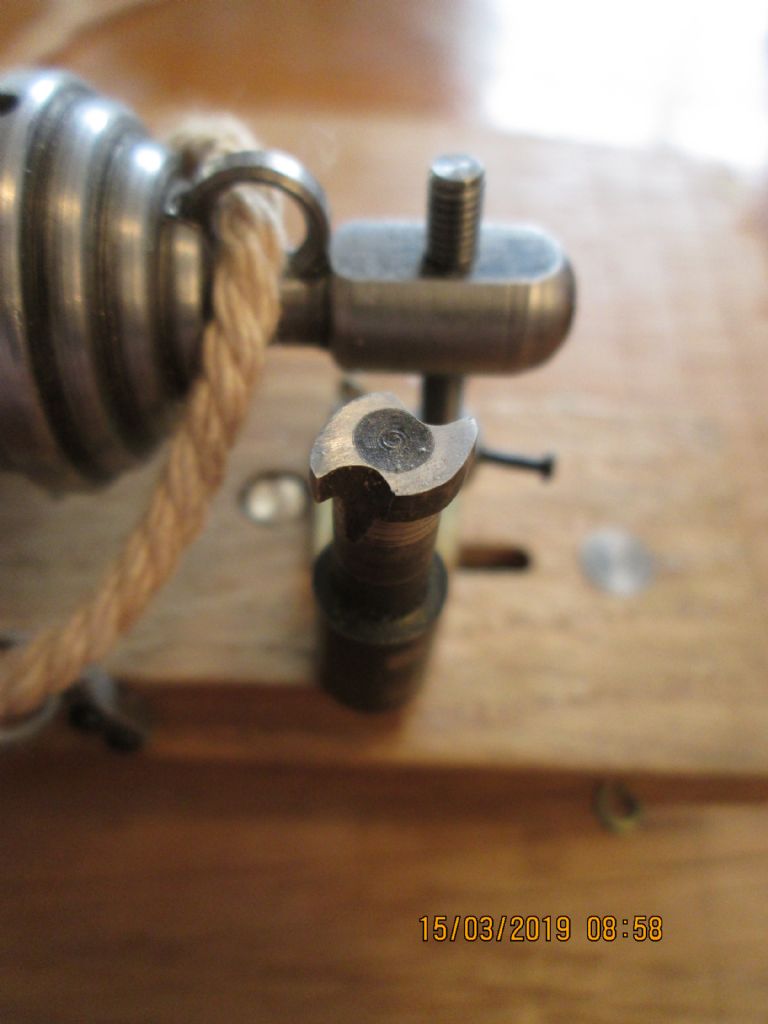

                            I made this little cutter to slice out the radiused groove for the cascabel ring on my carronade. It was turned, then offhand ground. I used a butane blowlamp to heat the tooth tips bright red and quenched in the grinder's diptank. On the second attempt when I held the red heat for half-a-minute or so, it worked – the teeth resisted filing. Then I polished the end face and played the blowlamp on it carefully with pauses between quick heating passes until I saw the light straw oxide, then quenched again and finished the tooth surfaces with an India oilstone.
                            OK, so it only had <10 mm3 of EN1A to remove, but the teeth are still hard and the shank fileable. It's about 11mm. diameter, plain silver steel.
                            Edited By Mick B1 on 15/03/2019 09:25:20
                            #400842
                              Just to finish this one off, I've made progress! I can now make tools that are too soft, too hard, or just right to order!
                              I think my main problem was the mix of thin and thick metal involved in making a core drill, plus the construction is likely to trap steam inside and spoil the quench. Judging the temperature and holding it for a suitable amount of time is a little tricky: I was working on soak time calculated on the thin part of the metal (ie not very long), and have found that the time needed for the full thickness gives better results. Better control of the light in the workshop helps judge temperatures; full brilliance needed tp see the straw oxide layer during tempering, and rather dim for seeing cherry red before quenching.
                              Heating the silver-steel whilst it's laid on a fire-brick rather than holding it in a pair of pliers produces more consistent results. It's easier to avoid overheating the thin end while the main body is still warming up. Laying on a brick also makes it easier to accurately chase the straw-colour up to the sharp end during tempering.
                              Thanks again,
