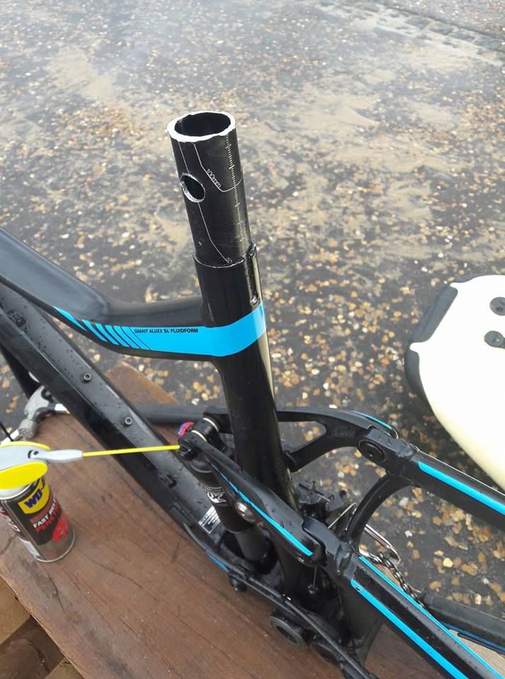

        I sometimes get bikes in with seized/stuck seatposts, is there such a thing as a slotting hand saw with depth stop to avoid cutting into the seat tube or do I need to invent one?20229238_1567833876582239_7423887733280616344_n.jpg

          I had the same problem.
          Try making a wooden clamp to go round the seat post – two pieces of 2×2 say 12 " long bolted together with a hole drilled through slightly smaller than the seat post so you can grip and twist the post. think tap wrench for design. if necessary line the inside of the hole with leather. You can then gently heat the down tube with a paint stripper or hair dryer on low. keep it at a good distance and move it around constantly to avoid damaging the paintwork. The leverage on the clamp should allow you to turn the seat post and work it up wards. You can also tap the wooden clamp upward to help to release it . The down tube is generally thinner than the seat post so should expand more quickly and release. If that fails google BAHCO 208 hacksaw blade holder but it will be a slow process!
          With a good twist on the clamp, mine came out quite easily in the end

                I did – but firstly the tommy bar approach means damaging the seat post beyond further use. In addition the looseness you generally get with a tommy bar tends not to allow the steady constant force you can impose with a well fitting clamp . Also the guy suggested this is more than just a one off, so making a clamp which will allow for a little variation in seat post diameter gives him a tool he can use over and over again when the need arises. Finally, setting the clamp up against the un removed seat not only doesn't damage the seat post but also allows the clamp to have a solid face to work against for upward taps which you cant achieve easily with the tommy bar approach .

                  It sounds like you are trying to salvage a seat tube while destroying (cutting) the frame!
                  As the frame is very thin would a pipe cutter (clamped on cutting wheel) work? Or perhaps a pipe cutter or just block of wood with hole in it modified to hold a v-tool to score / cut a groove as you rotate it.
                  A longitudinal cut / scraped groove might relieve the griping force while allowing in oil and have some chance of repair.

                    If you can get the seat post out with a wooden clamp as you describe, that isn't a seized seat post, it's a lightly stuck one!! smile p
                    With a properly seized one, the post is invariably scrap. Brute force, whilst not damaging the frame in the process, is normally the only solution, so the post becomes the sacrifice.

                      No, the seat tube is the bit of the frame that holds the seat post. The OP is definitely trying to save the bike frame!
                      A decent penetrating oil (not WD40) and some gentle heat to persuade it to penetrate as much as possible, plus some time to soak in, maybe overnight, would be how I would start. More heat when you try and twist it out. If you can clamp the frame to something really solid that would be a big help – modern frames are so light that tapping anything clamped to the seat post will just move the complete bike rather than just the post.

                        I would go along with the slide hammer. Make a threaded piece about an inch long with an outer diameter that will just pass through the seat post, and put an m12 or 1/2inch thread through it. Lock it onto some studding with a couple flock nuts. Slide the piece in and locate it in the frame below the seta post. Stand on the frame and using a good sized lump as a slide hammer on the studding, hammer away. I have used a slide hammer on a lot of corroded joints with dissimilar metals and it has mostly worked. Trying to collapse a part may make things worse by swelling as it is misshapen.

                          The way I got the buried seized seat post out was to take the bottom bracket out, pass a long piece of studding through the seat post right down to the bottom bracket, I selected a couple of stout washers just smaller than the ID of the down tube, put them on the studding, then a nut.
                          The top end of the studding was clamped in my 5" record bench vice, and I then used the frame as the slide hammer!
                          It is a bit of fiddling getting the washers and nut on the studding, and you need to move the frame in the same plane as the studding when using the frame as the slide hammer, but it is very effective as all of the moving force is directed at pushing the seat tube up and out.
                          I also wouldn't recommend this for a carbon frame!!

                                                    If you want to try a Slide hammer, why not make up an expanding arbor, (OD for last 5 or 6 mm JUST less than Seat Tube, the remainder 2mm less than Seat Post. Bore a an internal taper in the large end of the arborl (before making at least four slits in about 25mm long) and then bore through to clear whatever size of stud you choose. Tap a plug, tapered on the OD to match the taper bored in the expanding arbor, and screw in some studding, say M10 or M12.
                                                    Screw the tapered plug onto the studding, thread the expanding mandrel over it, with a nut just above, and gently knock through the Seat Post. Apply the Slide Hammer to that, whilst possibly applying a heat gun to below where the Seat Post ends. Hopefully, the heat will creep up the Seat Tube, and expand it slightly while the Slide Hammer is used to try to extract the Seat Post. The Slide Hammer will apply the force suddenly, which can be more effective than a constantly applied force.
                                                    If you don't fancy risking the paint by applying heat, do persist with the penetrating oil before using the Slide Hammer set up. Once things start to move, apply some more juice and resume Slide Hammering.

                                                      Wow many thanks guys (wot no ladies?) there are some good suggestions there. This one is now out (not mine) apparently it was the carefull saw method. I will try the dowel to prevent crushing next time and look for those plastic clips or bend steel round the blade. One I did recently was steel to steel and I ended up using caustic soda, even then it was so badly welded in I could not get the remainder out with a chisel and eventually got enough out to put a shorter post back in. Oh and paint it of course. Once again thanks for your help. smiley
