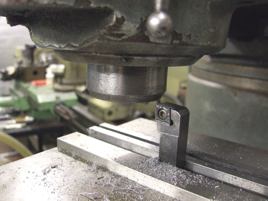

                        #113830
                        Anonymous
                          After a foul up at work today, on the part of the project manager, I found myself with a couple of hours to kill, so I decided to sort out the spindle nose on the Bridgeport mill.
                          First, I trammed the mill in X and Y. I don't seem to be able to achieve the miniscule figures that other people report, but I was happy with ±0.02mm over 200mm diameter in both X and Y. Next a test on the bottom of the R8 spindle confirmed that the nose was repeatably running out ±0.01mm. Using a carbide tool in the machine vice I skimmed the bottom of the spindle, like this:
                          After skimming the spindle runout barely moved the DTI, so around ±0.002mm? Using the Haimer Zero Master now gave an error of around ±0.015mm, as measured on the DRO, rotating the spindle round the four cardinal points relative to the first point. That is getting close to the limit of what I can measure, given that the resolution of my DRO is 0.005mm. The quoted accuracy of the Haimer is ±0.01mm so the results are probably as good as it is going to get, and more than adequate for my needs.
                          Regards,
                          Andrew
