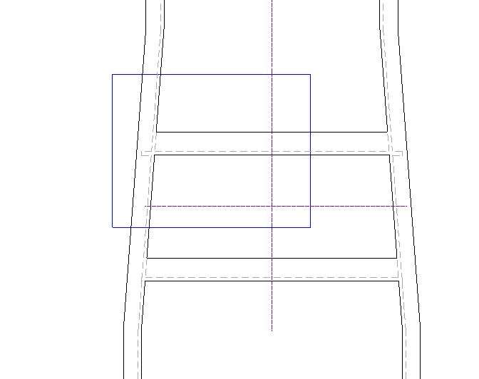

                Re printing on A4 you can set the scale of your part bigger than will fit within the blue eboundry of a A4 sheet and then move it about after printing the first position so you could end up with four A4 sheets each with a 1/4 of the  drawing on them that can be taped together. No different to how you may have used the works photocopier in the past.
                I did not save a drawing I used last week but will take a photo later to show what can be done for home use.

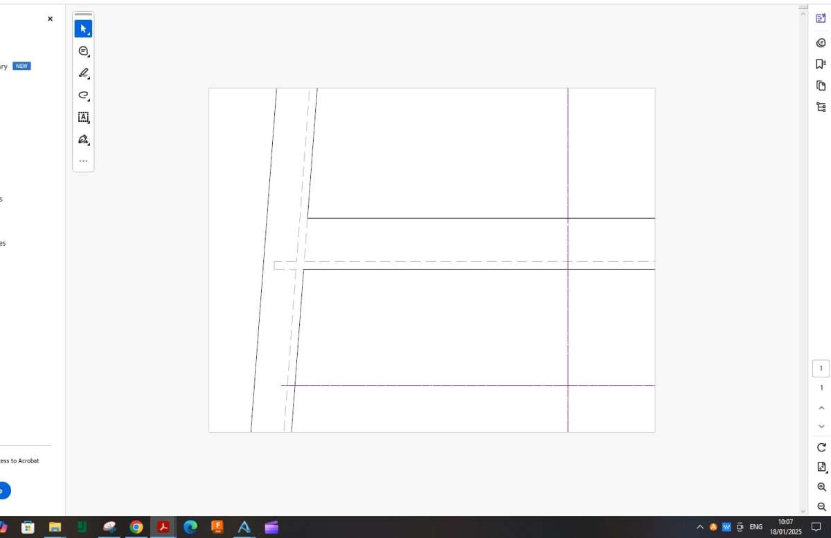

                    So here is an example of getting a large part onto a sheet or more.
                    This shows the base and capital details of some columns I was machining last week. If I had put the whole column on the A4 sheet I would have to have printed at 1:1 scale which would not have been ideal to see the dimensions on the mouldings. Could have done a detailed view in this case but for ease and what Nigel wants I just brought in the column twice and positioned them on the screen with just the bottom of one and the top of the other within the blue page boundary and printed. Think they are at 5:1
                    20250118_083806
                    For Nigel’s chassis the program will assess the size of the part and the paper size and automatically scale it to fit. This can be changed quite easily so I went from 1:19 to 1:1. As you can see most of it is outside the blue boundry which is the A4 sheet. But if that is printed and then the chassis dragged around until you have the 4 parts of the tapered  section all within the box one after the other you will then have the chassis on four sheets that can be taped together. Just like moving an A2 printed plan about on a A4 photocopier
                    On Screen in Alibre
                    jigsaw chassis
                    Printed to PDF in this case
                    jigsaw print
                    I did add the ctr lines to make taping them together more accurate.

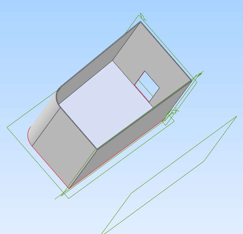

                          Well, I snuffled and sniffled my way through this like an asthmatic hedgehog chasing an athletic snail…
                          No, as far as I could find you can’t use line thickness in a 3D sense in Alibre but instead we have “Shell”, I was informed a little while ago. So I experimented and discovered a very useful but unexpected effect. I thought it would act like an through-extrusion, leaving rectangular-ish tube, but unless I missed something and stumbled on the correct choice by default, it will leave a box floor in place.

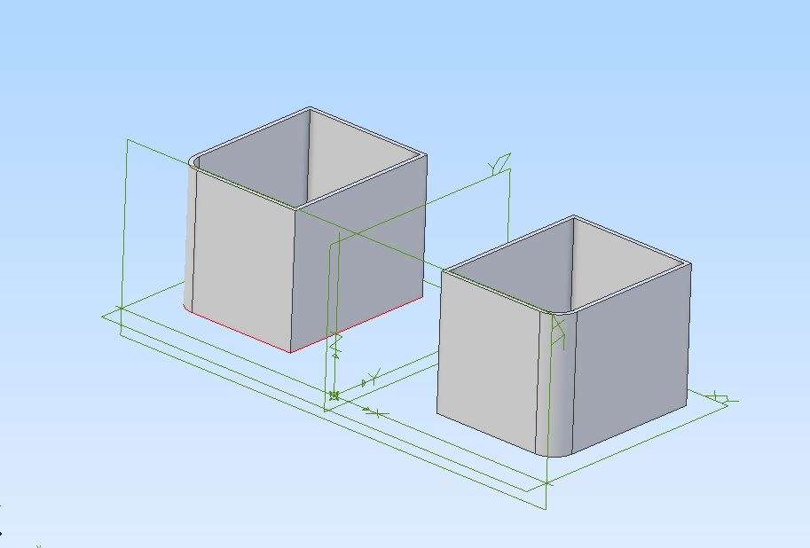

                          This is the off-side bunker for my wagon, the real thing long ago fabricated from 16swg steel sheet. I thought to draw the doorway sill very slightly high so the extrusion didn’t make a big ‘ole in the floor. In reality it is cut through the edge, and the vertical web of the internal angle joining wall to floor is cut away to create a shallow, chamfered threshold across the opening. I have omitted small details such as the angle-steel frame parts and a stiffening border to the door. (To bring the angle round that front curve, I cut a segment from a turned ring.)
                          That spare plane was to mirror the thing to create its twin but this raised two questions:
                          1) Shouldn’t it reflect the Shell cavity as well as the outer wall? It was happy to reflect the Extrusion but as a “solid” block, and didn’t want to accept the Shell into the details form.
                          2) If I mirror an object to reverse its orientation, or to create separate but handed Parts like these, can I delete the original? Or separate them from the single model to place just one, but either, of the two in an assembly? (I tried this with those chassis rail parts but the answer seemed to be “no” to both questions>)
                          I agree I could spend the time watching the rest of that video but I’d not be able to concentrate. This took me quite a while with a lot of tissue-hunting expeditions. Now, where’s that snail gone?

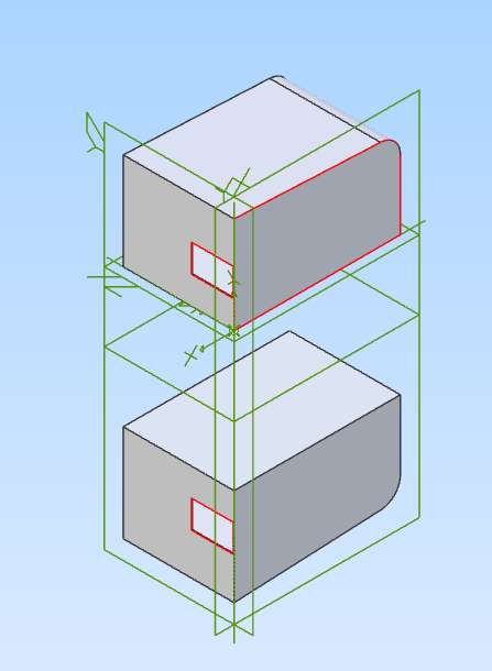

                            Probably be more successful if you mirror the sketch so you have the 2D of both bunkers. Extrude that sketch. Then when you go to shell click the top of each bunker.
                            An easy way to just get one half is to sketch a rectangle around the side you don’t want. Then cut extrude through all which will effectively hide that half. You can then “save as” bunker left. Then go back and edit the rectangle and just drag it over the other bunker, deactivate sketch, generate to last and then “save as” right bunker. This is what I do for pattern halves.

                              Nigel – If you’ve modelled half of the part as a solid, mirror that BEFORE using the Shell tool.  Apply Shell to the solid of the combined original and mirrored features.
                              The order of applying features is important and will change the final result.
                              When mirroring there are 2 different tools you can use – which will give different results.
                              Mirror – is used to select individual features to mirror and will leave the originals also in place.  Take care, it is the action of the tool that is mirrored, which may not always be exactly the same as mirroring the resulting solid.   (NOTE – in version 28, some extra options are added to this tool to give more versatility).
                              Scale/Mirror Part – this makes an ‘other handed’ copy of the entire part.  It does NOT leave the originals in place.
                              [EDIT – unlike Jason, I don’t recommend using Sketch mirror – I prefer mirroring features, because there is less in the sketch to edit if you have to tweak things later.  Jason isn’t wrong – we just have different preferred ways of working.]

                                  It won’t let me mirror the original sketch even after deleting everything else. Two actually: the main box and the one for the door.
                                  If I mirror the extrusion the reflection is a “solid” and the shell tool won’t work on it.

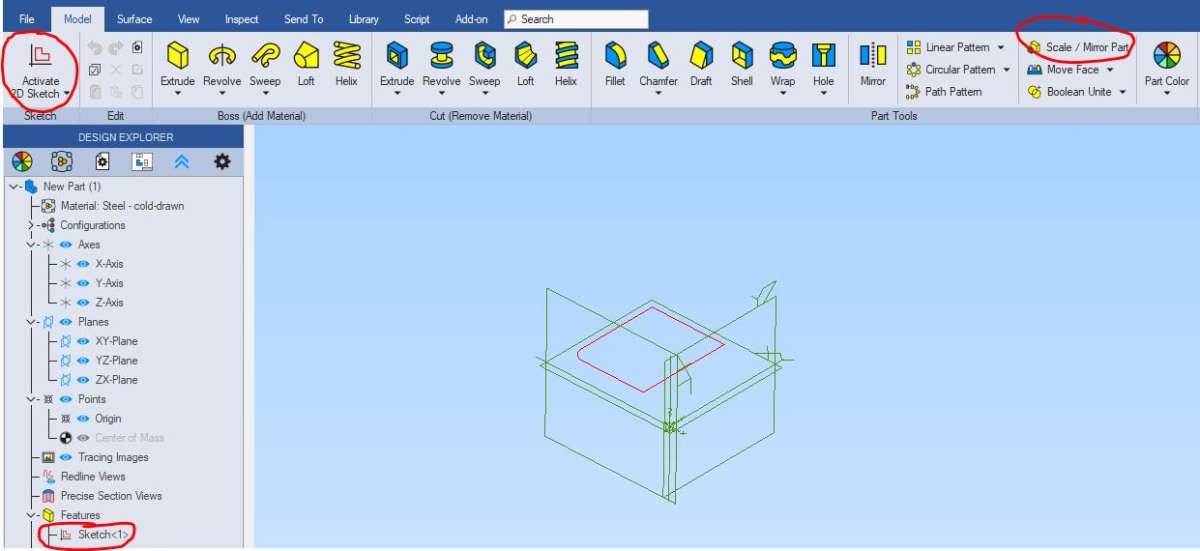

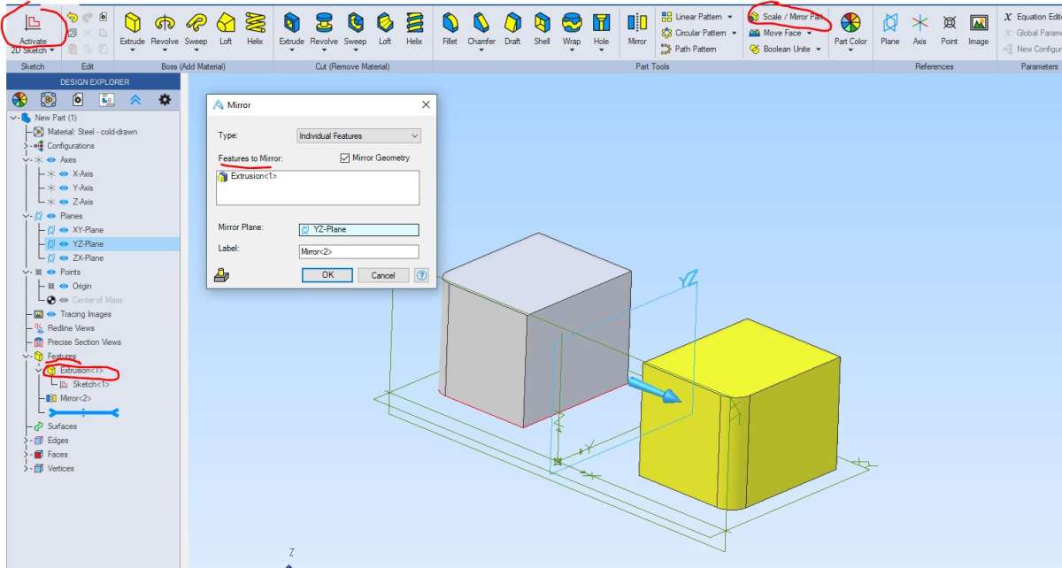

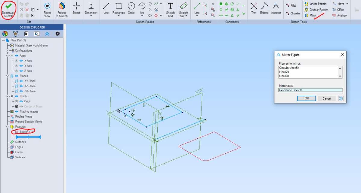

                                    #778299
                                      If you have deleted everying except the sketch then you can only us ethe mirror that comes up in 2D sketching not the feature mirror that David mentioned above.
                                      no mirror
                                      So you either need to activate 2D sketch and then you can mirror the sketch, then extrude.
                                      mirror sketch
                                      Or you need to do the extrude of the first sketch and then the feature mirror that David suggested will mirror the feature (extrusion) rather than the sketch
                                      featur mirror
                                      Finally use shell and click the tops of both solid bunkers
                                      shell
