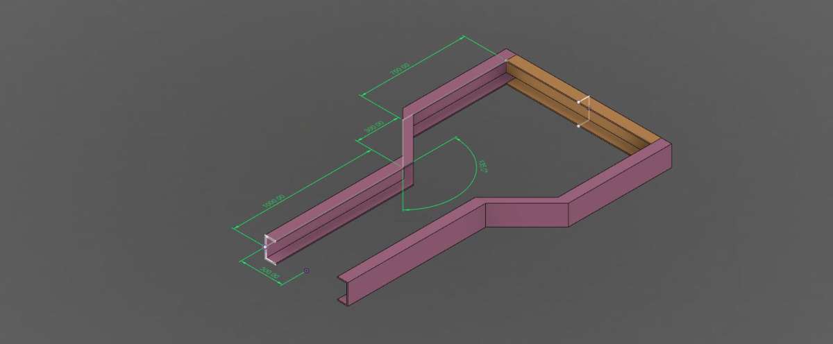

        Right I have got Nigels file and this is one way to proceed.
        Open the file
        Right click on the red “sweep” in the tree on the left and click delete.
        Right click “sketch 1” also in the tree on the left.
        Now your icons are a bit different to mine but you should have similar. First click “select all” which will make everything on the 2D sketch go blue.
        Then click “copy”
        Then Click “Deactivate Sketch”
        Click ignor to the warning.
        Now click the “ZX Plane” probably easiest from the list on the left
        Click activate 2D sketch
        Click “paste” and that will put the sketch you just copied onto the screen
        Click “deactivate sketch”
        Now you can do the sweep by Clicking the “sweep” tab at the top
        It may well automatically put sketch two in the “sketch to sweep box” if not click that box and then the sketch either from list or screen
        Click the path box and again select what is now “Sketch 3” from list or screen
        If all is well you will then have your chassis so click OK at the bottom of the sweep box.
        Video is just uploading
        Another option would be to just delete the red “sweep” , select ZX plane and redraw the guide lines then use that in a new sweep.

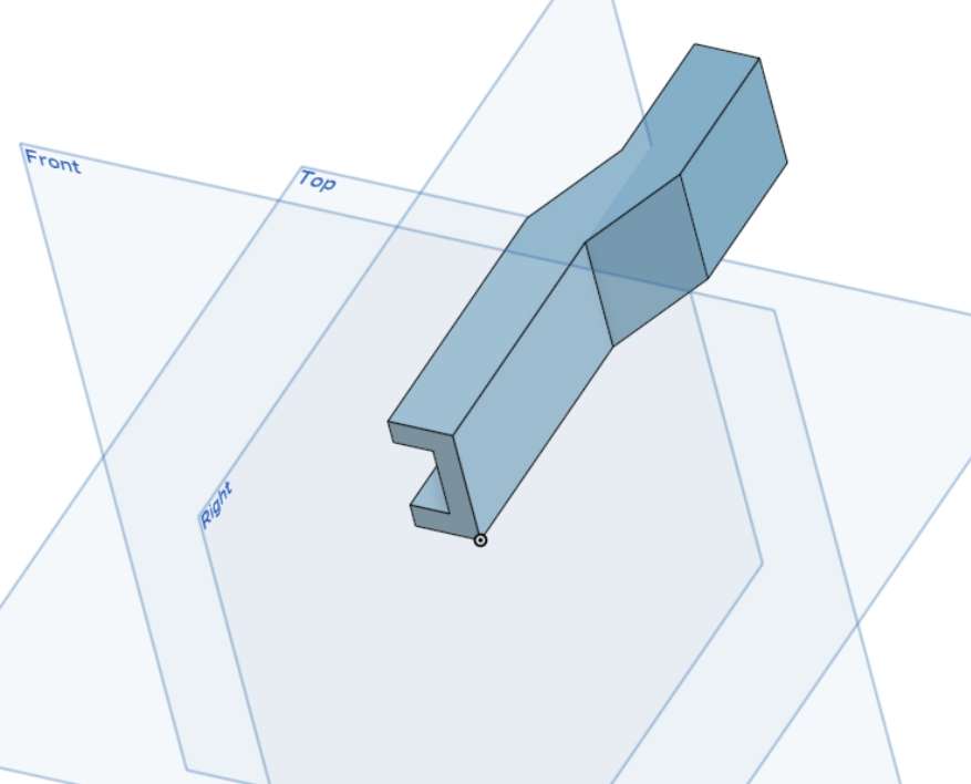

              Any demonstration or exercise should be designed to work first time; so while the sweep is possible when they don’t touch, it’s more likely to do what you expect if they do. Especially when the path has been deliberately offset from what will become the chassis centre line so that the opposite rail can be mirrored from the first. That’s not advanced but a basic technique that ought to be learnt from the start to save time, effort, thinking and potential cockups.
              I turn off the visibility of planes, grid and axes(and any snaps to them) because they’re only useful when beginning a sketch; once it’s started it’s more helpful to think about top, bottom, sides, centre etc of the object instead of abstract construction geometry.

                So following on from that I’m sure Nigel and everyone else spotted that the sweep does not actually follow the guide which was the correct 6″ from ctr line at the front and 7.25″ at the rear. So lets correct that.
                Right click “sketch 2” and select “edit”
                As you had copied the C section it comes without dimensions so rather add them for overall width and the thickness of the web. Then when you enter half chassis width of 6″ from the centre line the whole thing will move.
                Deactivate sketch and the swept profile is now in th eright place.
                Generate to last and save.

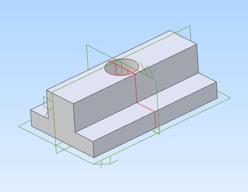

                    As some relief from that channel problem I drew this Tee-nut, and yes its proportions are rather unusual because it is for a real purpose: to fit a boring-table for my Harrison lathe. That was made by its former owner, and he must have used those slot sizes for a reason. I bought it via a sales advertisement on this forum.
                    Apart from wanting a set for its future use anyway, I am considering whether to machine it out to accommodate the compound slide as on the standard cross-slide, so giving an equivalent to the smaller Myford arrangement. So by suitable Tee-nuts first I can clamp it to the faceplate, it having no through-holes.
                    The weather is slightly warmer today so I spent a happy hour or so in the workshop this morning, measuring and experimenting with tool-holders etc. It is higher than the normal cross-slide so I’ve to consider tool choice and setting.
                    As far as using Alibre goes it was really an exercise in making these constraints work, though its sketches were never fully-defined. On the first go I’d made the upstand too narrow (typing error), and I took several attempts to realise it would work by producing the replacement sketch on the central plane, not end face. Unless I could have used the face with a different extrusion choice.

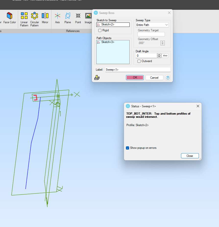

                        I still can’t get it.
                        I’ll just have to accept I can’t use the Sweep tool.
                        After several attempts I appear to have the two figures on the right planes, I think, with the section even facing the right way, but that’s far as I can go. I still don’t really know what I did, though.
                        I’m not helped by the error messages being ones only the experts would understand, but the experts never do anything to make such things appear anyway:

                                  Well the error message didn’t obviously coincide with the most common errors people make with sweep, though I can’t rule those out.
                                  I also note that there was, or had been, at least one more sketch in the file.  I can’t be sure the correct sketches have been selected for the sweep.
                                  The most common problems seen with sweep are;
                                  • The path includes a radius too small for the profile to be traversed along the path – think like a hose that is kinked.
                                  • The path doesn’t reach the plane that the profile sketch is on.
                                  • The user has mistakenly specified the path sketch as the profile and vice versa.
                                  • The path sketch includes overlapping or intersecting figures.
                                  I can’t rule out other issues, in the file.
                                  I’ve asked repeatedly that Nigel saves files when he hits problems, and sends them to me for analysis.  So far Nigel hasn’t done that.  Without evidence from the files, there’s a limit to how helpful I can be.
                                  Error messages often originate from the ACIS modelling kernel, and yes those can be cryptic, often because they describe a generic issue in mathematical/geometric terms rather than relating to the specific case that the user is attempting.

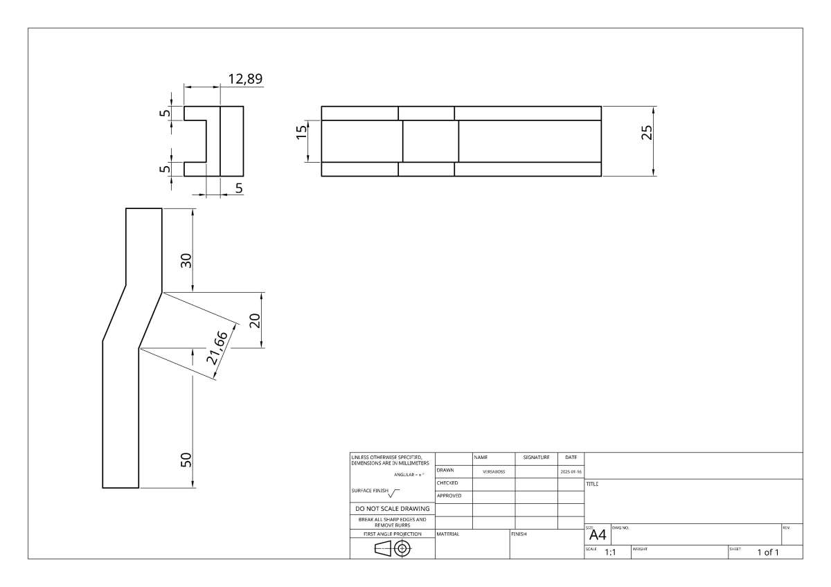

                                  #777815
                                  lekmir
                                    @lekmir
                                    I’m shaking my head in disbelief, so I spent 5 minutes with my beloved Onshape and created something resembling Graham’s channel. Then another couple of minutes to obtain the “workshop drawing” so desperately needed by Nigel, and adorned it with some dimensions.
                                    But no one can be forced to his luck (not sure if that saying is used in England)
                                    Regards,
                                    Hans
                                    GrahamTest
                                    GrahamTestDrawing

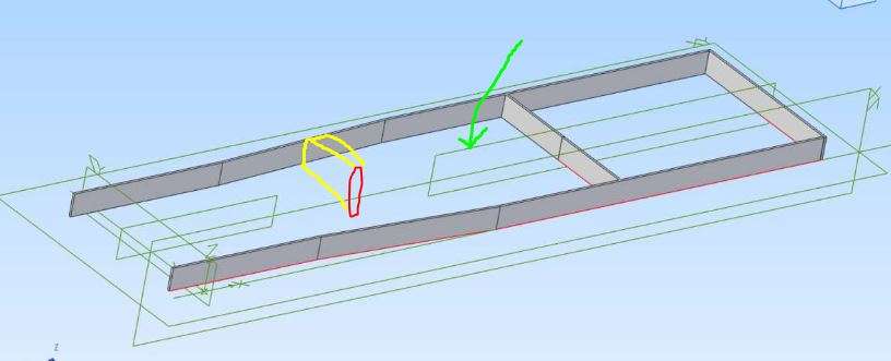

                                    #777823
                                    Nigel Graham 2
                                      @nigelgraham2
                                      Edited because a bit of cross-posting went on there.
                                      I didn’t delete the file deliberately, but simply forgot when I closed it.

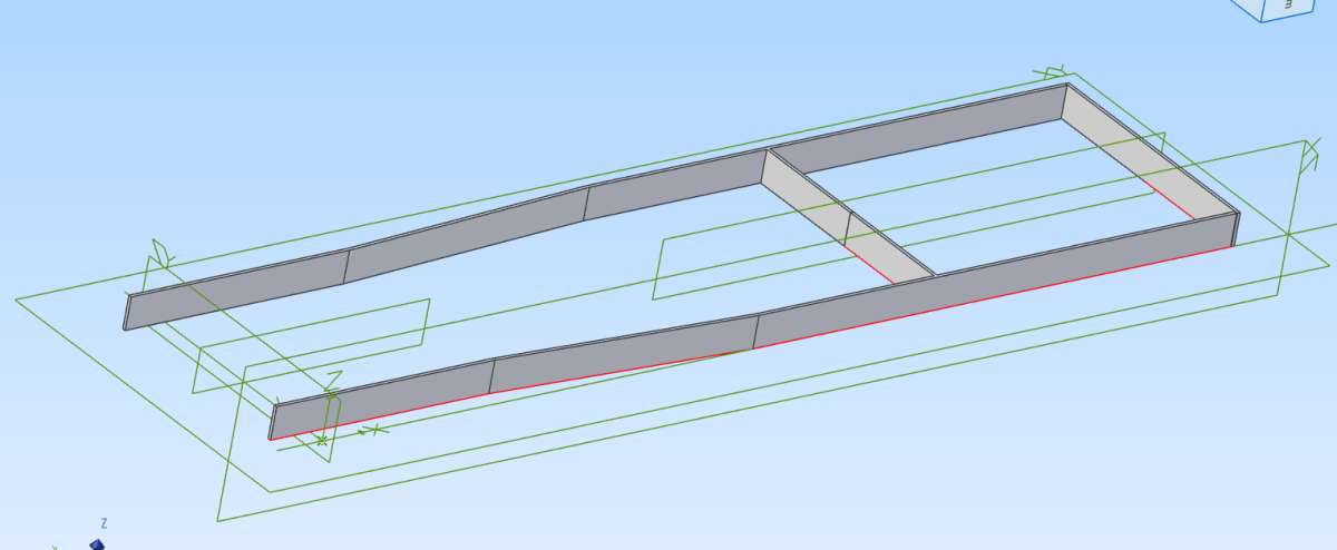

                                      Meanwhile I tried once again creating the chassis rail from the three Part files of separate sections of modelled channel, but that Assembly is even harder than this Sweep method I can’t understand.
                                      I experimented with another possible way, but although that failed as well it showed I could represent the frame by just the vertical webs, omitting the flanges. So that’s what I’ve done.
                                      No of course it’s not realistic but it’s obvious by now this is the only way I can model a frame like this in 3D. The internal dimensions are the ones that matter anyway. Most major components are bolted to the flanges but I expect they’ll be happy screwed to thin air. I can show only their very basic outlines or even just envelopes anyway, certainly no details, here. I’d have to add them to this drawing, if it will let me, as if all one “Part”, not as an Assembly from separate drawings.
                                      Ideally the XY plane should be on top of the webs, not their undersides, because most of the rest of the components are on top of the channels.
                                      There are two other cross-members to fit in there, on that tapering section, but I need verify my measurements. Screenshot 2025-01-16 225150
                                      #777845
                                        You should only need the lengthways position of that cross member.
                                        Select one of those extra central planes you have added, sketch the cross section of the crossmember not the top. and then extrude “to geometry”. This will give you half of it which can then be mirrored about the same plane.
                                        cross member

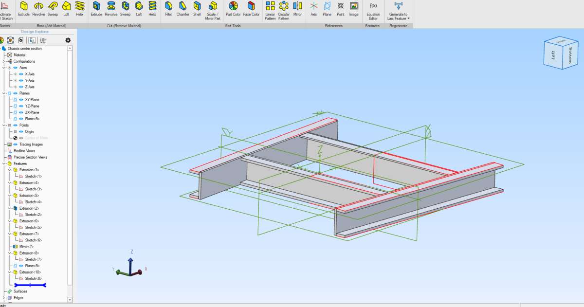

                                                    Anyway… I think some two hours later, nearly a dozen sketches and dozens of Faulty Sketch error-messages that don’t indicate which Degenerate Open Loops are Overlapping which Intersections, I finally modelled the frame’s central section as a single part to resemble something like intended. The rearward cross-member is right: it is angle, not channel.
                                                    I’d have needed fewer extrusions if I’d not forgotten the outside flanges until after I’d mirrored the first nearly-half. I did though speed up production by plotting and extruding the upper ones “accurately” then turning the thing over and simply tracing their images to make the lower ones. It didn’t occur to me until typing this I could have mirrored them but as I’d have needed create an equatorial plane for them, it would not have been much less work.
                                                    Still, though it’s rough it does at least resemble the real metalwork and is to size in the right places. Hopefully. Is it possible to add the webs and flanges then a little fillet to give a more life-like appearance?

                                                      Looks like you have the webs and flanges so not sure what you want to add there.
                                                      Fillets are quite easy. make sure you have saved what you have got then along the top you have the “fillet” tool so click that. It comes up with the default fillet radius highlighted which you will probably need to change from 0.5″
                                                      Then click in the larger box “entities to fillet” so that gets highlighted
                                                      You can now click any internal corner on the 3D part and that should immediately show a yellow fillet, keep clicking the ones you want then say OK. Sometimes if there are a lot it is worth doing a few batches rather than all at once.
                                                      The same procedure if you want to round over an external corner eg if you channel is bent from flat.
                                                      Be careful not to click a face as that will both round any external edges and fillet any internal. If you do locate it in the entities box and delete just that item
                                                      You should not have too many problems with what you have there, sometimes filleting odd junctions like a cylinder meeting an ellipse can throw a bit of a wobbly.
