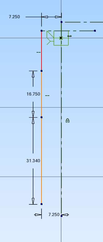

          Well, Jason, I thought I’d better try what you suggested. This is as far as I managed:
          The lowest line is where it should be. (I used the dimensions from my sketch of the real thing but that shouldn’t affect it.)
          The top one is stuck on that 7.25″ distance. I typed in its correct distance from centre (6″ ) but it wouldn’t move. I deleted it, drew a new line, tried moving it. No. It stays stuck to the rest of the formation.
          The image is of that first attempt. I tried again this time deleting the bottom line. That made the two top ones obligingly move to the intended 6″ distance as if that was stored for use.
          So tried to add the lowest line and that behaved as above: stayed stuck in line with the others.
          Went back to your instructions to see if I’d missed something, but if I have I could not see what.
          Tried once again this time deleting the middle, angled line. I could then draw it back in but of course it is slightly longer than it should be because I’d not adjusted the others to the correct overall length. Probably not significant here but it might be on something else.

            It looks to be down to how you placed the three lines initially. If you look at the middle and top lines there is a green — constraint next to them which is the co-linear constraint which puts them in line with each other.
            If you start by just doing three undimensioned lines starting with the bottom one and letting it snap to vertical, mid one at any angle and then the top one again let it snap to vertical. Then dimension their vertical lengths and then the offset from the mid line you may do better.
            Also looks like you did not start the first line the horizontal axis line, though that is not critical

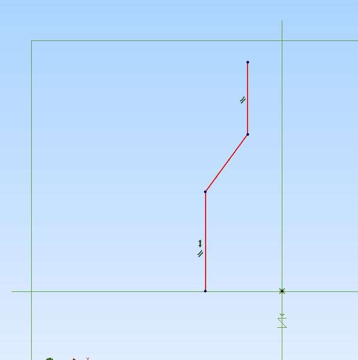

            #777313
              Should be like this when you place the three basic lines
              chassis start

                Nigel Graham 2
                  @nigelgraham2
                  No – still can’t see what I’m supposed to do where and how.
                  I managed to create the dog-legged line, then when I tried the next bit saw only a blue box on the grid. What’s that supposed to be?
                  Developed the C-shape, couldn’t make the Symmetry constraint work – deleted the complete figure and drew it again, now by dimensioning it equally about the centre-line.
                  Is a closed figure actually that or a set of individual lines? They seem to behave as the latter.
                  Then couldn’t see what to dimension it from (as with the [600/2] value in your example), and which way. The only visible lines on the screen were the grid. I decided I must have gone wrong by drawing the back of the C on the axis, so copied it sideways from that by the supposedly right distance and deleted the original.
                  Then what? Where is the guide-line? I kept raising an error called a “Top-Bot-Conflict”, or similar, meaning or explaining nothing to me.  So tweaked the view to see what the heck I’d generated…
                  I’d generated complete rubbish: totally wrong orientation, totally wrong place, planes all haywire….

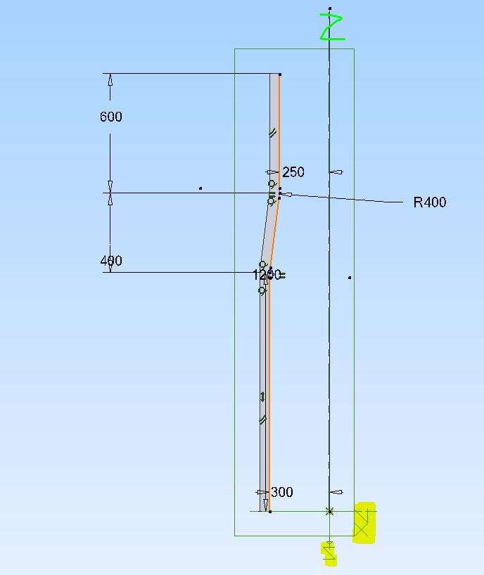

                      Just noticed my text did not match what I had highlighted in those instructions back on page 5 or showed in the video. Should say
                      Select the ZX plane on the tree down the left of the screen and click “activate 2D Sketch”. The axis and plane swill move on the screen but the orientation is looking at the top of the chassis, rear at the bottom of the screen, front at the top.
                      Don’t start again. Open the file right click sketch 1 from the list down the left and then select delete. Now follow the instructions and click ZX plane, activate 2D and draw the guide lines. Your C section should be OK.
                      Otherwise it looks like you are doing OK, You have the guide line and you have the C section.
                      A closed feature is made up of lines but the last line needs to meet the first to close it. That is why the guide lines you draw first give the warning as they don’t join up at teh ends.

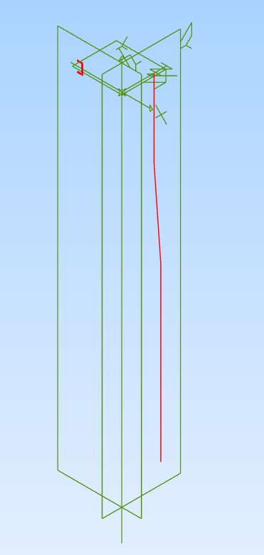

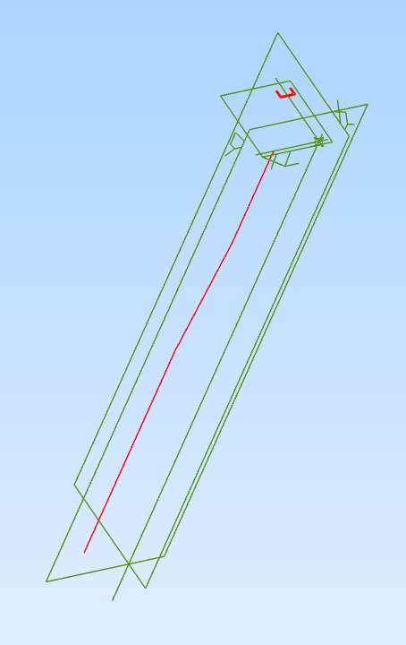

                                Nigel Graham 2
                                  @nigelgraham2
                                  Sorry, Jason & Dave –
                                  It still went to rats.
                                  Delete Sketch 1… From the list or the drawing? Not from the list. I could select it but the whole menu that includes ‘Delete’ was off (light grey).
                                  Copy Sketch Two…. I can’t see how you do that.
                                  I think I accidentally deleted the wrong sketch, but anyway when you go from the first to the second and the planes rotate, what are only lines disappear into the axis lines, possibly somewhere where they cross a large green square that appears on the screen but indicates nothing.
                                  I drew that ‘C’ shape yet again, because the first was lost, but I can’t make that Symmetry constraint work so have to dimension things like that from the axis. At least I found a slightly quicker way to draw it.
                                  Then what? What is that dimension you give for it (300mm in your example) between?
                                  Back in 3D mode, the two new sketches are there but nowhere near each other and the section profile faces the wrong way. Just like the first time.
                                  I thought I was making some progress forwards a few weeks ago. I still am but now the wrong way, in full reverse gear. I honestly thought that beam in 3D would be far simpler than that cylinder-block. It isn’t. A single straight piece of channel is, but those bends make it too hard for me.

                                  Screenshot 2025-01-15 201812

                                            Nigel. Looks like you have drawn on the wrong planes.
                                            As per my correction yesterday you want the Guide lines on the ZX plane you look to have it on YZ and the 300mm is from the Z axis
                                            ZX
                                            You also have the C section on the ZX plane when it should be on XY
                                            If you doas  my instructions the two sketches will be in the correct place. This is why your screen shots have the chassis stood on end and mine is flat as it should be.
                                            If you are not quite sure where you are placing a sketch then while in 2D sketching you can either hold down both mouse buttons then move the mouse and get a 3D view which will allow you to see the first sketch. Or click the different view icons of the cube top right.
                                            Send Me and David the file and we can put your sketche sonto th eright planes then you can look at them on your own screen. I’ll PM my email again.

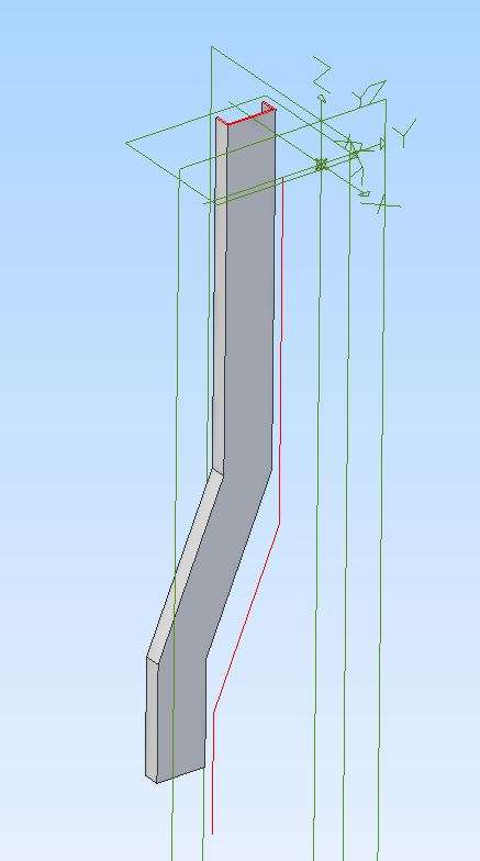

                                                  #777624
                                                    As David says, what you have will stil sweep but not in the way you want, you are getting close.
                                                    This would likely be the result of sweeping what you have
                                                    N sweep
