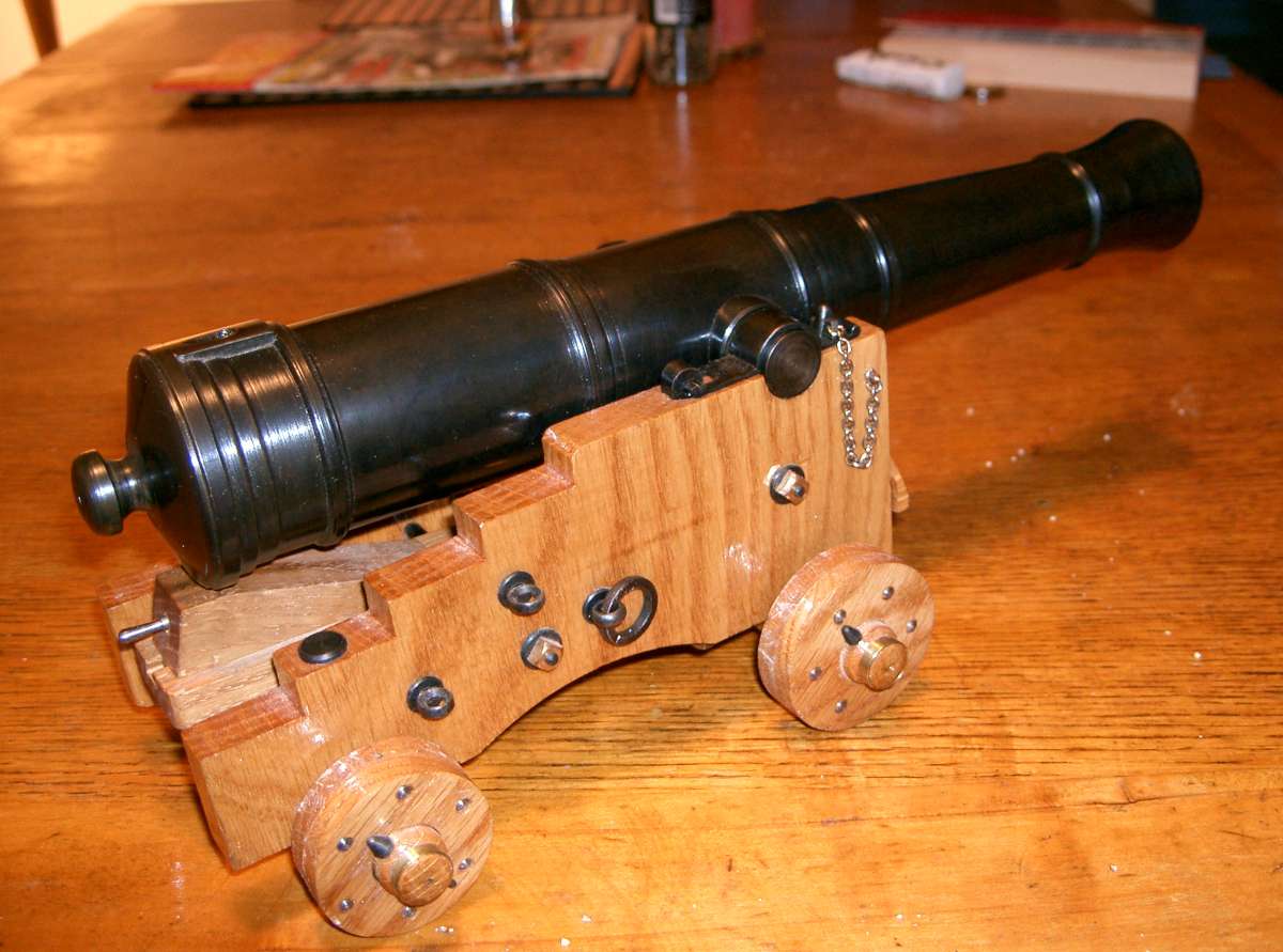

                        #697660
                        Mick B1
                          @mickb1
                          I’ve had good results with G96 on several guns back in the day. They call it a ‘creme’, but I’d just say it’s a paste.
                          I degreased the parts as best I could with meths, washed them in very hot, strong washing-up water and painted the stuff on with brush while the metal was still hot. Then wash again with fresh hot water to get the chemical off, let it dry and cool. Finally oil up. Even olive oil can work well.
                          The pic’s 20 years old, but it still looks the same today.
