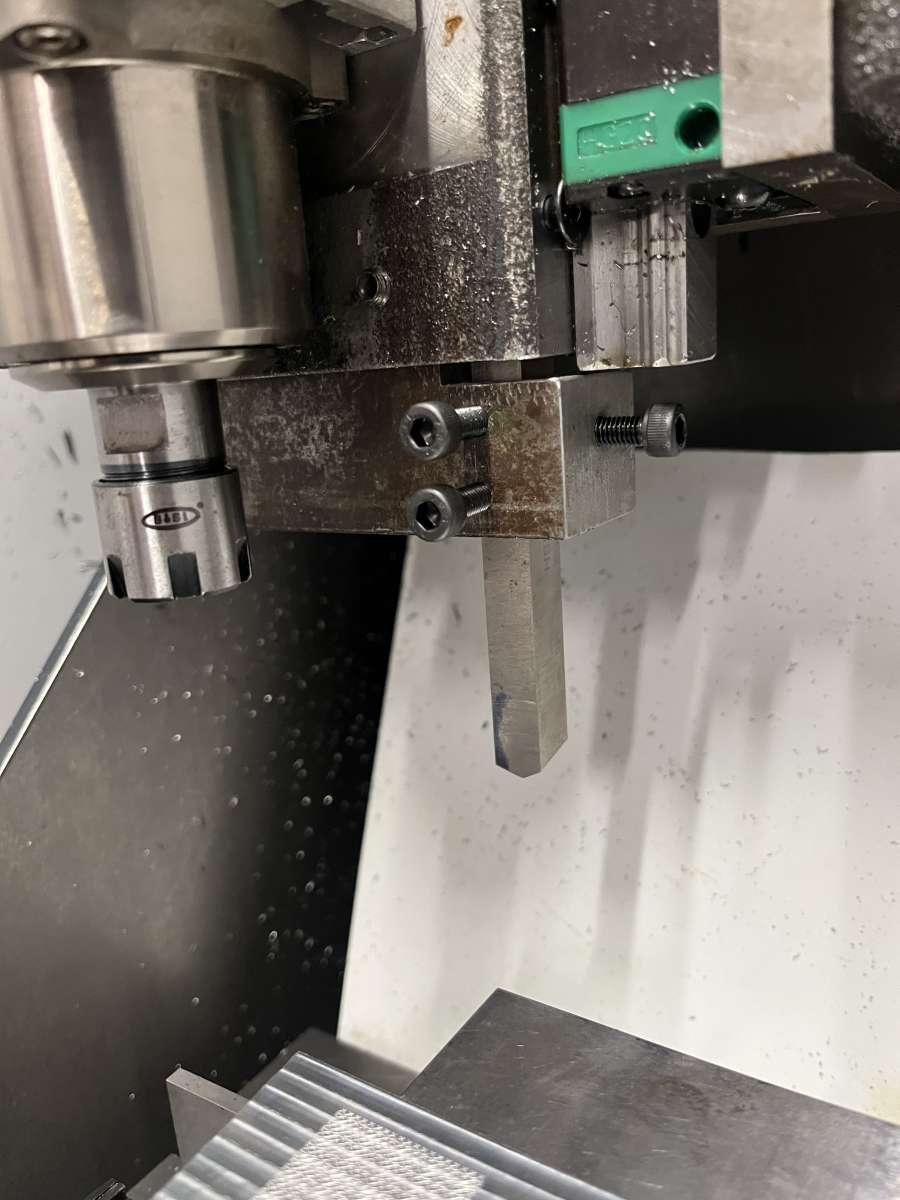

      So first order of work – how to hold an engraving tool?
      My spindle doesn’t have a lock, so I knocked up a tool holder and attached it to the Z axis.

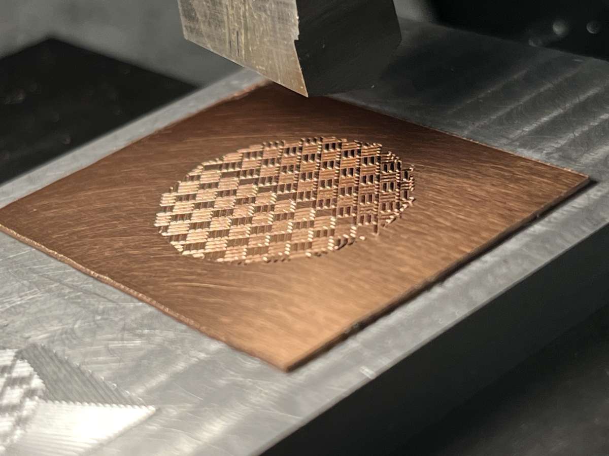

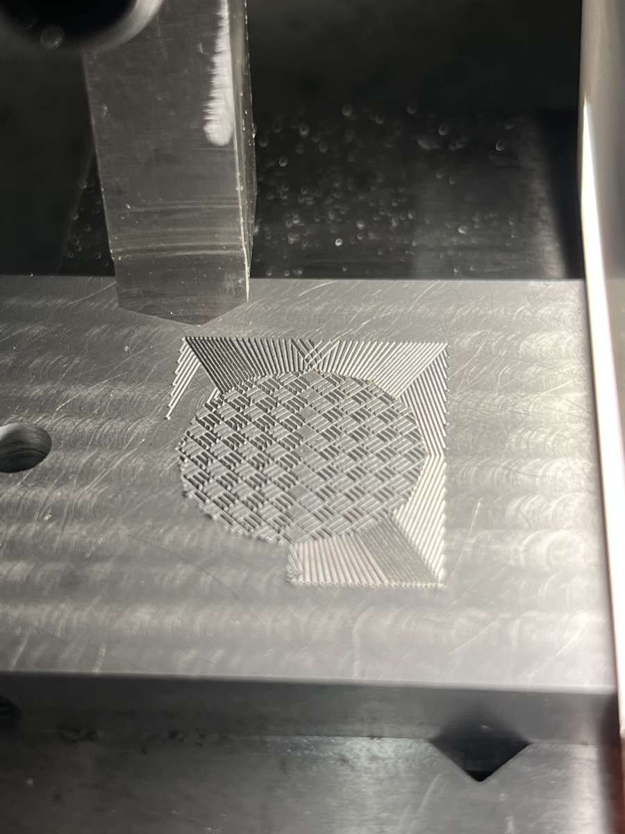

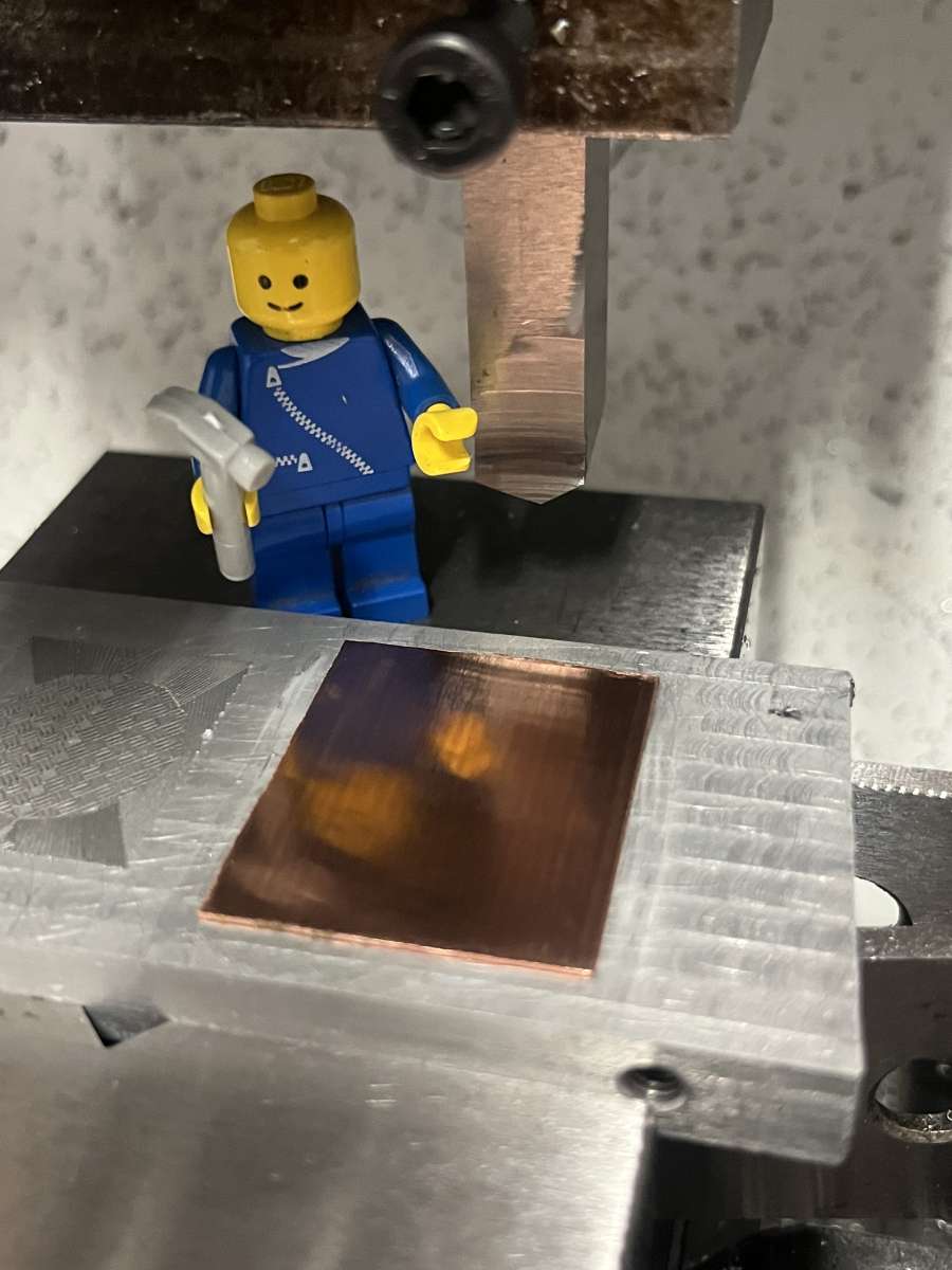

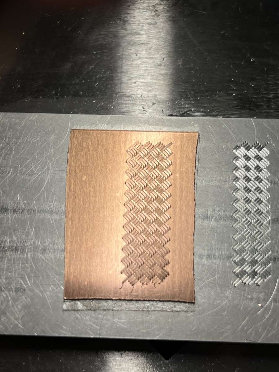

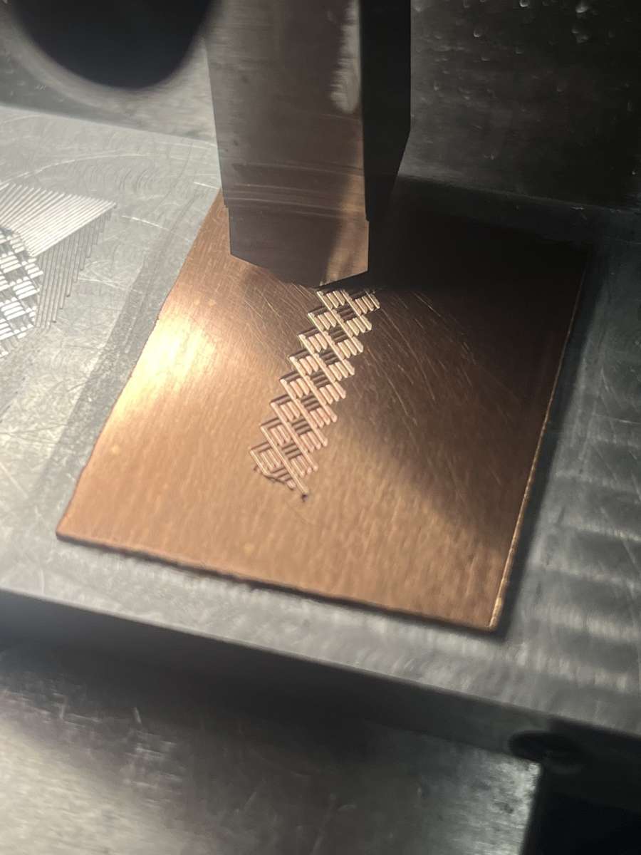

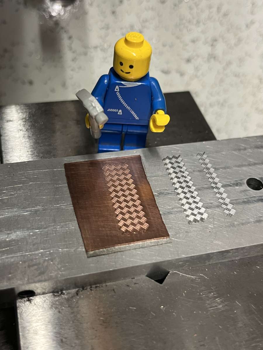

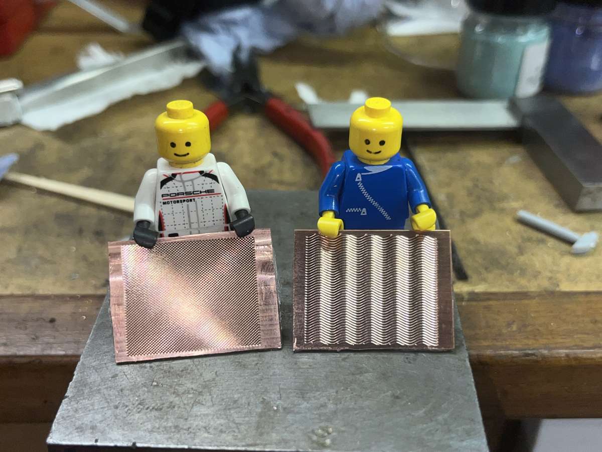

      Test cut in aluminium, followed by a test on copper:
      IMG_8612
      Looks like Lego chequer plate
      IMG_8613
      Basics sorted, definitely possible with my tools 🙂

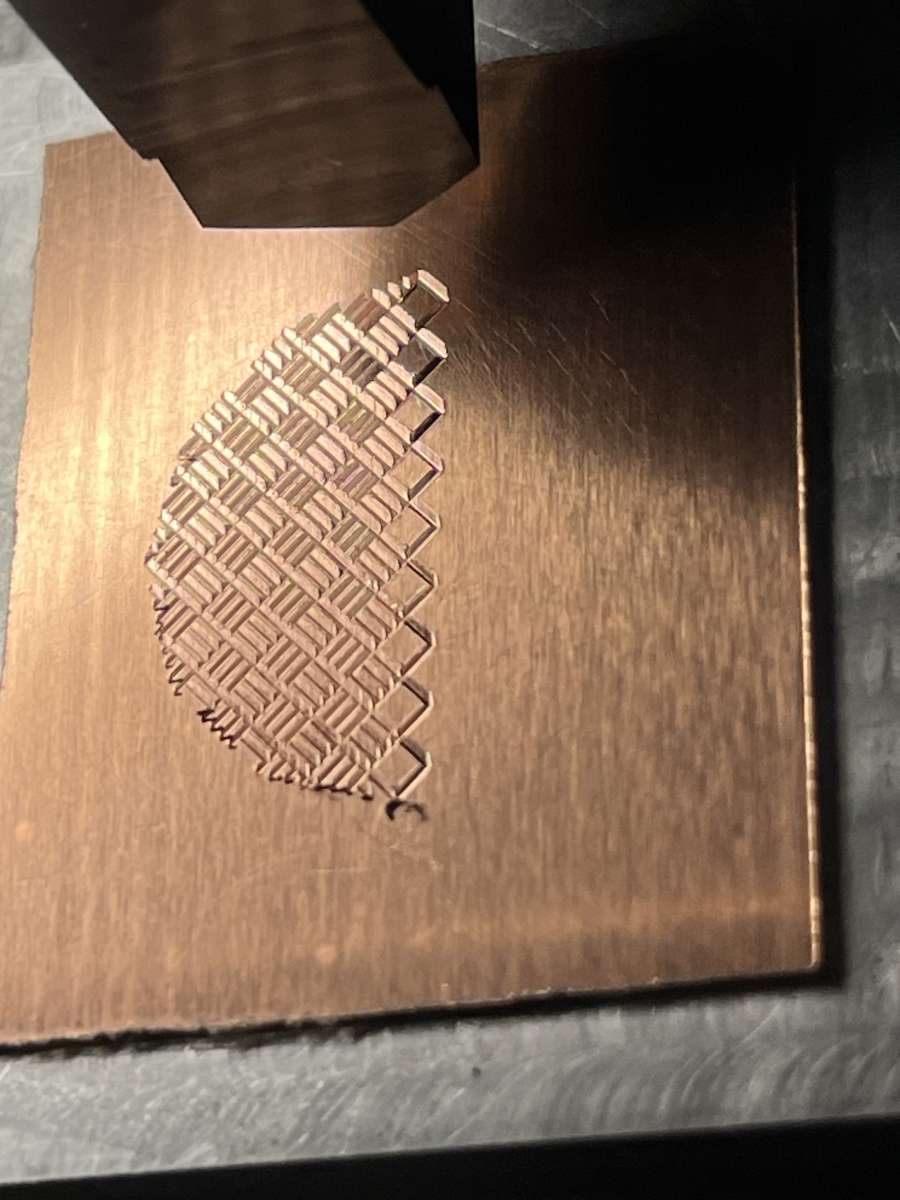

      Then set the machine running:
      IMG_8654
      halfway through the basket weave centre:
      IMG_8656
      Basket weave done:
      IMG_8659

              Very nice! Do I understand correctly that the tool always points the same way (Y-axis parallel by the look of it) while the work moves in straight lines at various angles?  So the width of the groove changes according to the angle?

                          Yes the tool is Y axis oriented, so there must be some line width variation. I decided that the way a straight line engine works for a lot of patterns is like that, so thought I’d try and see.
                          Seems to work ok upto about 45 degrees off axis. Not shown is all the testing I did, and in amongst that are steeper angles, where the line width is very noticeable, and of course at 90 degrees you are dragging the tool side along.
                          I am wondering about a rotary stage to align the tool to the angle, but I don’t think it’s worth the extra complexity for the patterns I currently want to make.
