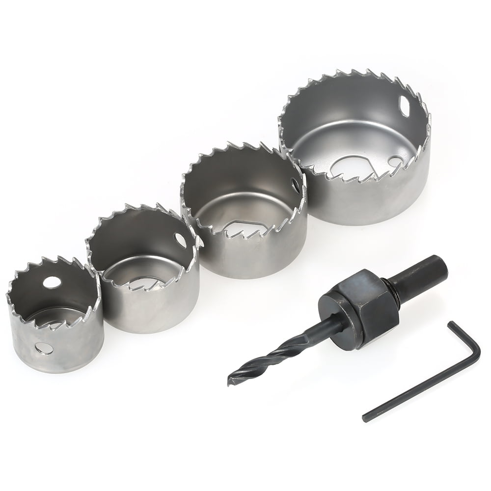

      What would be a good profile to grind the cutting tool on one of these, for cutting thin metal sheet ?

        Much like they have it there will work particularly if very thin. Or you can go for a blunter end more like a parting tool but just watch that the outer edge has enough clearance to stop it rubbing on the outer edge of the cut
        #691917
        DC31k
          @dc31k
          As shown, the ‘point’ is on the outside of the tool, so the edge of the hole will be of reasonable finish, with the centre circle discarded.
          Should it be the case that you need the circle as a finished item (e.g. you wanted to cut a washer out of your sheet), then having the point on the inside will give a better finish on the OD of the washer.
          it will assist if you can sandwich the metal sheet between two sheets of plywood and clamp them well. Clearly you need to cut a clearance hole in the upper sheet first.

            Standard practice I learned was to grind a broad, shallow radius across the front face of a trepanning tool, in order to divert the chip inwards to reduce risk of trapping and binding. The vee point shown can also do that, but will leave a tapered edge to the both workpieces.
            Whether or not that matters depends on the purpose.

              The larger holes needed to accommodate meters and a loudspeaker, were usually made with a Tank Cutter as illustrated by Rich.  These were invented so that Victorian plumbers could cut holes in the galvanised iron water tanks installed in lofts and ceiling height lavatory tanks.  (Do any still exist?)
              The cutter was held in a gut-buster hand drill – no motor – and turned relatively slowly with heavy pressure against the metal, which usually had to be supported at the back.   My experience with them wasn’t good!  Thin steel sheet and the soft Aluminium alloy used to make radio chassis both tend to distort and tear.   Never tried one on a galvanised water tank, but I suspect these are tough enough to resist tearing.   They work OK on plastic water tanks.
              No forum advice available on tank-cutting when I needed it in the good old days, and it’s possible I was doing it wrong!   Am I right in thinking tank-cutters are best avoided, or should I try again?  Nowadays I reach for a hole-saw or step drill and my tank cutter has only been used twice this century (on plastic tanks).

                Avoid the tank-cutter if better is available – but that’s true of many tools. It does at least have the advantage that you can set it to the radius you need.
                There is or was an alternative form of the cone-drill you illustrate, being a smooth cone instead of stepped, but I have not seen one either in the steel or listed anywhere for a long time. Are they still made?
