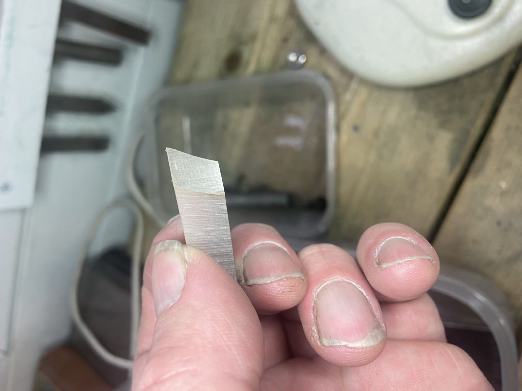

      After my last thread on finish I realised that I’m going to need to grind lathe tool bits. I got hold of some 20cm 10mm HSS blanks. The first thing I realised is that HSS is really hard. My hacksaw basically bounced off. So I cut it with a diamond blade on my angle grinder, but it still took ages and overheated the steel. Any tips for cutting HSS?!

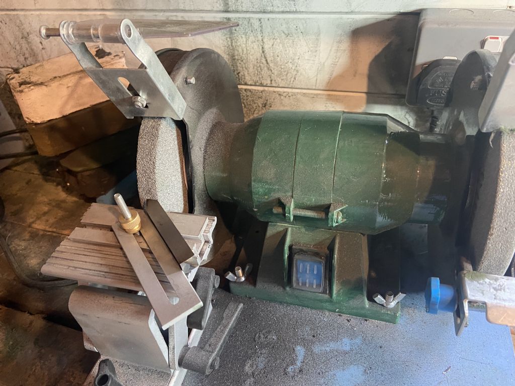

      At the grinder, I am lucky in that I already have an adjustable tool rest with an angle fence (used for plane and chisel blades usually). The problems I’m experiencing are:
      1) It takes ages. HSS seems to be much harder than plane blades.
      2) when grinding a plane blade, of course the grinding wheel leaves a small amount of curvature. But I just hone this off on the sharpening stone, through several levels of grit and then strop it for a “scary sharp” finish. But on the lathe bit, the area I’d need to hone is much bigger, and I don’t have a nice sharpening jig to keep it perfectly flat against the stone.
      The result is a curved point (see pic). It isn’t possible to grind a consistent and small radius on this. The radius either ends up as “triangles” at either end of the cutting point, or a larger “saddle” shaped radius across the whole point.
      I’ve watched a few YouTube vids but none I’ve seen properly address this.
      I could get a bigger grinder, which would reduce (but not eliminate) the problem.
      I could get a belt grinder with a circular sanding disc on the side, but I’m not sure they will be man enough for HSS.
      Most likely thing is I am doing this wrong!
      Any tips ?
      thanks
      Steve

                  Might I suggest that you invest in a double ended grinder – they are not that expensive and will be better than an angle grinder. And they do have, as a rule, both a coarse and a fine grinding wheel – use the coarse for initial shaping and the fine for the final shaping. FWIW, I used a diamond disk on some HSS – never again, as I think I've damaged the diamond!. Also, although there will be adverse comments about this, some authorities recommend grinding on the side of the wheel in order to achieve a flat surface – whan all said and done, you will not need high pressure, indeed, a light pressure will achieve a smoother surface of the HSS.

                        Your picture looks like a nicely ground bit for a Diamond tool holder! Try clicking on the Eccentric Engineering link on the right. These are very good, you can make your own "tangential" toolholder, you only need to grind one angle on the tool, easy to hone, and give a good finish. The hollow-ground face is not a problem.

                                  You really need to get a general workshop book that just covers the basics.
                                  If you check whats written on a good hacksaw blade, you'll read bimetal + the tooth count that means the teeth are HSS and HSS wont cut HSS.
                                  Wood likes a scary sharp blade, but metal will smash the edge quickly if you use the same angles.
                                  Removing the hollow ground effect is a waste of both money and your time and you don't need the double edge look on a metal cutting blade either. Leaving the hollow on a wood blade means the oil stone is usable a lot longer before you need to grind again.
                                  You just rotate the edge of the blank as you lightly touch it on the fine wheel. Touch up with a hand held stone to keep the edge as and when needed.
                                  By all means use an coarse disc on the angle grinder to rough shape a tool

                                      What you showed in the first picture is what you get when you grind for a Tangential turning tool, (marketed by Eccentric Engineering as the Diamond Turrning Tool
                                      Most bench grinders come with medium and coarse carborundum wheels, which are quite suitable for grinding HSS.

                                                The curvature on the front face of the tool won't cause any problem. In fact it can be an advantage as you only need to hone the top and bottom of the front face so much quicker.
