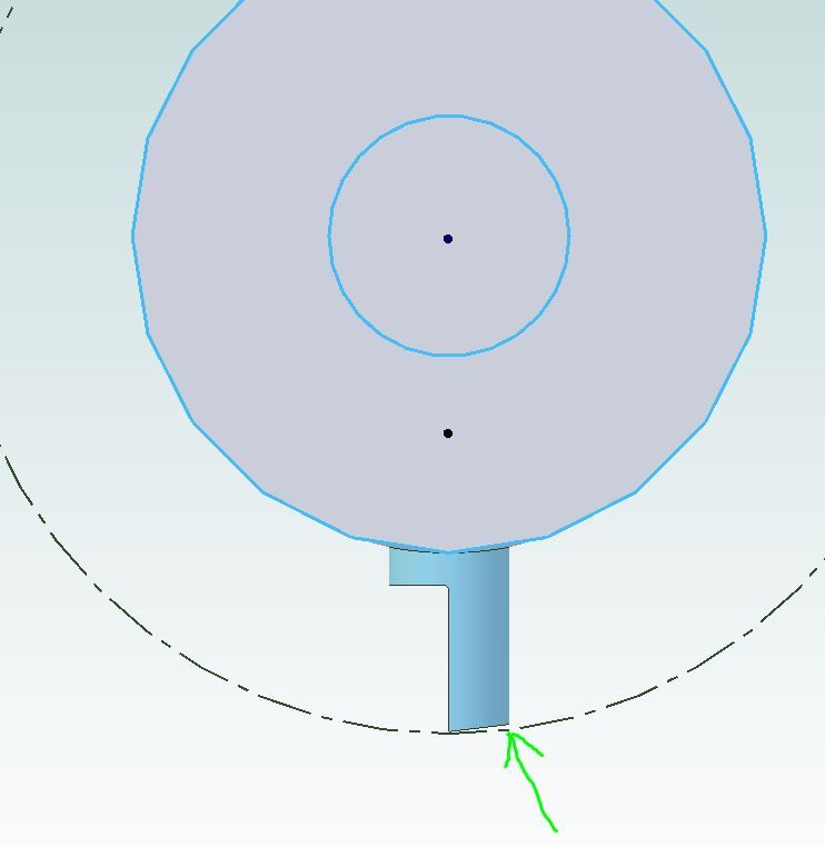

      The tool is based on this image, however the tool in the image is for cutting an angled valve seat. The tool I am making is for cutting a reference cut in the valve seat area for lowering the chamber floor (or more accurately, raising the chamber roof). So instead of a radiused cutting tip the cutting tip will be flat.

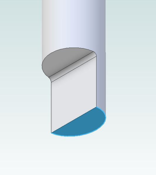

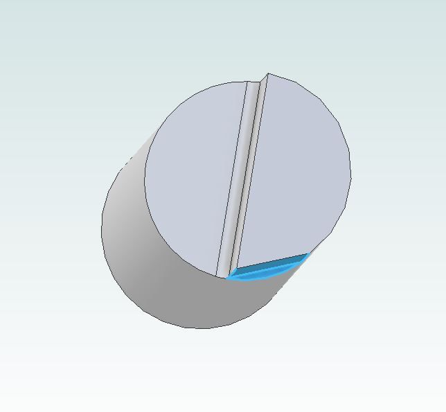

      In the image below, this is what I believe the tool tip will need to look like, to achieve the recessed cut around the valve seat area. The image below shows a clearance of 5 – 8 degrees, however instead of positive rake (as in the image below) my tool bit will need a negative rake.
      In the image above I assume we are looking directly at the end of the tool bit.

          As your blank is cylindrical you only need to grind it to the half way point and you will then get all the side clearance needed, then grind the end to give 5 to 10 degrees of clearance. Does not have to be too accurate an angle, I don't have anything special on my grinder just eyeball it.

                    So as I said a simple way would be to grind to half diameter
                    Then grind the end to 5-10 degrees
                    That 5-10 degrees will need to be enough so that there is clearance behind the tool as it swings in a circle as arrowed
                    Slight rotation of the tool in the holder will take you from zero rake to negative but I don't think that will be needed
                    If you wanted to run with positive rake then you would need to add a third ground surface meeting the first at say 80degrees which would allow about 5deg positive rake to the front of the tool a sit is rotated in the holder

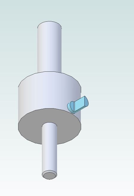

                          Quick question.
                          How much material can I safely leave in the tool head below the tool bit, without it fracturing?
                          Here is a pic showing the centre of the 5/16" bit being positions 14mm from the base – this leaves 10mm below the base of the tool bit:
                          And another showing the central hole being at 9mm which leaves 5mm below the tool bit?
                          As mentioned tool is being designed to cut very shallow depths, but what if I wanted to say use it to enlarge the valve throat. Obviously I would be restricted to bottoming out on the base of the throat.
                          #565332
                            the 9mm should be fine
