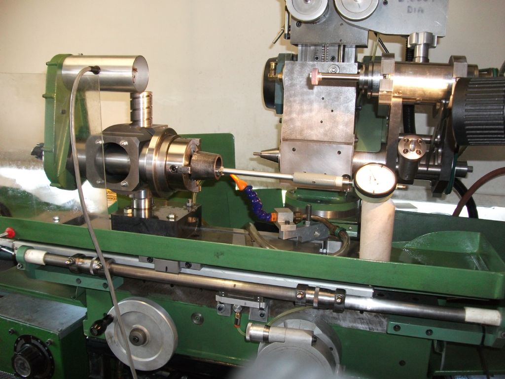

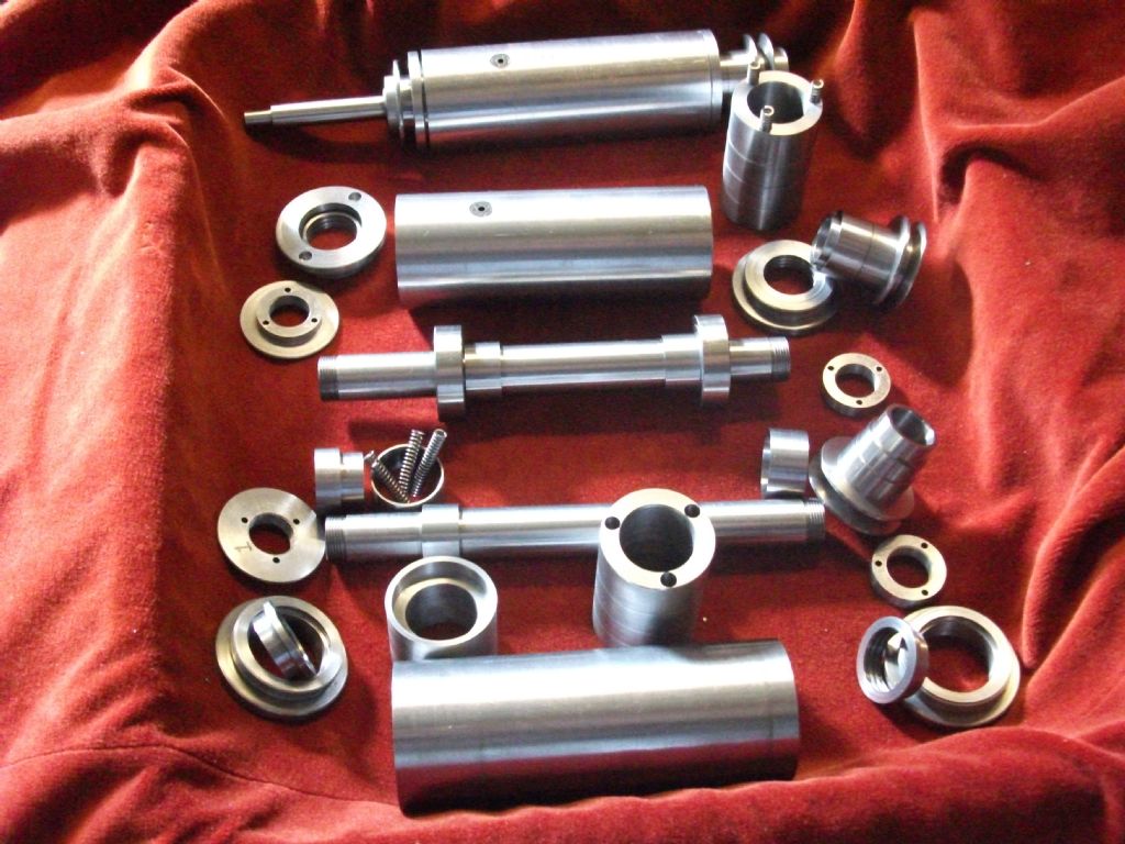

          I built my Quorn spindle to the Chaddock design in the book
          35 + years ago never had it apart, still runs quiet and smooth.
          There are many ways to make a better spindle that is stiffer that
          the Quorn ,these 3 here are slightly larger than the Quorn use only
          standard SKF eco bearings 20 lb preload run up to 31,000 rpm
          at 65 deg c .

                    I don't think there is any problem with the disk springs being used
                    for the pre-load on these bearings it is more the way they have been
                    used directly against the rear bearing ,in this way there is little support
                    for the bearing, in the D.H. Chaddock design and also most spindle
                    bearing designs use a sliding sleeve which is sprung loaded against
                    the bearing outer ring since the sleeve is longer than the bearing
                    diameter it ensures the outer ring is held square within the spindle body.
                    The photo of spindles shown earlier are similar to the Chaddock
                    designed spindles except for all the machining operations are
                    done at a single setting with no turnaround setting up including all of the
                    labyrinth seal parts with the exception of the rear end cap retaining
                    threads in the main spindle body. The spring box length is about 2 x the
                    bearing diameter ,each of the 3 springs the pressure is set individually
                    by drilling the holes too deep and dropping in a spacer to set up the
                    spring pressure .

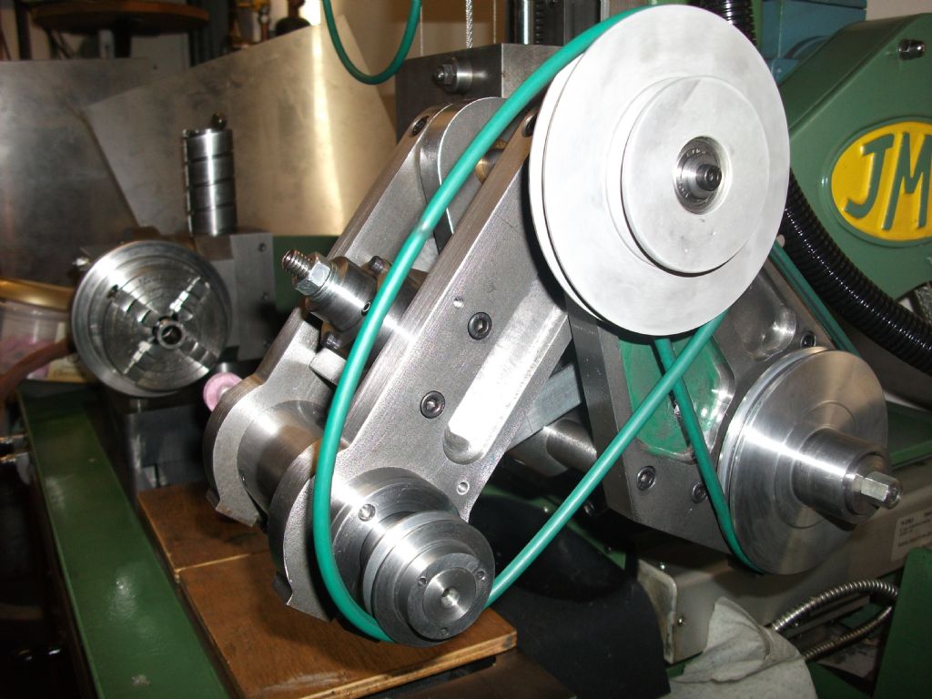

                              which gives up due to the centrifugal force flexing the belt as seen here ,the belt
                              has so much tension it needs some effort to fit over the pulleys but turns into
                              chewing gum at high speed.
                              For future designs, would it be better to use nylon reinforced flat belts? They are
                              nowhere near as stretchy as the round polyurethane belt.
                              Hi Mark,
                              Most probably .
                              Like most things some compromises have to be made,
                              manufactured belts are fixed sizes and as such what they fit on has
                              to be designed to make them fit ,that would have caused me somewhat of a
                              problem as to accommodate the swing up head seen here no adjustment
                              is possible to tension the belt.
                              As the spindle has a working speed from about 4,000 to the
                              31,000 rpm accomplished via belt changes and inverter
                              regulation additional problems with other fixed belt sizes would undoubtedly
                              be present, the heat joint belting gets around these complications just by
                              being able to be made to suit, the inconvenience of the belt flexing
                              only occurs above the 31,000 rpm which is more than enough for
                              the internal grinding for which it is designed.

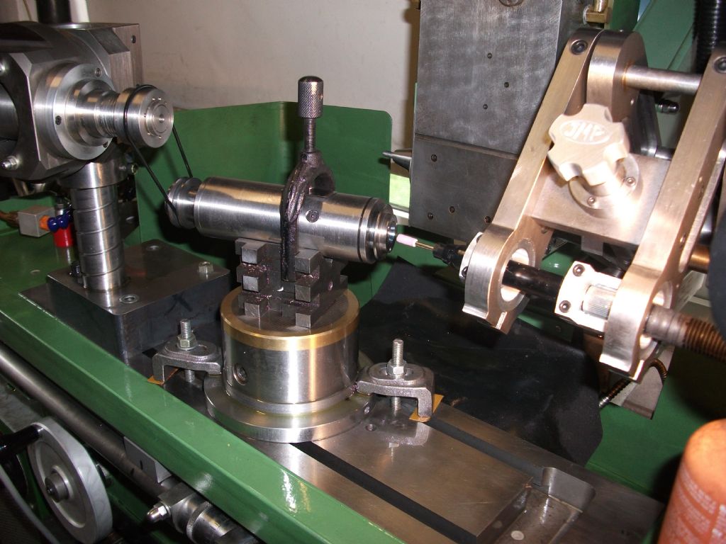

                              I have an air spindle that runs at around 50,000 rpm for those times
                              when that this may be needed.Since the machine was originally designed
                              as a cylindrical grinder and is also a surface grinder along with the
                              internal facility some inevitable compromises have been made ,it just
                              what you have to do to build something like this.
