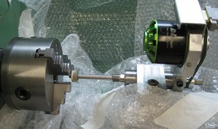

                        I then set up for grinding:
                        I made a flanged insert, with an M8 thread through. This was inserted into the rear of the jaws, with the flange square up against the jaw rear face. The jaws were then tightened up firmly on the 2mm wide part of the flange, which was 22mm diameter. The threaded bolt was used as an aid the fitting the flange in the rear of the chuck. The bolt was the unthreaded and removed.
                        The grinder with a 20mm diameter wheel was then used to grind the jaws, with the chuck rotating at around 50RPM.
                        At first only jaws 1 and 3 made contact and slowly as depth was achieved, jaw 2 came into play. The process continued until all three jaws barely sparked, and the job was done.

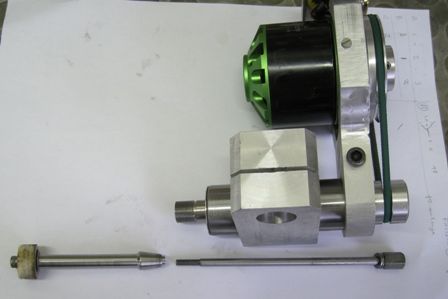

                        The grinder – using an RC brushless motor, a home made ER11 spindle and matching ER11 grindstone spindle, with drawbar. Spins @ 15,000 RPM
