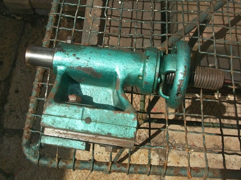

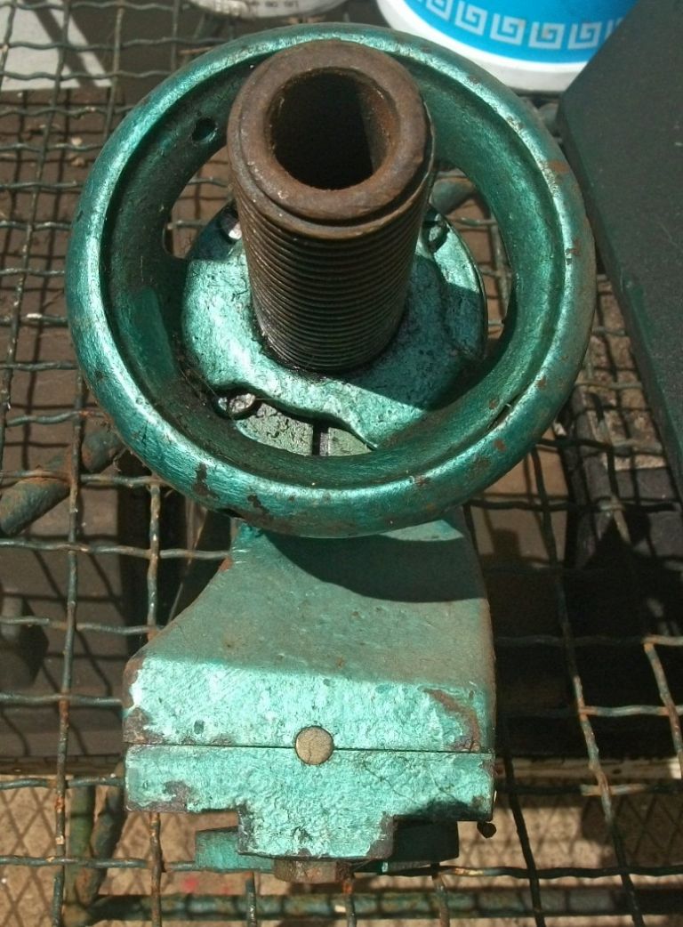

      hi all,ive been given a grayson lathe to restore,ive stripped it all down,made an electrolisis bath and put everything of the lathe in there,got the lathe back to bare metal and gave it all a coat of zinc phosphate primer.while i was priming the tailstock i noticed they wasnt any grub screws to off-set the tailstock,so that when i started googling and came across a thread a few years ago on here
      http://www.model-engineer.co.uk/forums/postings.asp?th=79515
      now this thread hasnt been updated,and wondering if the guy got it sorted,as i seem to have the same problem
      ive been racking my brains about it,whether it had a plate inside the tailstock to move it left or right and up and down,but i noticed in the tailstock they are 3 tapered slots,and a bolt going thru it all to hold it all together,making it type of a fixed tailstock,the other bolt hold is to hold the tailstock onto the lathe bed
      also ive been in touch with tony from lathes.co.uk and he couldnt help me,ive spoke to a few old timers engineers (70-80 year old) and they didnt have a clue
      please take a look at the pictures and see what you think
      thanks

            It is just an economical design. Nothing missing. The half holes take dowel pins, which you seem to have, for the two side ones to form a simple alignment instead of a key and slot, and the one at the rear is to align it 'on centre'. The square head bolt, with washer perhaps, can be loosened off to allow sideways adjustment with the rear dowel removed of course.
            Having adjustment screws is for more expensive lathes. Note the presence of paint on the bearing surface underneath indicates a bit of slack so probably some care needed in setting for general use.

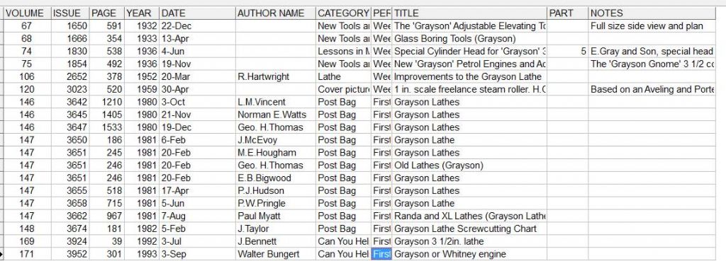

              Edit; There's a letter about grayson lathes in MEW 22 plus the following in ME:

                thanks for your comments guys, neil where have you seen these photos ???
                on tonys site http://www.lathes.co.uk/grayson/index.html it shows the back of tailstock like a small
                long t bar,which i presume moves it forward and backwards or lock it in place,but if the square bolt
                was taken away,the tailstock would lose it setting everytime you slacken the bolt to move the tailstock,
                i just cant get my head around it,if you did some tapered turning you would have to remove the square bolt
                then tighten up with the bolt that holds it onto the lathe bed ???
                i did see a grayson lathe on a auction site,and i sent the guy a message about the tailstock and this is what he said to me
                the usual LH thread & the anti-turn pin/grub screw is through the top. Nothing else comes apart, the only adjustment on it the hex screw for holding it down
                im confuse more to this as it has no thread anywhere apart from the two bolt holes

                  Looking at the pictures on Lathes co there are 2 types of tailstock. One with one bolt that holds everything together and holds the tails stock down the other has 2. I assume one to hold down and the other to hold the assembly together.
                  The dowels at each side orientate the axis one way and the other single one sets it level. There is no side adjustment and it doesn't really matter that one set up uses one bolt as when things are tightened down the dowels will align it all again.
                  Looks like you have 2 holes in one shot. The hole in between the 3 dowels will be the one to hold the assembly together I suspect. Just make sure it's all nice and clean before assembling it.
                  Aligning a tailstock very accurately is such a pain I for one never ever offset it once it's set up. Actually when it's within thous I use a morse reamer to true it up exactly and then leave it all alone.
