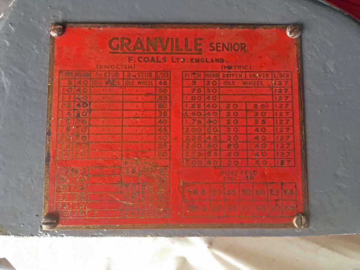

      can anyone produce a replacment change wheel for my Granville lathe???,l dont posses the tools to do it myself,l am currently trying to source the wheel l need but maybe there is a helpful soul out there that would be willing to cut one for me??,l would,of course,cover the costs incurred,l can provide a good colour picture of what l need together with the needed dimensions,thanks.

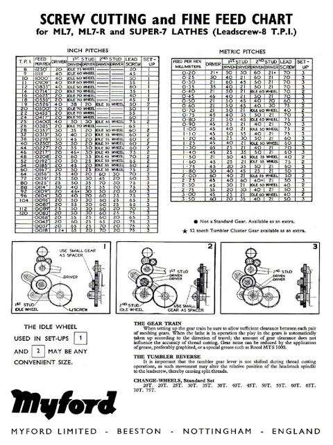

          So worth checking how close Myford centre hole and keyway are. You should be able to adapt.
          For the record, Boxford are 18DP.

                The Myford gears have a 5/8″ bore with a 1/8″ keyway. Should be adaptable. Plenty on that auction site, but they are not giving them away of course.
