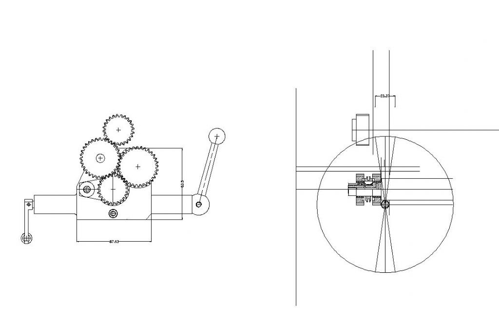

                                                I apologise in advance for side tracking this thread. As regards the Boxford Dog Clutch, a design was started but the person supplying me with the dimensions suddenly dropped out. No work on this design has been done since 2011. I enclose a photo of the scheme, but I doubt I shall ever finish it.

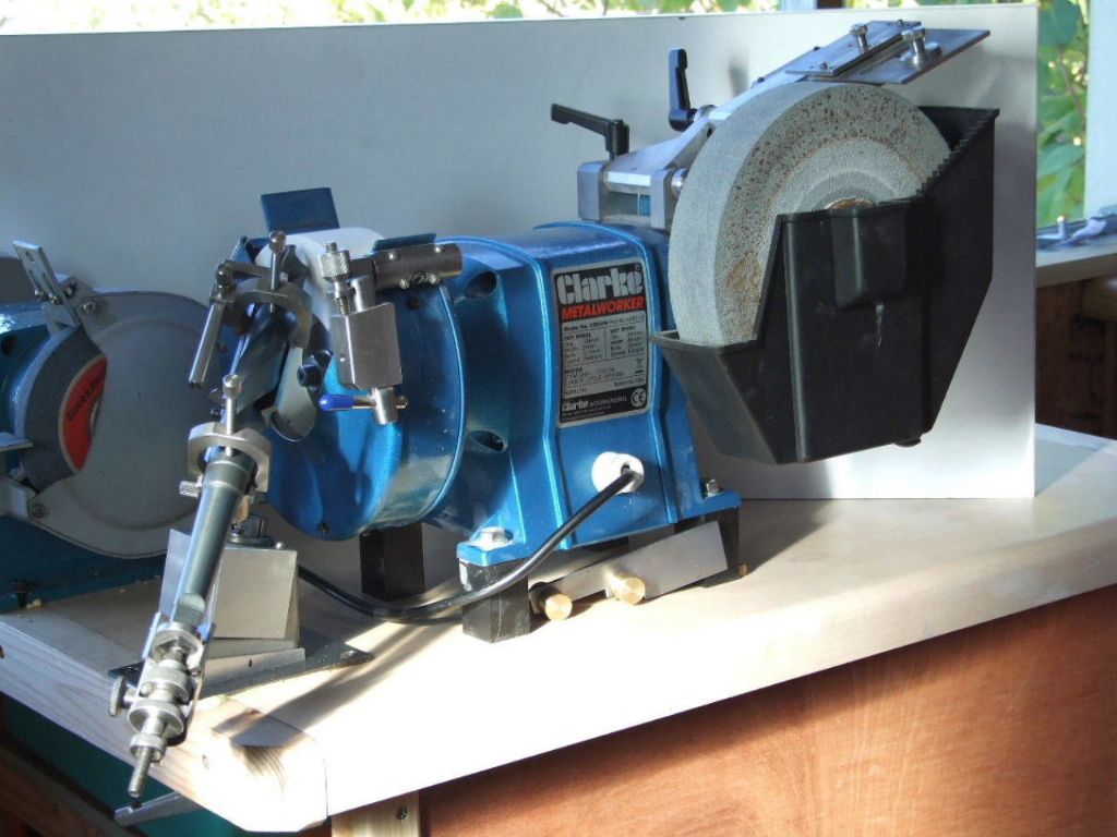

                                                    I have just completed a new arrangement of my drill grinding set-up. I thought it might interest the forum. The drills are now ground as they would when leaving the factory as regards the grinding wheel marks being perpendicular to the cutting edge. This promotes the cutting edge life, grinding lines running parallel to the cutting edge weaken it considerably.
                                                    The steel plate under the jig is set perpendicular to the grinding wheel face. The grinder has its own built in wheel dresser. Which due to its inclination gives a micro adjustment facility. A guard is going to be fitted to the exposed cup wheel periphery. A boss is provided at the rear of the dresser mount which will allow it to pivot out of the way when drill grinding but cover the wheel when using the wet grinder. The rest of which is also my design.
                                                    Regards
