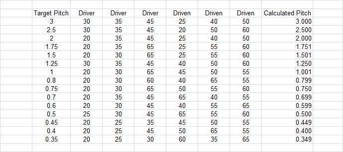

                    As Duncan says, the 63 is used as a driver to give a better approximation.  Myford used a 21 rather than a 63 in their tables.  The thing is, the tables produced by the lathe manufacturers for metric threads on imperial machines were developed by analytical means.  These days computers can juggle all the options in double quick time and give you a whole bunch of alternative combinations to give satisfactory results.  The table below is an example using just the standard set of gears as would have been supplied by Zyto (I used to have one).
                    basic gear set metric apprx
                    #808949
                      And here is the 63T being used as a driver and the driven. There is a fixed 40T on the spindle before the gears in the chart. 8tpi leadscrew. Position A is straight through the gearbox 1:1
                      20250724_191314
