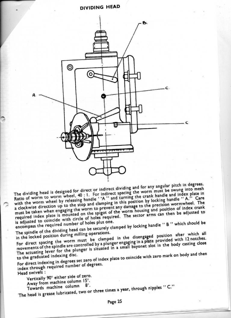

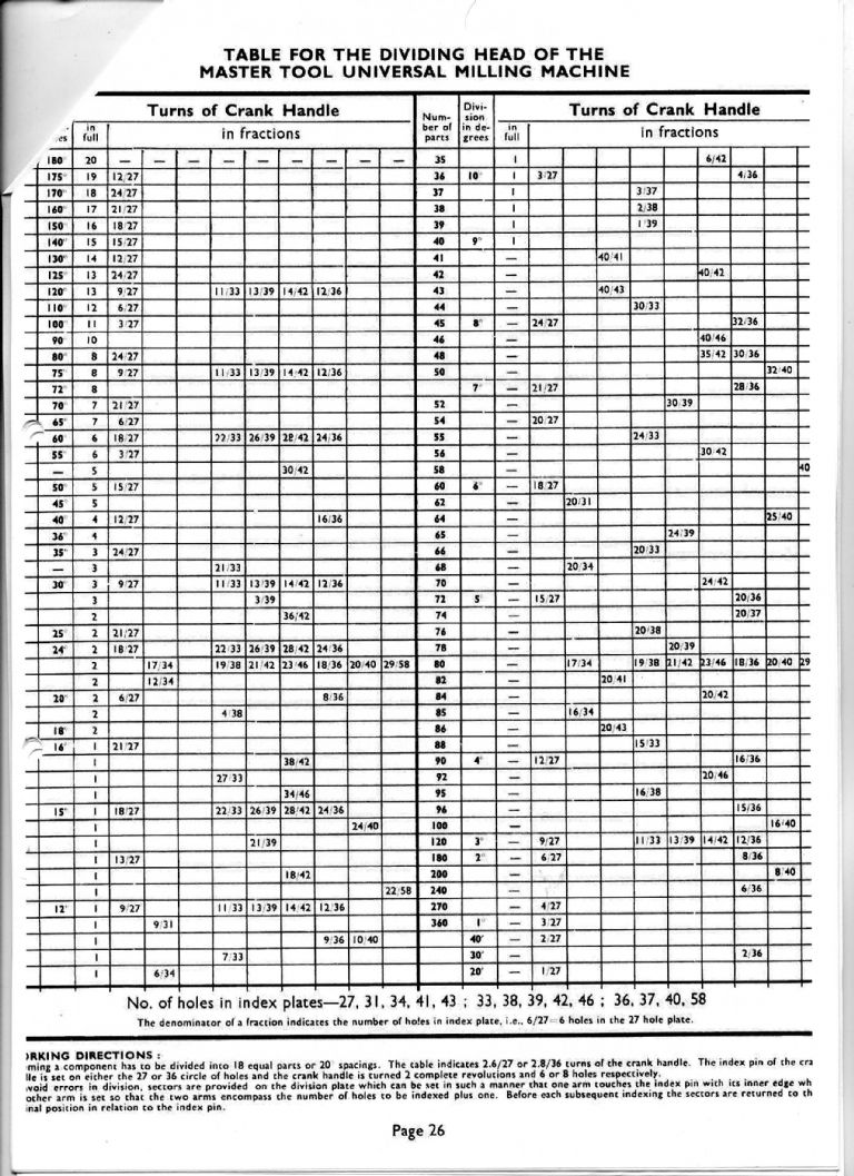

                            Hello Mark,
                            Thank you for your upload of the FP1 manual, it's much appreciated.
                            There is however some pages missing ! I've ignored duplicated ones.
                            The missing pages are:- in bb, 26 & 27 and in cc, 42, 43, 44, & 45.

                              John, i dont unfortunately have the pages 26-27 which are missing from my copy, on comparing with the alexander mill manual i have to assume they are concerning the dividing head attachment
                              Heres the alexander ones but i dont know if the readings/ settings are the same , they maybe as the OP  he said his machine was also imperial.

                                      Hello Mark,
                                      Thank you for those two pages.
