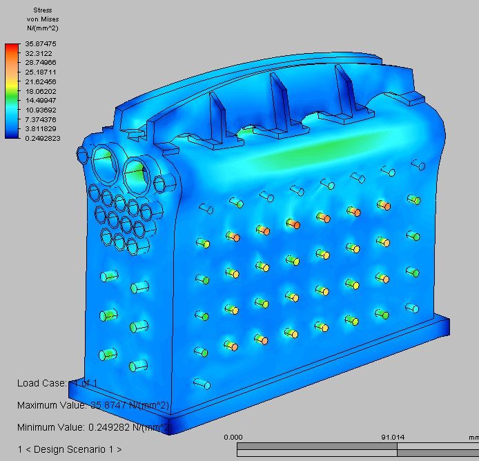

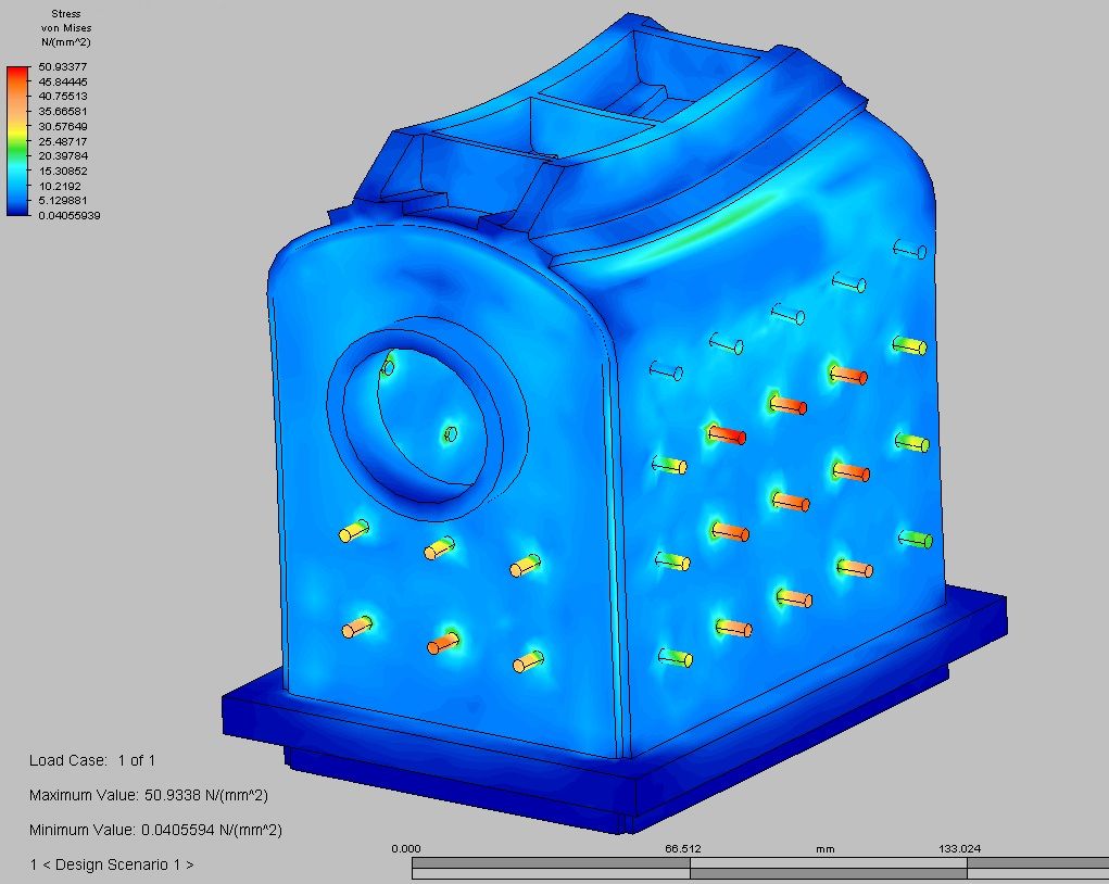

      I have had some email correspondence with Paul regarding his original post, “Are my boiler stays over stressed”.
      To answer his question I carried out an FEA (Finite element analysis) based on the drawings of the Durham traction engine boiler by John Haining. The results are shown below.
      The materials are all copper except for the boiler firebox side stays which are specified as bronze.
      The analysis confirms that, for the copper crown stays, the stresses at an operating pressure of 90 psi range between 6 and 24 N/mm2 well within the design limit of 26 N/mm2. (3770 psi). This stress is much lower than the 113 N/mm2 (16400 psi) which Paul calculated correctly for a simply supported beam.
      The bronze stays have a maximum stress around 50 N/mm2, again well within the material yield strength.
      This analysis verifies the original designer provided a very sound design which has been demonstrated by the many examples in steam for many years.
      Nigel

            I greatly appreciate Nigel’s work in carrying out the FEA analysis on the firebox girder stays. I think he has done the hobby a service.
            It is now clear that the stresses in these girder stays designed by John Haining, and, by similarity, also the Martin Evans designs, are within the safe working limits used for other parts of the boiler. In my view we can conclude that the calculation of the girder stress using a simple beam model, (the point from which I started this thread) gives results that are quite unrealistic. The prediction of firebox collapse has not happened, and now we know why.
            Nigel’s work is a vindication of the design talent of the two eminent model engineers, Evans and Haining, who had to work without FEA, but using their judgment and experience, backed up by experiment.
            Paul

              Hi Stub/Jason
              I have subsequently included the cutouts in the girder and cross members. There is no change to the stress levels only some slight changes to the stress distribution as you would expect.
              It’s best to build up FEA in stages, then you learn more about the application and it makes it easier to resolve any FEA model problems.
              Paul, this analysis is indeed a vindication of the original design work.
              Seasons greetings and best wishes to everyone for 2013
              Nigel

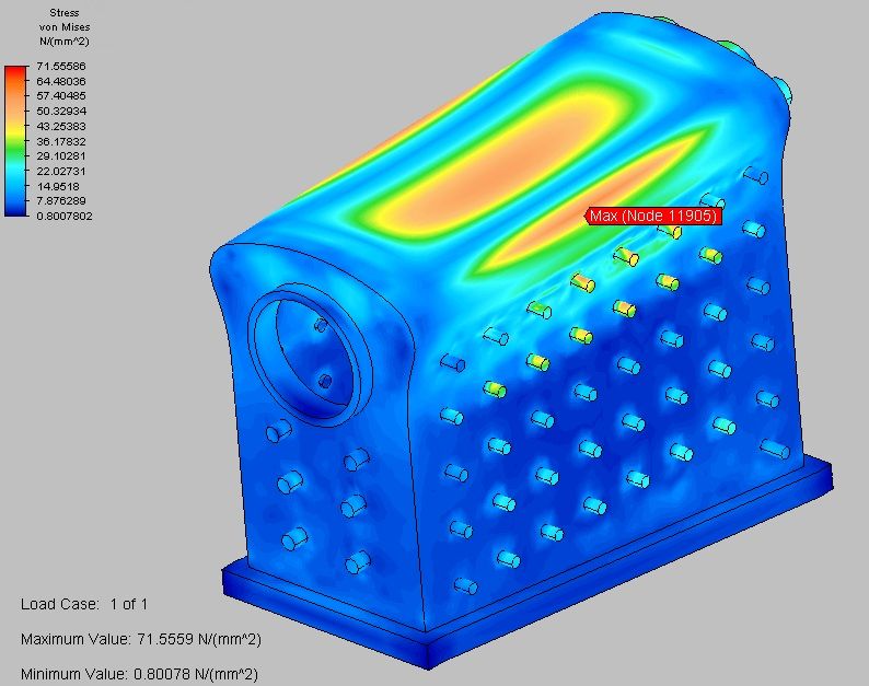

                                      Hi
                                      Micheal William’s interest in the Prince of Wales Fire box Girder Stays propted me to do some FEA on his behalf.
                                      The results are as shown below. More results are shown in my album.
                                      As can be seen the above is without girder stays.
                                      and the above with girder stays.
                                      These results show reduced stresses provided by the girder stays.
                                      The analysis is done at a working pressure of 90 psi, material copper.
                                      Even without the girder stays the design is quite robust IMHO, that’s not to suggest they should be omitted.
                                      I hope these results are helpful to those designing and building boilers.
                                      Enjoy
                                      Nigel
