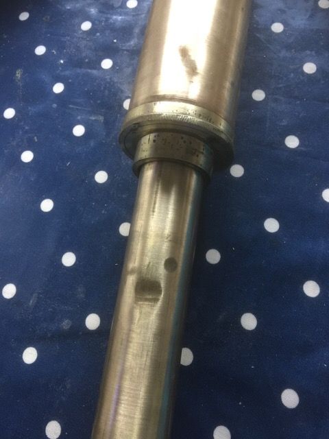

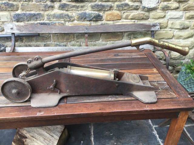

        I'm on with restoring an old kismet pump hopefully to use as a quiet pump to top up my car and bike tyres.img_0309.jpg
        The cylinders (its a duplex type) have a few dings in them which in the whole scheme of things dont really matter as it has as standard leather seals which will conform to the slightly distorted inner surface.
        However how would i go about removing the dings?
        Also does anyone know if i could retrofit modern seals? What types do i need to look for my worry is that with infrequent use the leather will dry out and need constant attention oiling etc

                                      Just been measuring for seals purposes and the larger size has a wall thickness of 3mm and the smaller 2mm
                                      Will the dings/dents spring out or should i heat locally when the plug is near?

                                          Ian Parkin
                                            @ianparkin39383
                                            J Hancock
                                            The ding in the outside isn't the prob is where its on the inside
                                            #310118

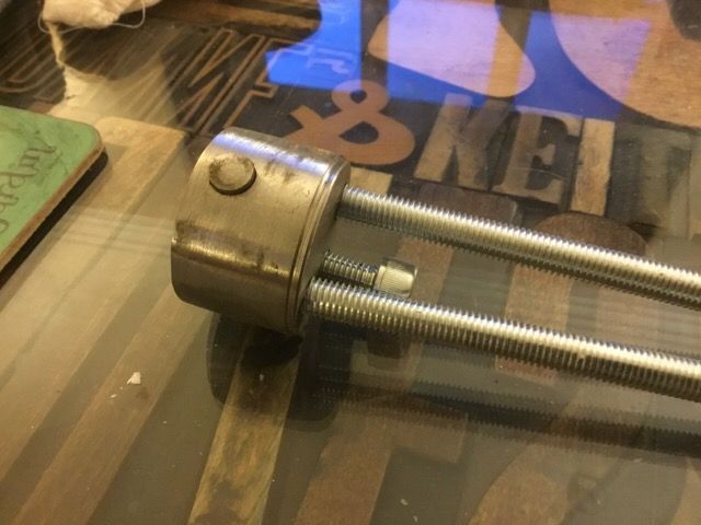

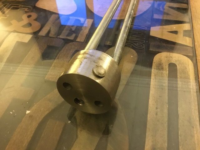

                                              Ian Parkin
                                                @ianparkin39383
                                                Well i tried the plug idea but it just went past the dings with lots of force and then came back out with much pulling and the dents remained
                                                So i made a plug to be a nice sliding fit and cross drilled a 10mm hole and a 10mm tapped hole in line with the plug then a 10mm da plug of silver steel with a taper on one end and ground to match the outer dia place the plug in the tube aligned the pusher and a long Allen key winds the peg out pushing the dent out…quite satisfying watching the dent slowly pop out..never to spring back i hope

                                                    Ian Parkin
                                                      @ianparkin39383
                                                      i'll post photos when its done
                                                      The wall thickness is plenty so it will polish out easily
                                                      I'm more concerned with teh pump working than looking as new
