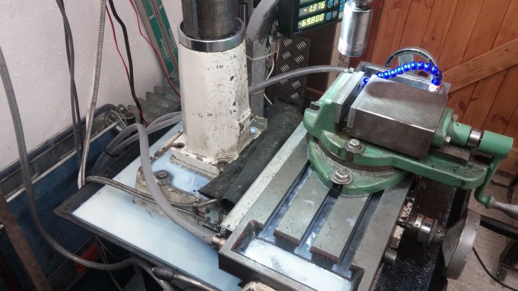

      I have fitted a coolant system to my round column style mill. I have fitted a drain to either end of the table, in the trough at the end of the Tslots. The drain holes are at the same level as the base of the troughs. The drain holes are reasonably large at 3/8BSP fitted with 10mm straight through hose fittings, with 10mm I/D hose running about 1.5 metres back and down to the coolant tank. Coolant tank is about 1 metre below the table.
      When I run coolant at a fairly fast rate the table fills up and doesnt seem to drain very well. I can see into the coolant pipes and there is only a trickle going down the pipe even though the coolant level is above that of the pipe entry. I can get, maybe an inch deep of coolant and there is still poor flow.
      Occasionally the drain pipe will fill with coolant to the point that it syphons down and clears the table in about a second, then seems to repeat the same thing. Table fills up, pipe syphons the table clear very quickly, gurgles as it empties, syphon stops, table fills and the process repeats. Other times it just seems to stick with a piddly flow out of both of the pipes.
      Having the table overflow when the table in central is fine as it just spills over into the drip tray, but when the table is off to one side, the coolant will overflow onto the floor.
      I can of course reduce the coolant rate down to the point where i'm putting it on at the same rate that it flows out of the table, but sometimes for chip control I just want to flood the heck out of it.
      So, whats the trick to get coolant to drain through a reasonably small bore pipe with little or no head of pressure to get it going. Shorter pipe? Larger bore? Smaller bore? U bend/pipe routing to promote syphoning?
      Anyone played/tweaked with things like this?
      Thanks for any help
      Graham

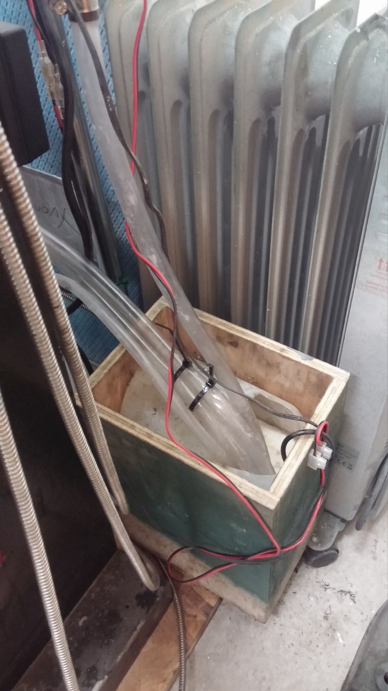

              Ive just been out to the workshop and adjusted the pipes as they enter the coolant tank. I secured the pipes so they feed out above the level of the coolant. This has improved things vastly. and now It clears the table very quickly due to the pulling/syphoning effect regardless of the coolant rate that I throw at it.

                    Here's a picture of the table with drains.

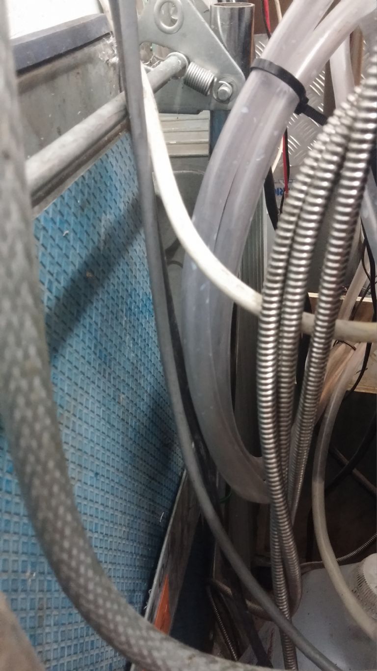

                    Here's a shot of the the table drain pipes as they go down the back of the mill. You can see they almost go horizontal just before they go into the coolant tank.
                    And here is a shot of them at the tank, secured just above the coolant level.

                      With further thought I wonder if the drain pipe requires an air vent a couple of inches downstream from the connection to the table to aid the flow? Might try that.
                      Chris
                      #170855
                      Graham Wharton
                        @grahamwharton
                        I did think about that, but I think doing that will stop any syphoning effect as once the coolant fills a section of the pipe and starts sucking coolant down the pipe with it, it will suck in air through the vent and you will loose the syphon.
                        It would appear that the combination of a reasonably long tube, possibly with the horizontal section at the outlet from the table and not having the lower end under water has done the trick for my setup.
                        Do your pipes go straight down from the table, or horizontal. Mine come out horizontal. You can see the section just at the outlet start to fill up, then the pipe goes full bore with coolant, which then starts to fall down the pipe. Once it starts going it just sucks all the coolant from the table under its own weight. With the lower end under water, the top end of the pipe never seems to achieve full bore, i just get a sow trickle as it forces its way past all of the trapped air.

                                Try rerouting you tubing to have a vertical drop as close to your table as possible as it seems that you have a fair near horizontal run to the back of your column, in one shot it appears that the left hand tube seems to have a slight rise before it drops over the back of the column… making it higher than the table… negates the syphon effect… leave the drain tube ends above the level of the tank otherwise you're trying to overcome atmospheric pressure on top of the suds level, so without any added pressure / decent syphon drop your suds stay where they are… thinking … you can only give it a try … don't forget to add a filter of sorts before suds enters the tank  (  apologies for granny & eggs implication )

                                    Try taking the ends of the tubes out of the liquid at the lowest point so the air being trapped does not have to come back up the tube.🎅
