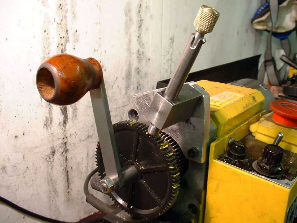

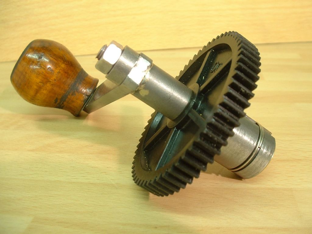

            This is how I did it for my mini-lathe many years ago now. Mike Chrisp expressed concern the rear of the mandrel on some lathes may not be bored concentrically enough for accurate dividing, but my mini lathe's bore is less than 0.001" TIR at the back.
            Edited By Neil Wyatt on 08/12/2017 12:38:53
                  Thanks Neil, that''s sort of what i had in mind, but you make a good point on the concentricity of the bore, something I'll have to check before proceeding I think.
