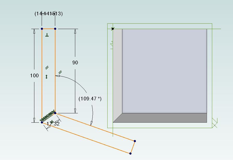

                yes 109.5 approx
                Measure the 4 edges of the chamfered face off your CAD model and draw that "flat" then measure the angle, easier than trig

                        Meanwhile you have inspired me to draw a sketch on the chamfer surface in my CAD (OnShape) and the internal angle measured "54.7356103deg", which for my purposes needs to be doubled, which gets me to "109.4712206 deg" smileyyes
                        …Just in case anyone else might need all those decimal places!

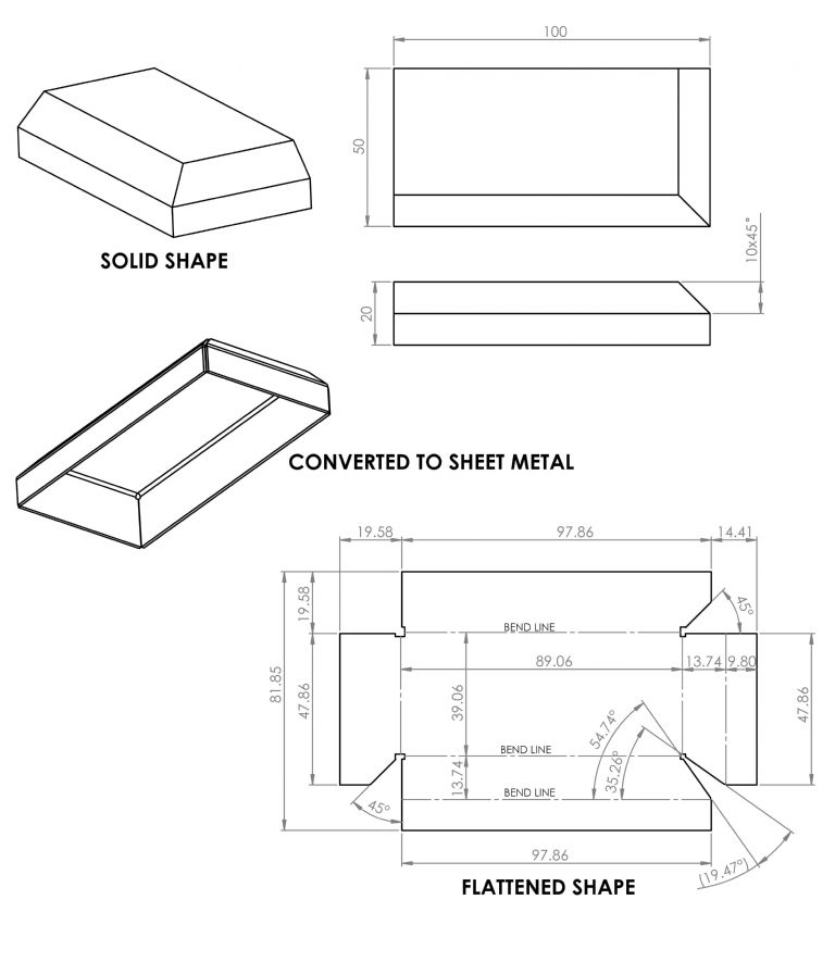

                          CAD software that has a sheet metal module can produce a flat pattern that is used for bending.
                          It is first modeled as a solid 3D part to the final shape. Then the software converts it into a part that is made from sheet metal. This part can then be flattened and dimensions added. Lines for bending are also shown.

                              Paul Lousick has the answer with 19.47 degrees, (19-28-12&quot.
