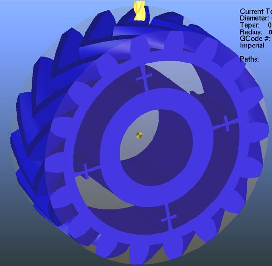

      I have just had a play with Gearotic and was looking at an example of a Herringbone gear. I understand that for the gears to be in line with each other (as opposed to being at ninety degrees) there will be need to be one right-hand and one-left hand gear.
      The query I have is that it would appear that there is no rounding of the apex of the tooth to correspond with the radius left by the cutter at the "internal angle" for want of a better description.
      The simulation doesn't appear to show any rounding of the tooth apex. Is this something that is taken care of when processing the G code?
      Best regards,
      Steve.

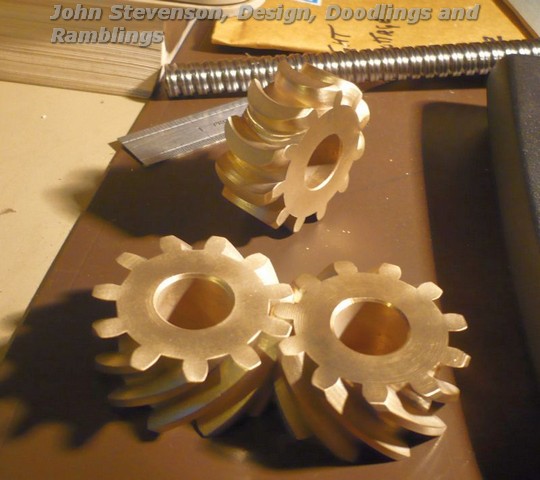

                Now to the original question. The graphics draw the gear OK and code it OK but they can't take into account the cutter radius so yes you do get a small radius in the corner of the internal teeth. What really should have been done is to round the external corner to match. Art realised this but didn't do anything other than in usual Art "Lets go off and see just what we can do " mode he developed the knuckle gear. There is one in the top left corner of the web page with two helicals which are all gears I cut whilst checking code etc.
                This is the picture.

                    An interesting point about relieving the centre of the gear for the hydraulic forces. Just make it wide enough to clear the cutter radius and the problem is solved. Never crossed my mind.

                      Going back thru some old photos and this one is dated end of May 2009 I did actually cut a herringbone with a centre rib but I'm now puzzled how I did it as the later Gearotic wasn't out then.
                      Not the clearest picture but the machine would have been one of the early X3's that Ketan at ARC used to sell a kit for. No idea what happened to the gear unless it's on the CNC display board down at ARC ?
