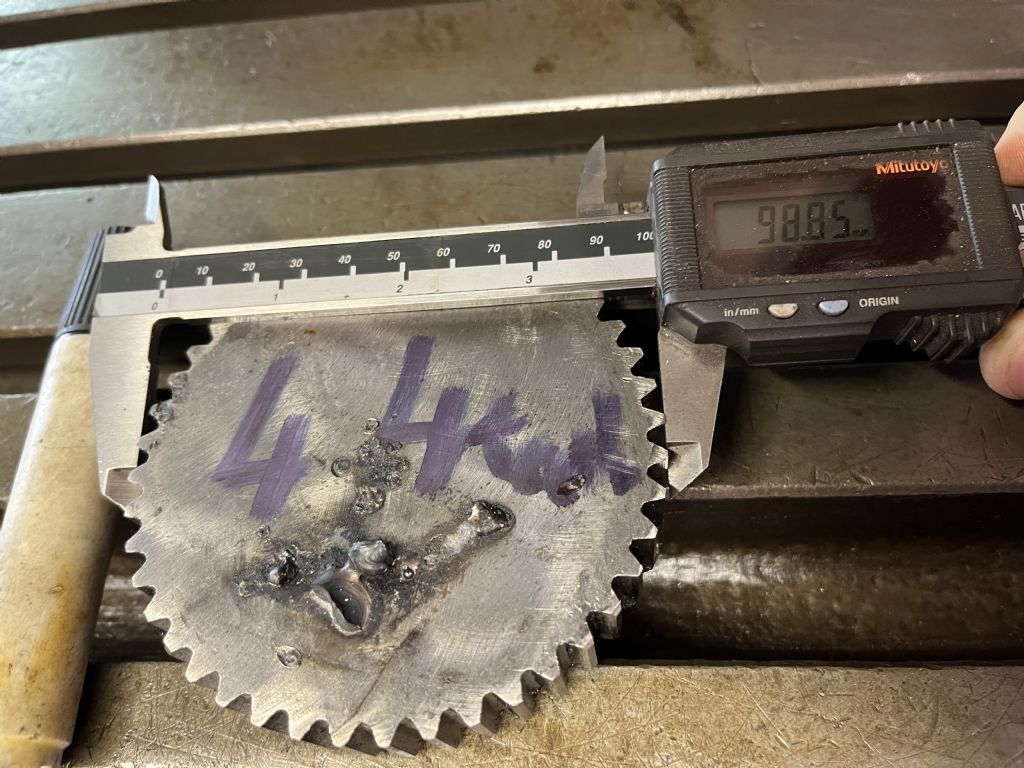

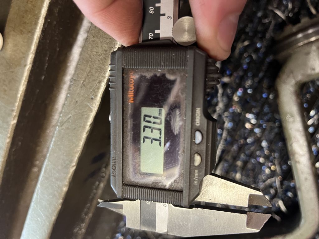

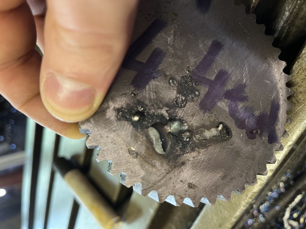

                          #605266
                          Col21
                            @col21
                            The spline shaft is about 99mm diameter with 44 teeth. Could I use an involute cutter for this? Never used one before and if so how do I know which one to buy? As in the photos it’s roughly 3.3mm deep, can this be cut in one pass. I’ve got a Bridgeport mill and dividing head so easy enough to calculate the revolutions.

                              Posted by Col21 on 10/07/2022 17:45:20:
                              You could use an involute spline cutter if you knew the specification of the spline.
                              An involute _gear_ cutter would be totally unsuitable.
                              You will need to research what specifcations of involute spline exist in the world (metric-speaking places are likely to have a different spec. to imperial-speaking). If you are lucky, there may be software that will draw the candidate profile for you so you can print it out at 1:1 scale and compare. Possibly, Gearotic will do it.

                                #605298
                                Pete Rimmer
                                  @peterimmer30576
                                  That's a 2.25 module gear in the picture. Being 6" long I guess you could call it an involute spline but essentially it's a long 2.25MOD involute gear.
                                  It would be quite easy to cut with a gear cutter on a mill but since you say the internal mating part is also damaged you won't be making one of those in the home shop, not easily anyway. That's gear shaper/wire eroder work.

                                    Posted by Pete Rimmer on 10/07/2022 22:19:45:
                                    It's a good observation on the relationship between OD, teeth and module, but that does not necessarily mean it can be called a gear nor can we infer that a gear cutter will form the tooth spaces correctly.
                                    Splines have different geometry to gears, specifically the relationship between pitch diameter, addendum and dedendum. In particular, spline teeth are considerably shallower than gear teeth. In a way, they are roughly analogous to a stub tooth gear profile (I think Fellows had one, designated, for example, as 6/8). As for pressure angle used on splines, we would have to do further research.
                                    There is a set of softwate called MITCalc, which offers a spline module for 14 Euros. Even if a person did not want to buy that, the documentation for that module tells you what you have to measure to identify the spline.

                                      #605325
                                      Hopper
                                        @hopper
                                        Splines are not the same as gear teeth, necessarily. There are various standards for splines, separate from gears, including ISO, DIN, SAE and BS. Among those there are then straight-sided splines, serrated splines and involute splines. Then among the latter can be any of a number of pressure angle involutes ranging from 14.5 degrees to 45 degrees.
                                        Some clue as to what this gearbox is out of would be helpful. 10 ton truck? Or washing machine? Made in which country? Made when?
                                        Another way you can do it is weld it up and make a fly cutter to match one of the undamaged splines and use that to recut the same profile on the welded bit. Rods to use depends, once again, on what the application is. How many horsepower will it be transmitting? At how many rpm? For how long and how often?
                                        Cutting the internal splines could be done in a slotter or shaper, depending on the length of the spline required.

                                                  Posted by DC31k on 11/07/2022 06:26:31:
                                                  It's possible but I would bet my hat that it's a 20PA gear profile just going by the photos. It would take some decent measuring to find out but a simpler method would be to print the profile generated by geardxf and stand the gear on the print. It would be obvious right away.
