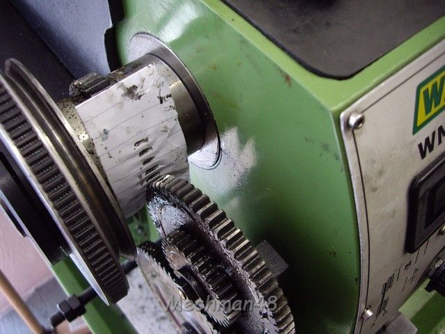

          Three things that make a lot of difference.
          1 Set the right backlash between gears buy cutting strips of copy paper and squashing between gears as you tighten studs and banjo.
          2 make sure you have the washers between banjo and gear pairs the right way round the thick washer should go against the smaller gear, thing washer against larger
          3 The banjo can move left-right slightly on the pivot adjust that for quiet running

                Try setting the gears with paper first and if that doesnt work, try it again. some of those chinese gears are not cut concentrically.
                The last thing i would do is use lapping paste or anything on the gears. maybe just a little fresh grease, but it shouldnt need it.
                We di have a similar lathe to yours in the next workshop to where i worked and the gears were set badly. The supervisor knew everything so we never offered to help. It was loud.

                          Going back to the gear adjustment; I set the backlash gap as per Old Al said, using paper & set gap on each set of gears working up from the bottom… the paper IIRC was .003" folded giving .006" gap, some may say .004" is preferable. I used motor cycle chain lubricant spray on the gear teeth, slightly thicker than SAE32 but not as thick as transmission oil.
                          George.

                                        Full agreement with using paper in the mesh to set the backlash on changewheels, but I would only use one sheet, to give 0.003"
                                        Gears running with no, or too little backllash will be noisy, and wear.
                                        Too much backlash will be noisy because of the excessive backlash, and the fact that for a variety of reasons, the rotational speed (angular velocity) will not be constant.
                                        Applying a really heavy grease (ideally one formulated for gear lubrication ) will quieten things.
                                        For gears within the head, you are stuck with whatever the gears sizes and gear centres provide. Again, a really sticky grease will reduce noise, and wear.
