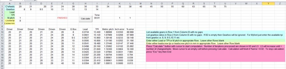

                I applaud your effort, particular the fact that your program is completely stand alone and platform independent. I would caution against trying to make your program too universal. My own attempt written in visual basic in Excel is specifically focused on my own particular needs to calculate long leads on a Myford S7 with add on gear box, metric conversion set and loads of change gears. Too specialised, I suggest.
                My advice would be to add another pair of gears like Hairy Pete has since most lathes can accommodate this. The option to select 4 or 6 gear trains would be good but clearly six gears gives a better chance of a closer result to the desired pitch so if a 4 gear train won't get close enough then a six gear train is worth a try. I suspect specifying the order of the gears is going to be too difficult since there are so many variations in banjo size and configuration. Letting the user know which are the drivers and which are driven is probably the best you can do. The user can work out which to put where on their own particular lathe. Give the user some options with a list of results since lesser accuracy may be acceptable if the better result won't mesh. I hope these thought are some use.
