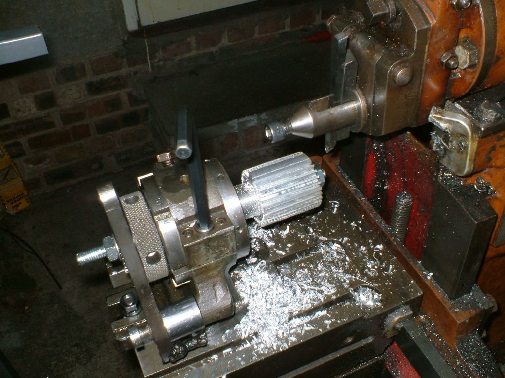

        I will soon have a shaping machine. A small version to replace my huge one which I gave away to a deserving cause.
        Now I want to try my hand at gear cutting, I have the Myford kit required to do this on my ML7, when its protracted overhaul is complete.
        Meanwhile I would like to try gear cutting on the shaper. I assume that I will need a profiled cutter to replicate the gaps between the teeth! Is this at all possible? Also what is the best method of indexing the blank? Not sure if I can somehow use my rotary table, although I don't know how one would do that!
        I am curious to know if a shaper can be used for this task. I am sure that I have read about this, years ago, in an ancient engineering book.

              Yes no problem. The hardest bit is grinding the form tool. Using a rotary table or dividing head won't present any problems as long as you have a bit of clearance after the tool clears the job.

                    Posted by vintagengineer on 11/02/2017 18:25:56:
                    You only need to grind a very simple tool for this process, ie one that has the form of a straight sided rack tooth, the only thing to worry about is the pressure angle required.
                    The teeth are generated as the blank rotates when the table moves sideways, the indexing is to move the blank round to the next tooth after each pass of the table, the dividing head is normally linked to the movement of the table with a band of very thin spring steel around a pulley of the same diameter as the PCD of the gear being cut.
                    The idea is that the blank rotates and rolls the tooth space past the cutter as it does so, thus generating the gap between teeth.

                      I cut two 14 tooth gears for my Hardinge HLV rebuild using the 'Base Circle' technique in Michael's link. One was 14.5° PA full form and the other was 20°PA stub form. Just needed two different ACME type tools for the correct PA. I used 2 thou shim stock instead of the wire in the link. Other than that, the setup was very similar.
                      A not very good video is here:- **LINK**
                      I had used involute cutters for the other nine gears in the apron gearbox, but these two could not be done that way because there wasn't enough clearance for the cutter on one and the cutters didn't have the correct PA on the other. Hence the shaper job.
                      Once I'd built the jig to index and rotate the blank as the table moved sideways the work was simple, if somewhat monotonous.

                        Thanks for the demonstration video, Mark
                        Mine is an Adept No.2 hand-operated shaper, but I'm determined to give this method a go [when I can get back into the workshop].

                          It might be simpler to grind your own involute-shaped cutter from a piece of HSS, using the the two discs method outlined in Ivan Law's book "Gears and Gearcutting", a part of the Workshop Practice series. You should have a copy of this book if you are getting into gear cutting anyways. No need to use his twin disc forumla to make turning tools and then turn up cutter blanks etc, just use the geometry to make a sheet metal template then grind and diamond file your HSS shaper tool to match the template.
