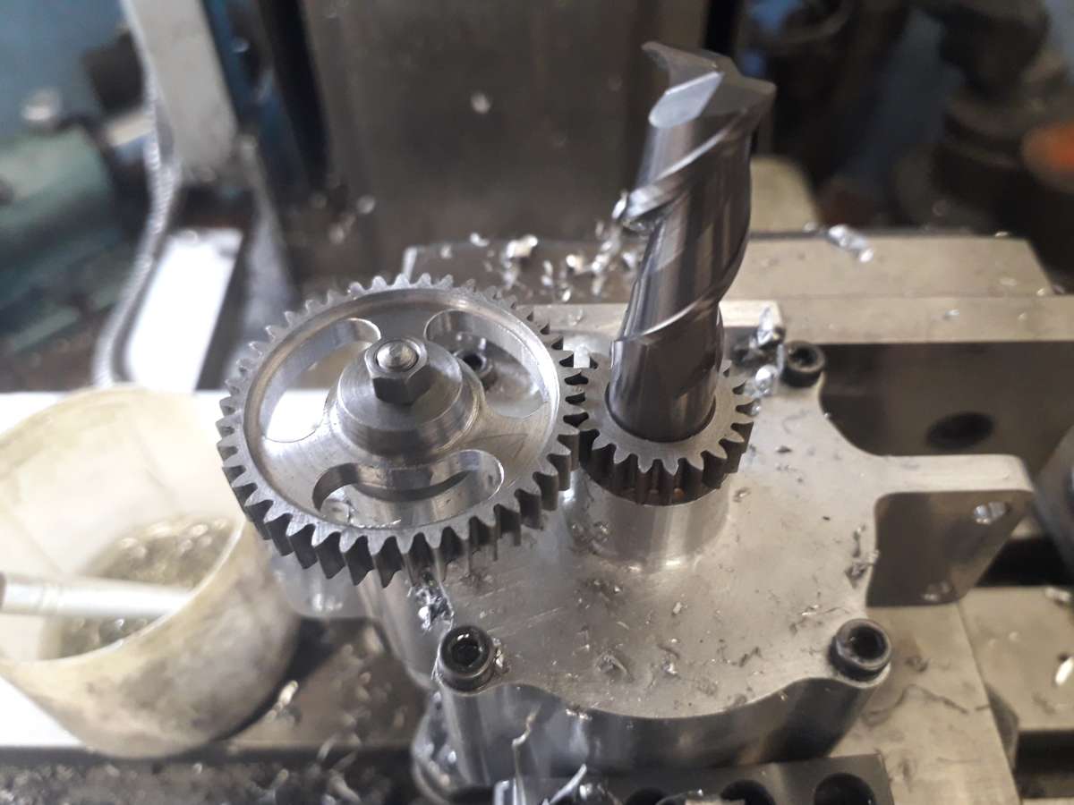

                              #786285
                                Here is one I mentioned which is modified in a similar way to above. Cutting to a theoretical non standard size size with an off the shelf size cutter (2 actually)
                                31.76DP cut with 32DP cutters each of the teeth were altered by the same amount on the 21T and 42T gears which was about 1.6%
                                20190810_091411

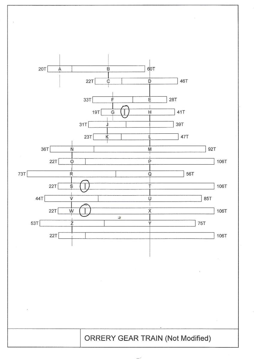

                                        Thanks for the additional comments. The problem area I described is part of an orrery so I’d rather keep the gear teeth as they are as they result in quite accurate orbital times when compared to the earths 365.25 days.
                                        I made a schematic of the gears to try to get my head around the total train. Gears A to D are under the base and are connected to gear E via a shaft going up the center of a tube which gears H, I, L, M, P, Q, T, U, X AND Y rotate around. I made the schematic after finding I couldn’t get gears E, F, G and H to mesh properly. I fixed that by increasing gear H to 42 teeth. The result of this was to 88.4 days to 86.3 days. The actual period of Mercury is 88.0 days. I may go back and recut them so that I retain 41 teeth for gear H.
                                        If you want to get a better idea of the orrery, there is a 3D pdf image of it here:
                                        https://www.youtube.com/redirect?event=video_description&redir_token=QUFFLUhqbHVkSU10d3pjUEYxa29GckZuWGJlVnBOWE43Z3xBQ3Jtc0ttNmNIVllsZk5fT3lpVXg4NmJkQ2JEdnp3akN1c3IwUmdmRG1tSzhWZ2VXdXFvSGlFd285R0VzdWVsS2FEVUNsZHN6Nm13eDNKNFlPMlZoaEFSZ3JEaUFsaDBSOEZoYklpa0dCX3lidExTenB3ZXpvZw&q=http%3A%2F%2Fwww.zeamon.com%2Fdownload%2FZeamonOrrery.pdf&v=YdXMI65cmNw
                                        The gap I’m concerned about now is the one between gears S and T. My initial intention was to make these gears to be module 1.008 to fill the gap. I’m not sure whether it’s possible to reduce the size of of other gears without affecting the train from there on. These are spur gears by the way.
                                        Regards,
                                        Alan C.

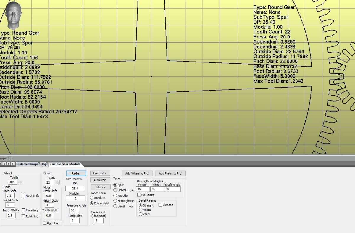

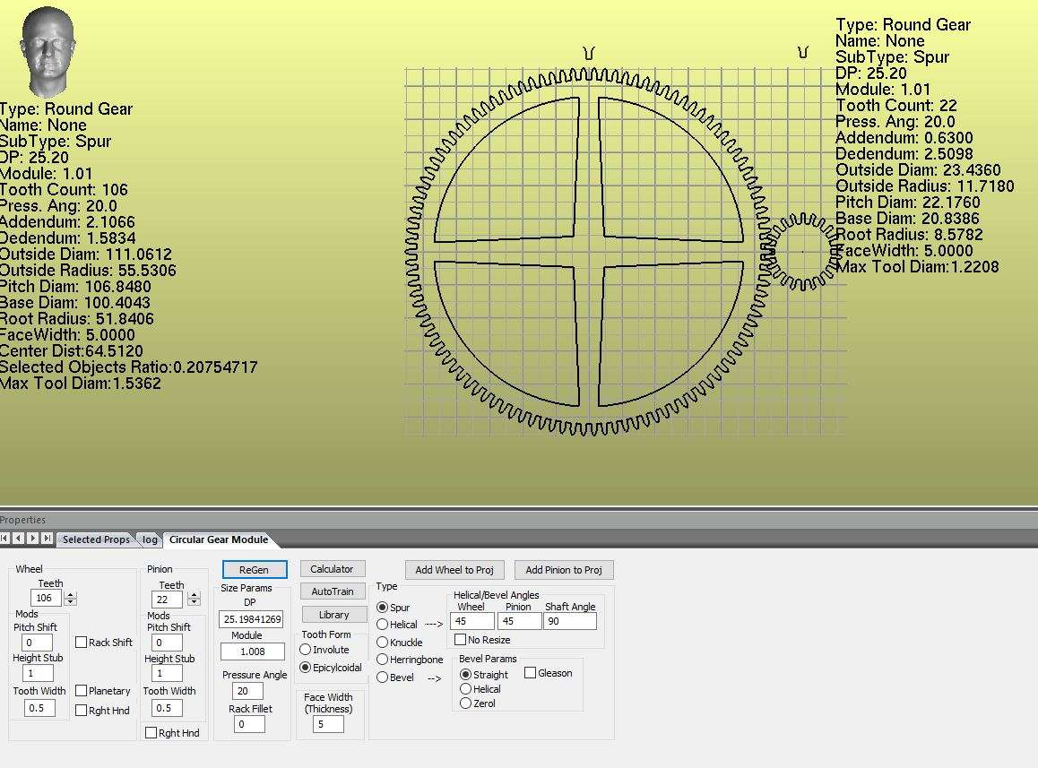

                                                Seems you can’t get the old files to load now as the additional EXE file is not shown on the Gearotic site.
                                                Can those more familiar with Gearotic see if I am entering the shift wrongly as applying a 0.5 shift to both gears does not alter the pitch diameter
                                                mod shift
                                                However playing with teh MOD and altering to 1.008 does increase the pitch diameter of the two gears by a total of 1mm
                                                mod 1008

                                                  Nothing wrong, profile shift does not alter the theoretical value of the PCD of the gears. The addendum and dedendum change and hence the outside diameter of the gear. Also the close mesh centre distance can be changed with profile shift.
                                                  For the 22 to 106 tooth gear a profile shift of about +0.51 applied to one gear or shared between both gears should result in a centre distance 64.5mm, the same as the 56 to 73 pair. Someone might like to check my calculation just in case I can’t remember how it’s done, it has been a long time since I needed to do such things.
                                                  #786479
                                                    Thanks, so what Gearotic is showing is the same normal PCD, I thought it may have gone up.
                                                    Infact I have just noticed at the bottom of the left hand column that the centre distance for each method has gone up from 64 to approx 64.5 which will now match that of the other pair at 129/2

                                                      I’ve just noticed that the calculations that Jason did in the Gearotic were for an epicycloidal tooth form. My profile shift figure was calculated for an involute tooth form which will give different dimensions.
                                                      The PCD or reference diameter as it is sometimes call, remains the same.
