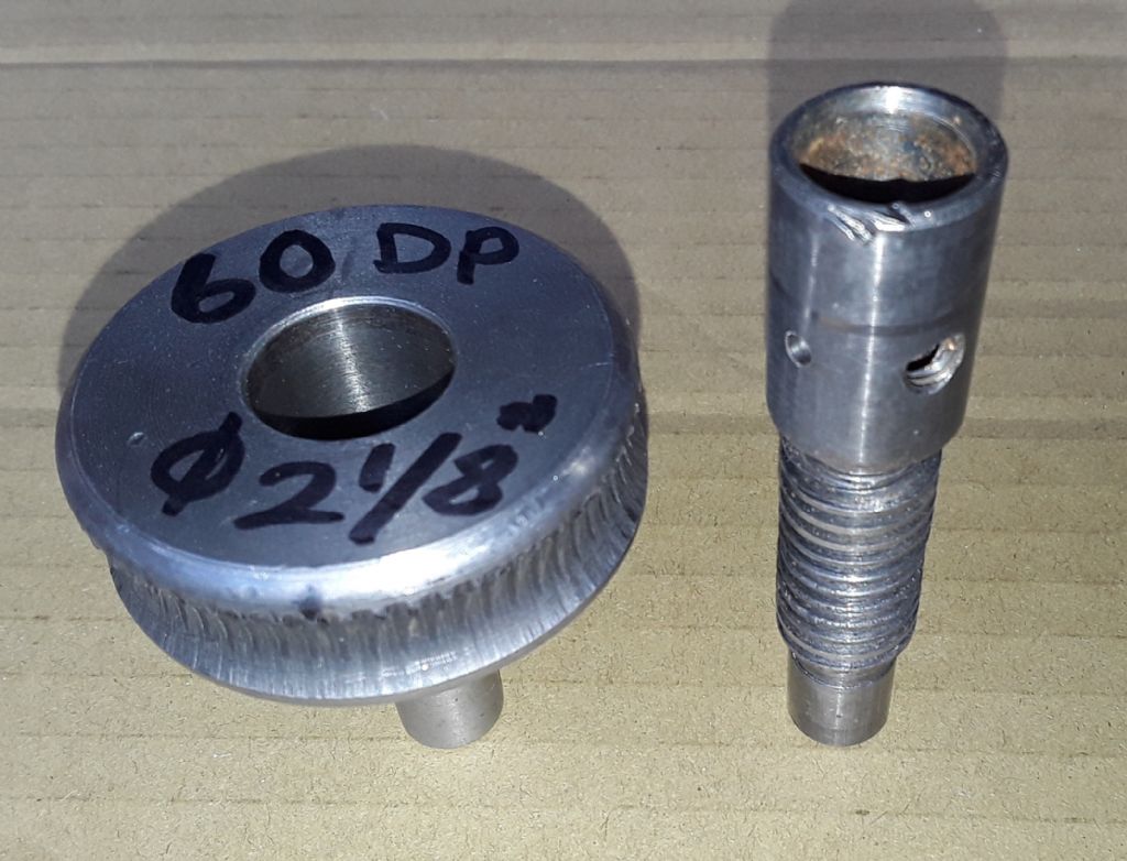

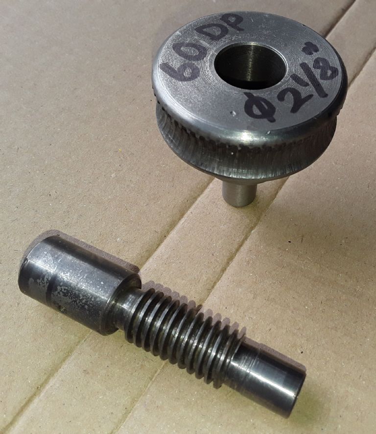

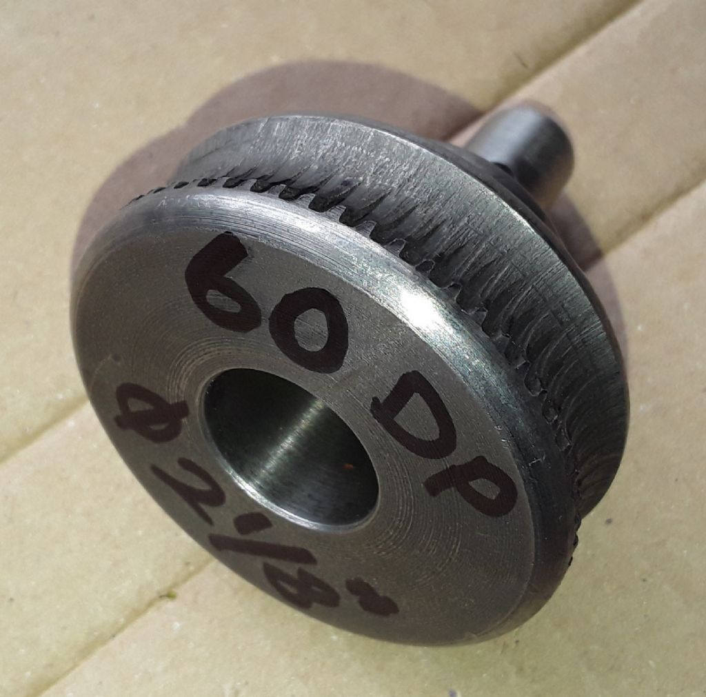

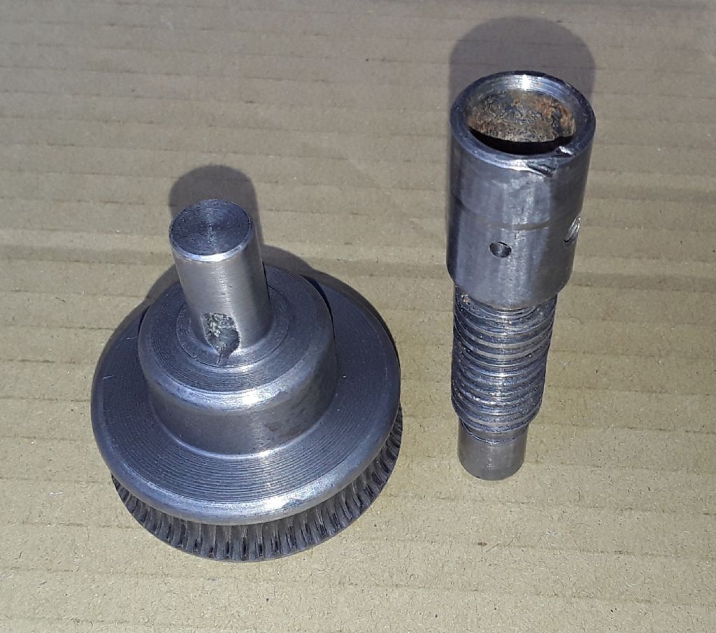

        Hopefully somebody can assist with this issue, my AEW Viceroy milling machine has a stripped worm wheel in the bed feed gearbox (it was like this when I bought it).
        The worm coming from the motor is not too bad but i think its best to replace both, the 2.1/8" od 60DP wheel has totally stripped its self and need replacing.
        Does anybody know of a company who do one off gear work and could make me replacements whch wont break the bank!!
        The alternative would be to buy one of the 240v electric X axis feed units thats currently on ebay for around the £150 msrk, but this would involve modifying the machine which i dont really want to do if i can avoid it.
        Any help would be appreciated
        Ian

                          60DP is very fine for a machine feed of that era. Could you put up some pictures of the offending part Ian.

                              Hi All
                              Thanks for all the contacts i will follow these up and hopefully get something sorted out, just posted a couple of photos to show the damaged gear wheel, this was done years ago i would think and the worm wheel also had the drive key removed and a shear pin installed instead, presumably to act as a safety feature.
                              I have been through several gear catalogues but cant find anything close to the old one so asume its a special gear made for the machine by AEW.
                              I thought of turning off the old gear and pressing on a blank replacement gear bored out to fit over the boss, saving all the work involved and keeping the cost down.
                              Thanks very much to everyone for responding to my inquiry
                              Cheers Ian
                              If i dont have any joy i will have to go down the 240v drive unit route and mod the machine, something i dont really want to do

                                Sorry, Ian … but I struggle to see that as 60 DP
                                May I suggest you take a look through these pages, and check the numbers : **LINK**
                                https://mrosupply2-dyn-documents.s3.amazonaws.com/product_documents/68/68984/p-1930-bg_worms-and-worm-gears_YHmQZx2.pdf

                                    If that gear was 60DP it would have around about 125 teeth. Looks like it has about half that.
                                    What is the pitch of the worm Ian? And the diameter?

                                          The usual formula for calculating spur gears is OD = (Number of teeth +2 ) / DP. This will be more difficult with a form wormwheel, but a wheel of 2.125" diameter with 60 DP would have very fine teeth.
                                          Could it be that the worm is single start and the wormwheel has 60 teeth?
                                          This would provide a non reversible drive (needed for the feed on a heavy knee ) and fine adjustment.
                                          Although, if an Imperial machine, I would have expected 50 or 100 teeth to make the graduations on the handwheel to be 0.001" or 0.002" with a 10 tpi leadscrew.
                                          Counting the teeth on the wormwheel may shed some more light on your needs.

                                                The photos you have shown don't really give the information
                                                that would be needed to find or make a gear set .As it stands
                                                the wormwheel is probably 30 dp around 60 tooth as there is
                                                no sizes given on the worm as far as i can see.
                                                On the assumption the the axis of the leadscrew input and drive motor
                                                are fixed with no adjustment the only essential information needed
                                                is the centre distance between these two shafts.
                                                As i have had my mill set up for some months i found a scrap of
                                                nylon and cut this wormwheel ,is 0.9 mod at 59 tooth a little
                                                larger than 30 dp , the od at the base of the throat is 2.125 inch.
                                                To obtain the best contact it would be necessary to make a worm
                                                that replicates the the hob that has cut this ,this could mean the
                                                to fit in the centre distance a smaller tooth count would be needed.
                                                The only other alternative is to make a worm at any size that you would
                                                need and cut a matching helical gear of the approriate tooth count
                                                again to fit in the centre distance ,either option is just as easy.
                                                If you want to send a PM include your e mail.
