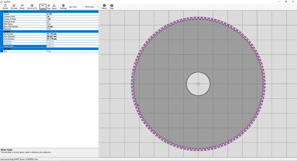

                                                There's a handy little computer program called GearDXF where you can input your MOD/DP/Tooth count etc. and it will output the various dimensions and visualisation:

                                                    thanks for the link to GEARDXF Andrew.
