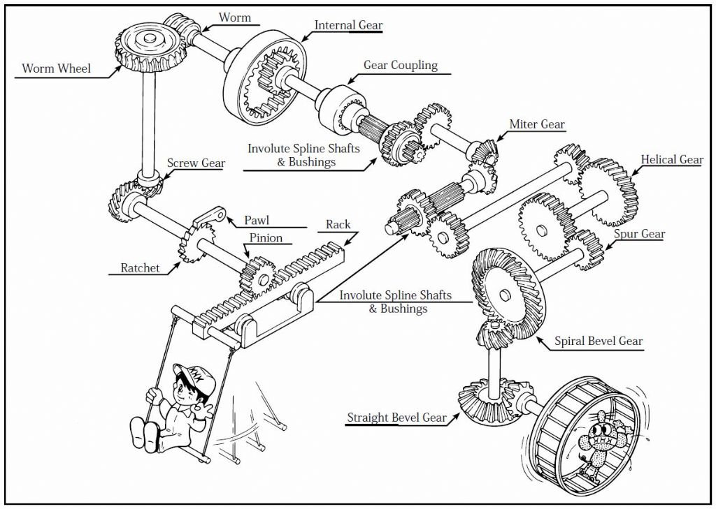

              Edit: I just had to include this litte gem from the'Types of Gears' page in KHK's 'Gear Knowledge'

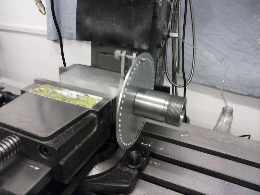

                                                pgk pgk
                                                  @pgkpgk17461
                                                  I made this tool in the past as a simple way of marking a dial when used vertically:
                                                  whether it's robust enough for gear cutting forces is moot (light cuts) but the circle tool on the mill DRO means it's easy to knock out discs of different hole numbers so indexing errors are avoided. It's a DIY er32 holder on the end. Errors would be in resetting cutter height and Y-axis settings plus flex in the system if i have to hang the gear out on a mandrel to get clearance… but a 'tailstock' holder could be added. Actually I wouldn't have a problem with stumping up for a rotary table and discs since that has all sorts of other uses but I see no immediate need to make other gear sets in the future and even then the odds of them being 20DP….
                                                  Buying one rack cutter and having a go has logic if the method can work. Or better still ahving a go at making my own rack cutter. But whether i could manage to make a stacked set identical and successfully harden without distorsion….
