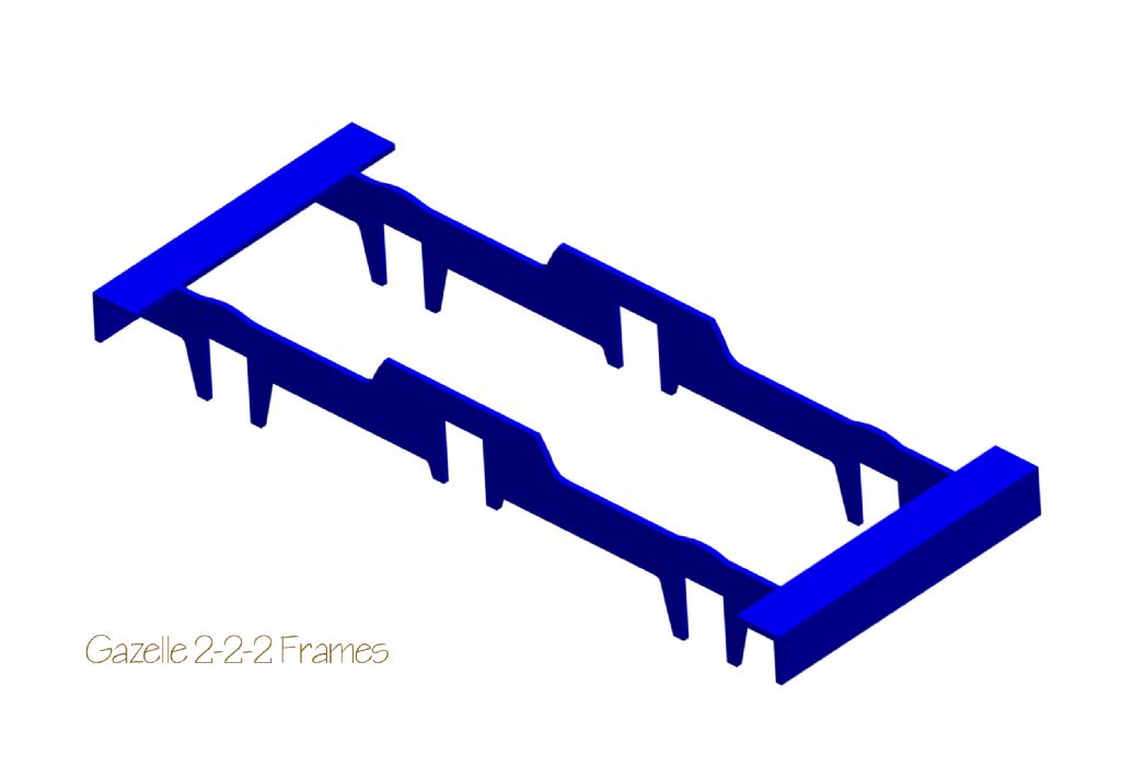

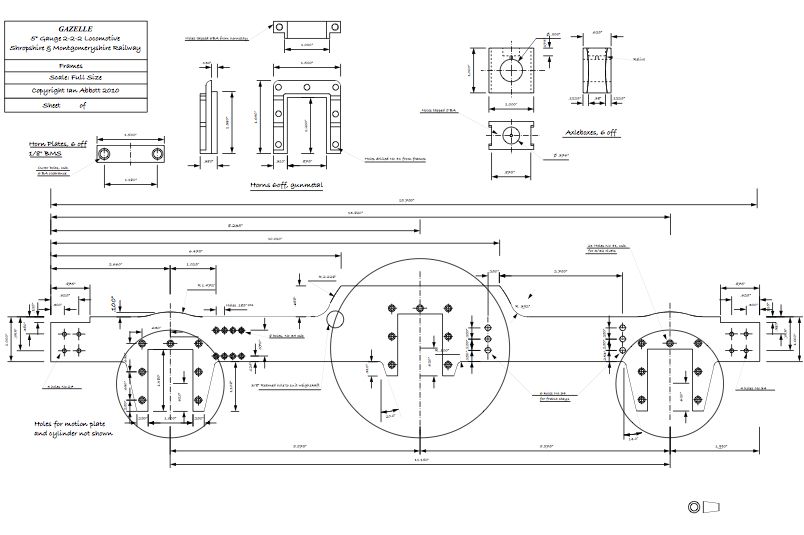

                So, I’ve had several out of print magazine suppliers looking for anything on Gazelle, but there is apparently nothing out there.
                I’m promised a drawing with general outside dimensions, but nothing yet.
                I’ve collected several photographs of Gazelle and from these, the drawings are emerging.
                The wheels are intriguing, with teak fill between the rim and hub.  I’m trying to upload some of the preliminary CAD output, but the site is acting up. The first sheet is the wheel construction. Others are the beginnings of the frames and axles.
                I hope that showing the work in progress might interest a few watchers.
                Ian
                #56228
                Nicholas Farr
                  @nicholasfarr14254
                  Hi Ian, nice drawings, interesting design for a wheel. Were they designed for cost puposes, or some sort of structural integrity?
                  Regards Nick.
                  #56263
                  Ian Abbott
                    @ianabbott31222
                    Hi,
                    Gazelle was built as a sort of executive runabout, the teak wheels were supposed to give a better ride.  I doubt that using hardwood on model wheels would make any noticeable improvement, but building them as on the prototype just seems right.
                    I’m still working out the building process in my head, but they should be within the capabilities of most small lathes.
                    Ian
                    #56407
                    Ian Abbott
                      @ianabbott31222
                      I’ve put up the preliminary frames and horns.  The horns and axleboxes are from the 4F, as they seem to fit nicely in the shallow frames.
                      No positions for the cylinders, motion and brakes yet, until I get more information.
                      Interesting thing, the drive axle is right under the firebox.
                      Buffer beams, stretchers next, then perhaps cylinders and motion.

                        #61408
                        Ian Abbott
                          @ianabbott31222
                          Managed to get back to work on the Gazelle design, the 3D layout of the frames and cylinders look to be almost right.
                          More pictures in the album.
                          Ian

                                          #343160
                                          Ian Abbott
                                            @ianabbott31222
                                            Hi Guys,
                                            I think a quick look underneath would tell you an awful lot, but I didn't manage to get to the museum before they grounded me.
                                            For the pre-rebuild shape, I followed the line of the frames to where they disappear behind the wheels and then drew what would be needed to hang a horn onto. I didn't really think the layout would be strong enough, but considering the weight, or lack of it, on a model there shouldn't be a lot of problems. It's been a while since I've looked at the photographs, but I don't think I saw any bracing between the sides.
                                            It's possible that they could have added a piece to match the leading and trailing horns when they lowered the axle and perhaps added plate to the join. I tried to visualise an extended axlebox, but that, I think, wouldn't work. I'd certainly be interested if anyone come up with some pictures inside the frames, both before and after the re-build.
                                            From what I can see in the photographs, the cylinders seem to be in line with the original axle centre. My problem there though is getting the valve motion to fit. I have no information at all and the photographs show nothing. It could be just a very simple layout, given that the loco wasn't intended for any serious work.
                                            The new smaller wheel apparently is cast using one of the leading or trailing wheels as a pattern.
                                            I'll try to find the photos and add some to the album.
                                            TTFN
                                            Ian

                                                    #343244
                                                    Ian Abbott
                                                      @ianabbott31222
                                                      Worked on the general view a bit today. Projecting for the plan view brings more into focus and emphasises how narrow the firebox must be. The Stephens Museum photos are a great help for where the plans I pulled from on line are lacking.
                                                      For a model I might prefer to keep the cylinders forward 'cos the valve gear is going to be really cramped in 5" gauge.
                                                      On the plan I have, all the measurements are blurred out, so I've imported them into a layer under the draughting layer and set the scale from the gauge under the wheels. This way I can just work across the sheet and put dimensions directly on in 1:1 scale, which could be helpful for Joe.
                                                      Ian
