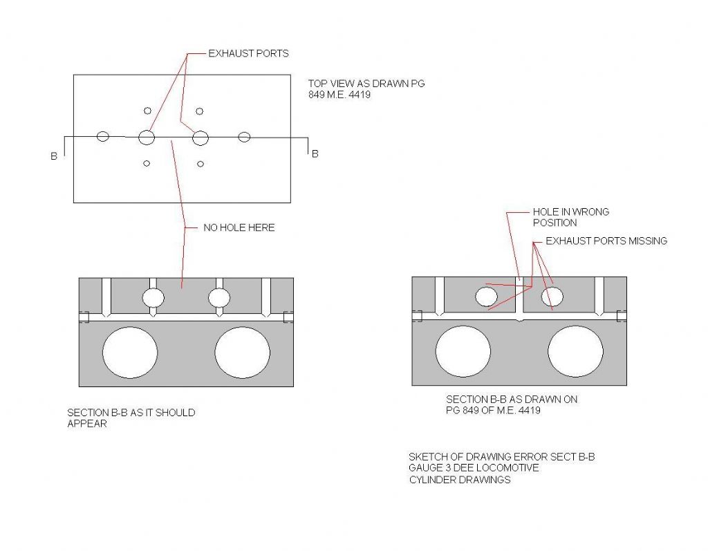

                Hi All,
                Not sure if it has been noted before, but there is an error in section BB of the cylinder dwg on pg 849 of ME 4419 for Dee. A sketch has been posted in my album.
                There should be drilled ports through the centres of the valve bores for exhaust, not a central hole as shown on section BB.
                JDg3 Dee cylinder dwg error
