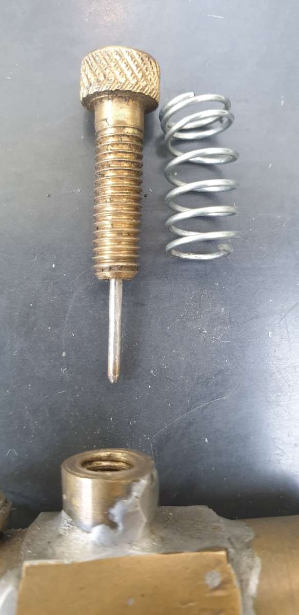

      I would like to make a finely adjustable gas needle valve and would value some pointers as to the design. Its for a small gas engine, Stuart 800.

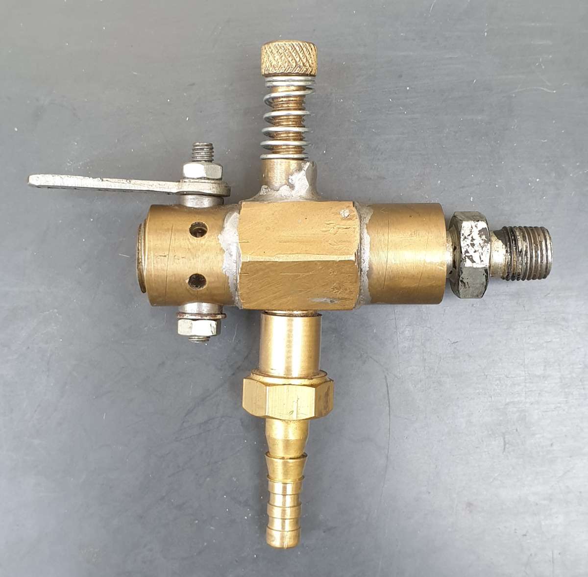

      Needle Valve bNeedle Valve aThe mixer shown borrowed from another project seems to work OK , even if its lacking in its visual refinement.
      In this instance though I only need a needle valve, not a mixer.
      I need a fine thread, BA, BSB or ME no problem.
      Now should the threaded brass part be bottoming out when screwed fully in, or more likely the needle itself??
      In this example the needle is 1.8mm dia, so drill a hole that diameter with a standard drill bit ?, or should the tip of the needle seat into a matching tapered hole?
      Should the needle have a longer taper? Ideal material for this?
      Is this a good basic design, or are there published designs/ sketches available?
      Any help gratefully received.

        I would definitely go for a finer taper than the one in your picture, they are not difficult to make. you cando it in two pieces like the photo by solderinng togetyher or loctite

          IMO, definitely 40 tpi ME for a fine adjustment, and as suggested a slow taper, again to make the adjustment less sensitive.

            The needle point should have a reasonable taper – say about 5-10 degrees incl. – the exact angle is not that important as long as the taper is concentric.  It should bottom out in the hole with the adjuster not quite home on the thread – screw the adjuster fully home, back off 1 -2 threads and push the needle through until it seats – solder the needle in place at that point. If the hole in the adjuster has a deep centre it will allow for a good solder fillet and maximum hold.
            6 – 4BA thread is suitable as is 40tpi but there’s no need for finer

                        Some, used to use old gramaphone needles. A common thread for the needle if made in 1 piece, like the Super Tigre or Rossi needles, uses the M2.5 thread. I think is 0.4mm pitch.
                        The needle insert, or pin can be made from 1mm piano wire or wire size slightly larger than the inlet hole. Then I use a piece of balsa wood as a support block, and use a Dremel to grind the taper on the pin. Anywhere from 5-7 deg per side works really well. I use 5deg mostly. For a Ø1.2 mm needle, it is about 6mm long the taper.
                        A small collet chuck like an ER11 makes them easier to make.
                        On my F2A NVA assemblies, they do not close to zero. That way, the needle taper can not be damaged by the edge of the inlet hole in any way. Damage to the taper seat or to the needle can make it inconsistent for its repositioning.
