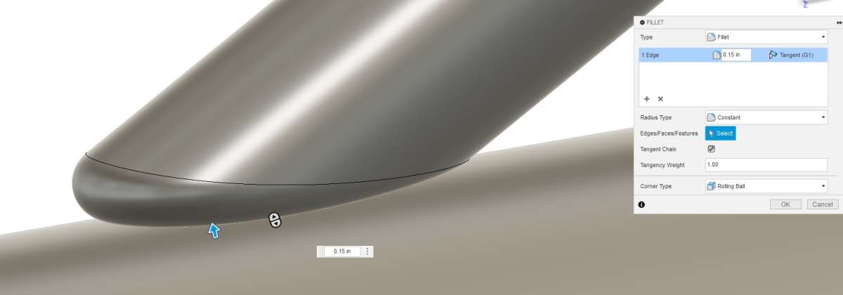

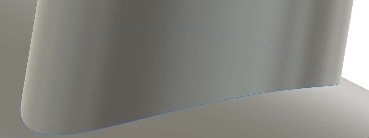

      I am having a spot of bother with Fusion 360 and fillet command.
      I am currently only able to make “subtractive” fillets, when I have a spherical body coming in at an angle to another spherical body; see the 2 screen shots attached. I see in videos and screenshots users making fillets more suitable for e.g. a pattern. I have tried different approaches of extruding the second spherical body into the main body. I must be missing something.
      Any tips?

      Swarf Maker
        @swarfmaker85383
        Hi Steve.  The reason is that you still have seperate bodies.  Join them together first and then the fillet will work as you expect.  At the moment you are just filleting the end of your upper body and that can only produce the result that you show.

        SteveI
          @stevei
          Hi Swarf Maker,
          Thanks! That certainly allows the type of fillet I want. It has been a habit of mine to simple create new bodies until I am finished with the designing.

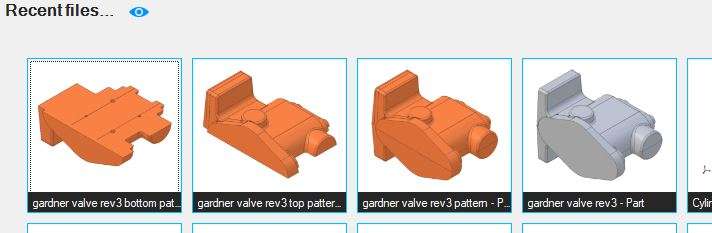

              I often fillet as I go along but model patterns and anything else as one single body so would have only got an internal fillet in a case like that.
              Fillets can be tricky with most CAD programs, F360 seems to be able to do the odd one that Alibre gets tripped up by but can often be got around by changing the order fillets are applied in or adding a small radius one and then increasing it’s radius. The more complex the joining profiles the harder it can be. This patter n was quite hard to get all the fillets where they were needed and as it is for 3D printing it is not possible to leave them out and let the CNC’s ball ended cutter leave the fillets.
