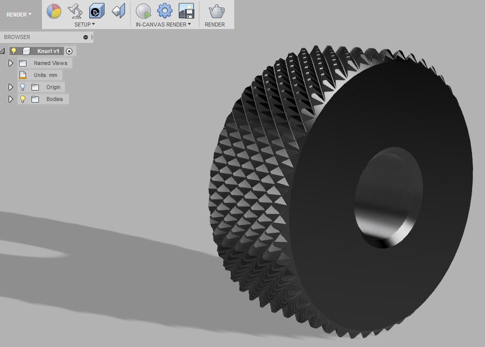

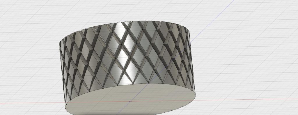

        Drawing (geddit?) on web advice I've managed to model an acceptable knurl with Fusion 360. It's been a challenge!
        The knurl was achieved as follows:

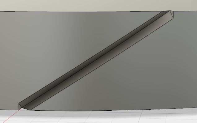

        1. In Sketch, Draw Circle and Pull to create a cylinder
        2. Construct a Tangent Plane on the side of the cylinder
        3. Sketch a line tilted 30 degrees from vertical on the tangent plane.
        4. Use Sketch, Project/Include, Project to Surface to move the 30degree line on to the side face of the cylinder
        5. Use Sketch line to draw an isosceles triangle on the top face of the cylinder. The triangle is centered on the top end of the projected 30 degree line. One corner is inside the cylinder, the others outside.
        6. Use Sketch line to draw another isosceles triangle on the bottom face of the cylinder. The triangle is centered on the bottom end of the projected 30 degree line, one corner inside the cylinder as above.
        7. Create Loft (in cut mode) by selecting both top and bottom triangles.
        8. Create a Mirror of the cut on the other side of the cylinder.
        9. Use Create Pattern, Circular Pattern to copy one of the cuts 26 times around the cylinder.
        10. Use Create Pattern, Circular Pattern to copy the other cut 26 times around the cylinder.
        The intersecting cuts result in the knurl pictured, which I think acceptable and capable of improvement.

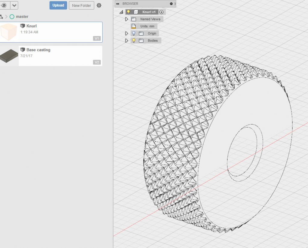

        My problem is how long it takes Fusion to complete the last action, step 10. On my laptop it takes a good few minutes with the cooling fan going full blast. Presumably, the computer does some serious number crunching to calculate and display the result of all those intersecting cuts. The time taken would be excessive if I modelled anything with several knurled nuts in it, especially if real threads were modelled as well.
        Can anyone suggest a way of speeding this up, perhaps using a different technique?
        Thanks,

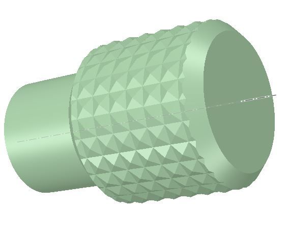

                      That took a bit longer than expected… I had to resort to plan B.
                      Edited By Neil Wyatt on 21/07/2017 21:03:29
                      #308160

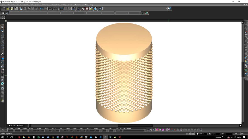

                        Very impressive Neil! Pretty good for Plan B: I'm long past Plan Z. I see it's TurboCAD but how did you do it?
                        #308168

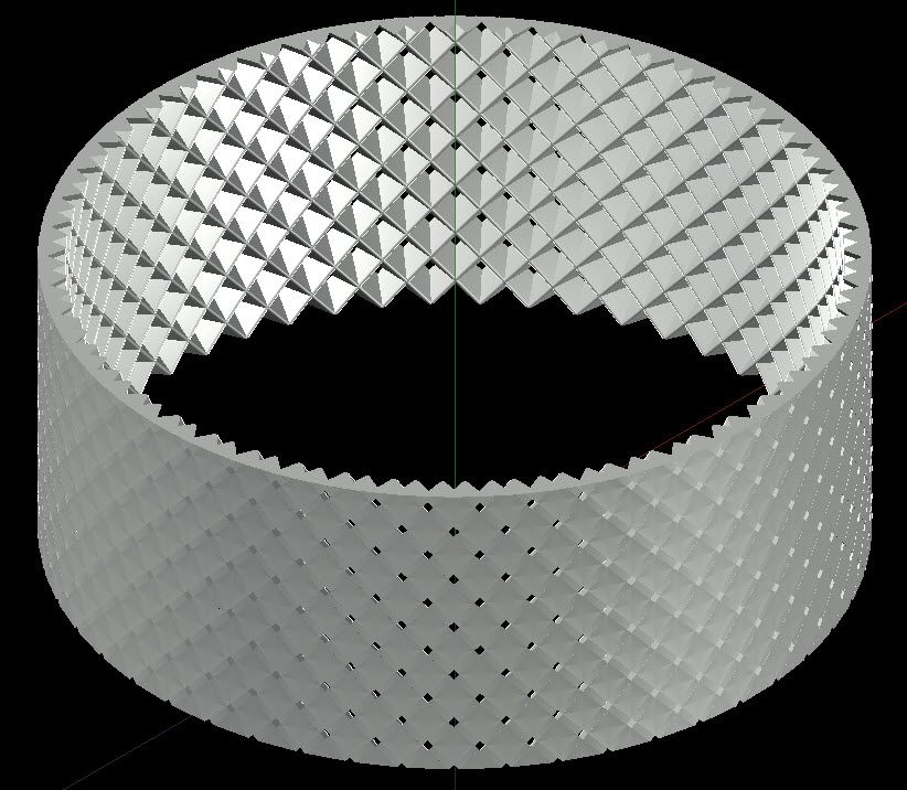

                          kept getting 'degenerated' solids when i tried to combine spirals, let alone when I tried to subtract them from a cylinder (plan a).
                          Plan B:
                          Draw a cube.
                          Crop bits off it to make a 45 degree pyramid.
                          Stretch it a bit to make a diamond, the knack is getting the diamond in proportion.
                          Flip a copy and place one either side of the cylinder.
                          Select both (their 'barycentre' should be at the middle of the cylinder, if not move them)
                          Copy in place & rotate 90 degrees. You have four diamonds at 90 degrees to each other.
                          Work out how many it takes to fill 90 degrees by experiment/inspection, in my case 10 gave a small overlap.
                          So copy the four in place, rotate 9 degrees, repeat this nine times in all.
                          Copy the whole ring of diamonds, displace upwards by the half the height of the ring and rotate 4.5 degrees
                          Copy both rings and displace by the height of one ring, repeat until you have a decent band of knurl.
                          I cheated and did not actually fuse the thing into a single part, although this should work as no fancy curves.
                          Of course, there are no 'half diamonds' top and bottom, for perfection you could cut the top and bottom row off easily enough.

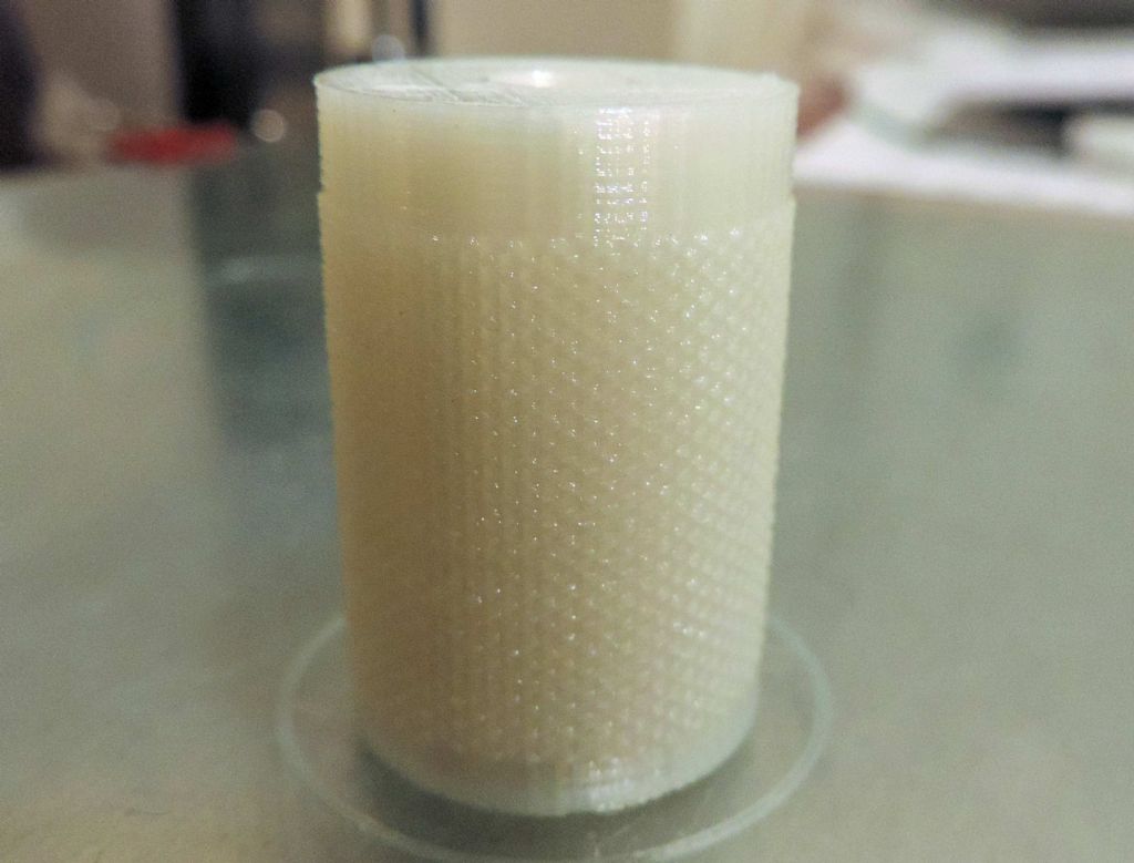

                          Now I'm 3D printing one with a 1/4" hole for a potentiometer shaft. It's working nicely but the knurl is a bit fine.

                              Well I'm a silly billy, I could have made the diamonds twice the size, they are tiny!
                              Lets the printer show its capabilities though.

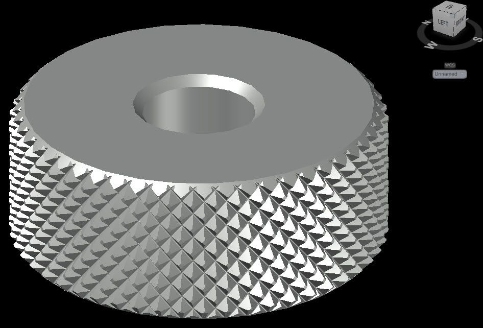

                                          Hmm How would I do it with Autocad? I can export Acad solids to Fusion
                                          OK Here is what I did
                                          Drew a 20mm diameter circle centered on 0,0,0
                                          Drew a helix 100 mm high 10mm radius, it will be cut down later
                                          Set the helix to a quarter turn and payed with the height to generate about 45 degrees by eye, The math guys in here can work it out exactly if they like!
                                          I then extruded a triangle (Pointing in to the center) along the helix to make a single solid of a cut line. I then put a small fillet on the solid to create a root for the cut. I could have done that on the crude triangle it does not matter.
                                          Made an array of the solids spaced by eye to give a flat top on the finished knurl
                                          The above will create a single angle knurl.
                                          For a diamond knurl I mirrored the existing array then superimposed it on the first one creating diamonds.
                                          Then exploded the arrays and trimmed the height to 8mm by subtracting a solid from the top and the bottom.
                                          (Only explode an array of solids once or you will end up with useless lines that will not subtract from another solid)
                                          See image below. (The cutter is made)
                                          Next I made a plain cylinder put a hole in it and placed that centered within the cutter.
                                          We are ready to cut!
                                          The cut took a lot of time about 15 minutes! The processor was running at 100% So many points to resolve, Normally cutting a single solid takes about one second.
                                          Finally I created the chamfers by revolving a shape then using it to cut away the corner
                                          Done!

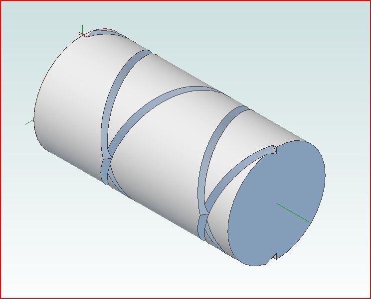

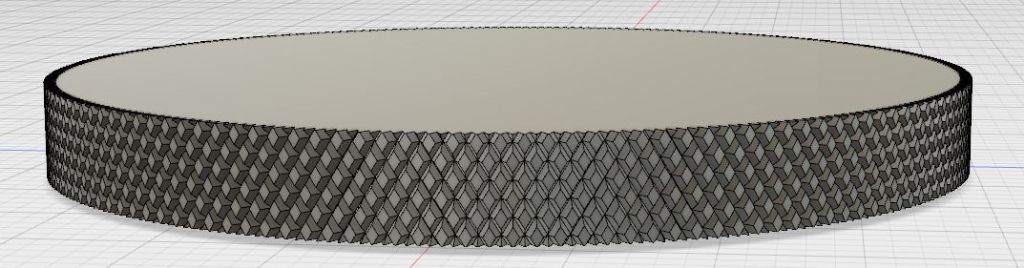

                                                As promised, Recipe for Fusion 360 knurling using a coil.
                                                Here the cylinder is centred on the origin. If anywhere else, you will need to create an additional axis and mirror plane.
                                                The extra circular sketch is to ensure the coil cuts fully through both ends of the cylinder. The second picture shows what happens if the coil is the same length as the cylinder.
                                                Create Sketch
                                                Sketch Circle (centred on origin)
                                                Extrude circle into cyclinder (Example below is 20x2mm)
                                                Construct Offset Plane parallel to and slightly below the lower face of the cylinder
                                                On the new plane, sketch the same circle as before
                                                Using that new sketch, create coil:
                                                – Diameter: Same as circle
                                                – Type: Revolution and Height
                                                – Revolutions: 0.03 in the example
                                                – Height: Negative, sufficient to cut to past end of the cylinder
                                                – Section: Triangular (internal)
                                                – Section Position: On Centre or Inside
                                                – Section Size: Reduce to something suitable
                                                – Operation: Cut
                                                Create Mirror:
                                                – Pattern Type: Faces
                                                – Objects: BOTH faces of the previous cut
                                                – Mirror Plane: Should appear for selection
                                                Create Circular Pattern:
                                                – Objects: ALL FOUR faces of the two previous cuts
                                                – Axis: Through cylinder
                                                – Type: Full
                                                – Suppress: Cleared
                                                – Quantity: 150 in the example

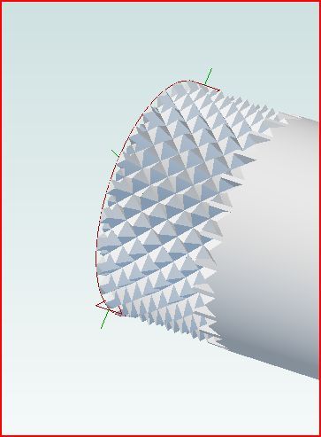

                                                    Here is some some knurling done in Design Spark Mechanical. This is a free program based on Space Claim. It's limited in the file types that it can import/export, but I find it easier to use than Fusion 360.
                                                    #308420
                                                    Raglan Littlejohn
                                                      @raglanlittlejohn
                                                      I just realised the knurls should be in a spiral. Will have another go.
