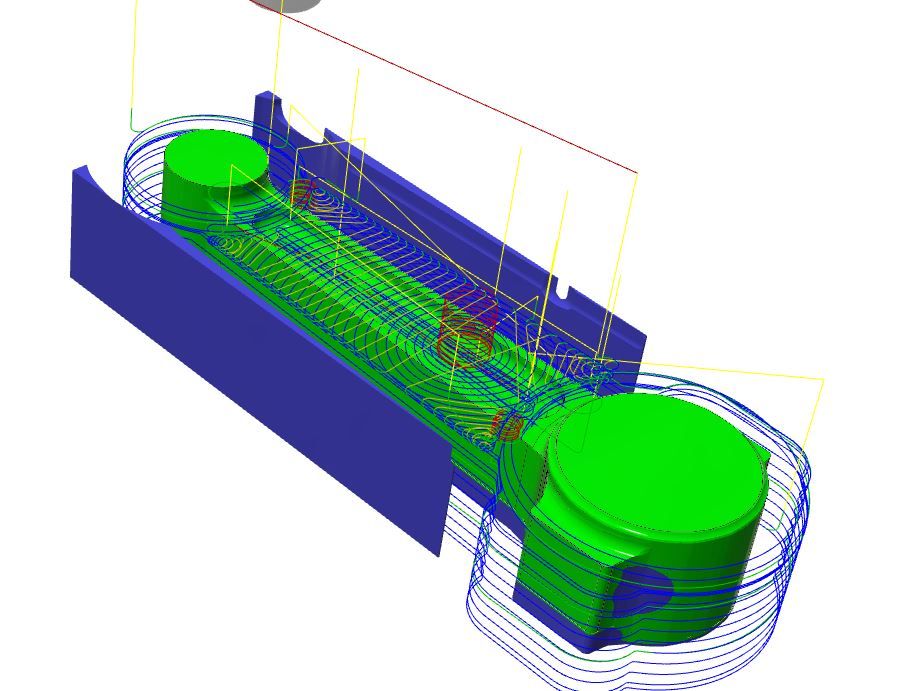

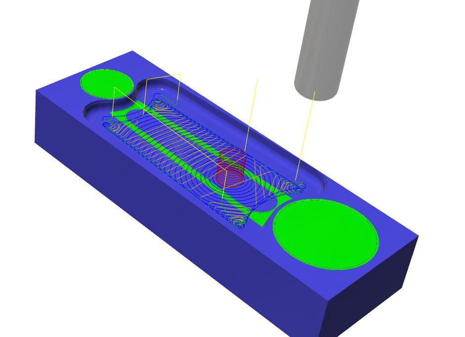

                  Today we have a Conrod which may be of interest to roderick.
                  2014 (HE15) aluminium, I made up the two parts on the manual mill, screwed them together with sacrificial brass screws and then popped in the two holes and while I was at it made a plate to hold it on for machining.
                  3D profile done with a 4 flute 6mm dia cutter with 1mm corner radius so no stress risers at 5000rpm, modest feed of 300mm/min. Then change to a 4mm cutter again with teh 1mm radius to do the recess in the middle. 12mins plus 2mins for the other side.

                  Ian Johnson 1
                    @ianjohnson1
                    Cool! Great video thanks for sharing.
                    I like those cutters with the radius, seems to leave a better surface finish, and last a bit longer than the normal sharp edge cutters.
                    Looking at the tool paths, they seem a bit weird to me (I use VCarve) It machines the two diameters then plunges straight down the middle! Not sure if VCarve would do a tool path like that on a similar job.
                    Will you be using bushes and split bearings for the small and big ends?
                    Ian
                    #427684
                      Hi Ian, yes it's a sudden move and one of the reasons I was using that feed.
                      I was having a job getting Fusion 360 to cut in the way I wanted which was to do the outside profile in two 5mm high cuts with a flat bottomed cutter and then the details with a round corner. So as I could not do this I first did a horizontal cut to reduce the height of the central rod as shown below – green is a finished surface of the part and mauve the stock
                      The problem was that when it cam to run that in Mach3 the machine kept stopping on the same line with "internal movement error" and I could not get rid of that so opted to leave that out, had it run then that move about 1.25 into the video would have not been very deep.
                      Another problem with not being able to get it to do the 2D contour was that some waste was left down the sides as the 3D contour does not work its way in so I milled that away first manually so there were not loose bits of waste flying about that may have got between cutter and work. That notch in the mauve on the far side also triggered a crash warning so another good reason to cut away the waste.
                      I doubt it is the program just me not being able to set it up correctly.
                      The dural should run OK as it is without bearings, quite common on small IC engines.
                      Edited By JasonB on 05/09/2019 20:14:03

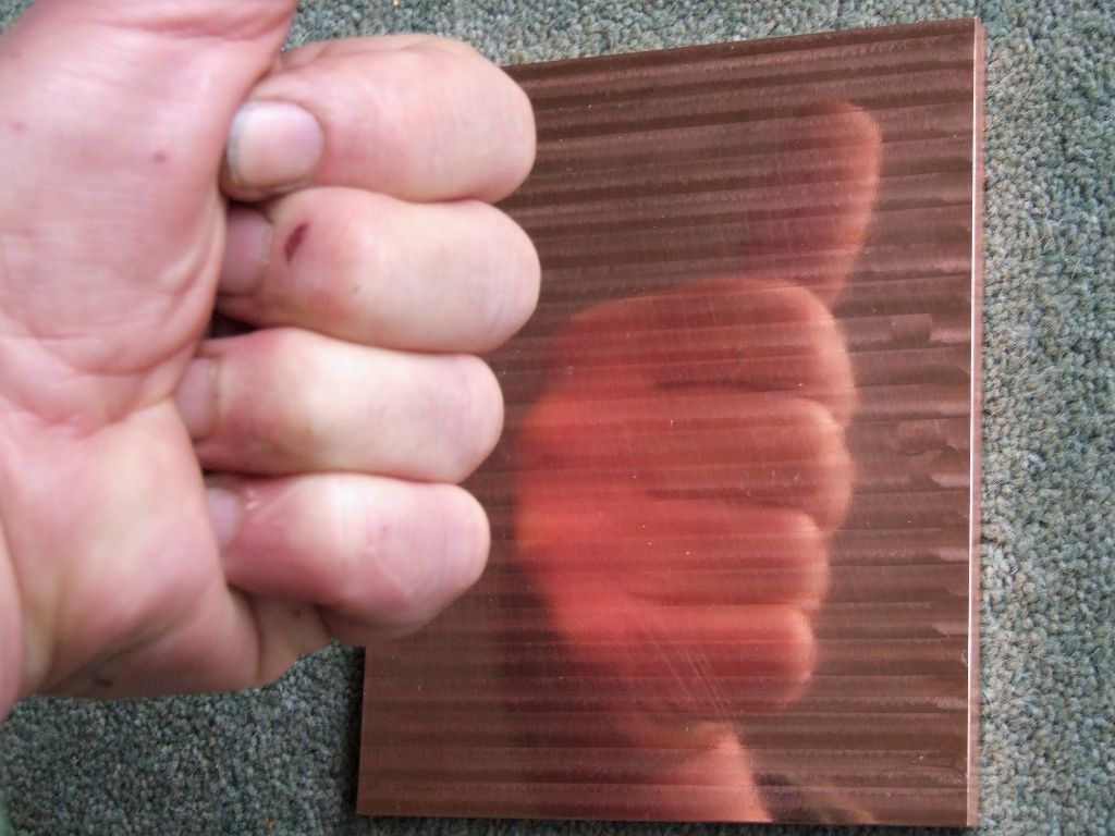

                      Anonymous
                        Posted by Ian Johnson 1 on 05/09/2019 19:43:33:
                        Good, but expensive. If one is primarily cutting on the side, as you should be, then the radiused end doesn't really matter. But they are very good for leaving an excellent finish. I use them for heatsinks where good heat transfer is needed. Like this copper heatsink for an experimental inverter (essentially a VFD) using silicon carbide semiconductors::
                        And of course if you need to leave a small radius on a profile they're much more robust than a small ballnose cutter.
                        Andrew
                        #427694
                        Ian Johnson 1
                          @ianjohnson1
                          Posted by JasonB on 05/09/2019 20:11:30:
                          Thanks Jason that makes sense. Early on while learning the Vectric programming I had a similar problem machining a small crank with a raised boss, very like your con rod small end, I ended up programming the boss diameter over-size to get down to correct depth, because my brain couldn't suss out how to do it any other way. I'm a bit cleverer now though!
                          Ian
                            Andrew
                            That's an impressive finish on copper Andrew. How did you hold it down? Double sided sticky tape, superglue or something?
                            Ian
                            #427766
                            Anonymous
                              Posted by Ian Johnson 1 on 05/09/2019 22:16:38:
                              It was quite a thick plate. about 3/8", so I held it in the machine vice on parallels. Can't remember exactly what the final thickness varistion was, but probably less than a couple of thou.
                              Andrew
