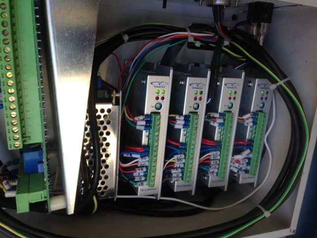

        OK the drivers are different so preferably need photos of Mick's machine control box. The Yako drives have a rotary switch to set current.

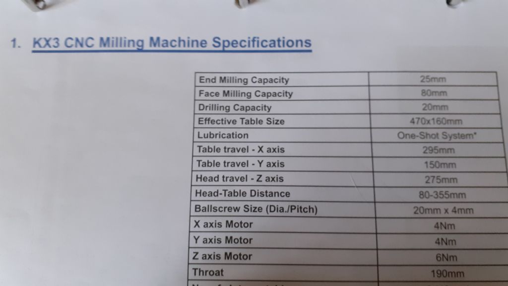

          As was suggested somewhere I would consider swapping the X & Y steppers over which should show up if it is the stepper that is at fault assuming they are the same.
          Does your manual not give the torque for the steppers? Mine gives X&Y as 4Nm and Z as 6Nm for the KX3

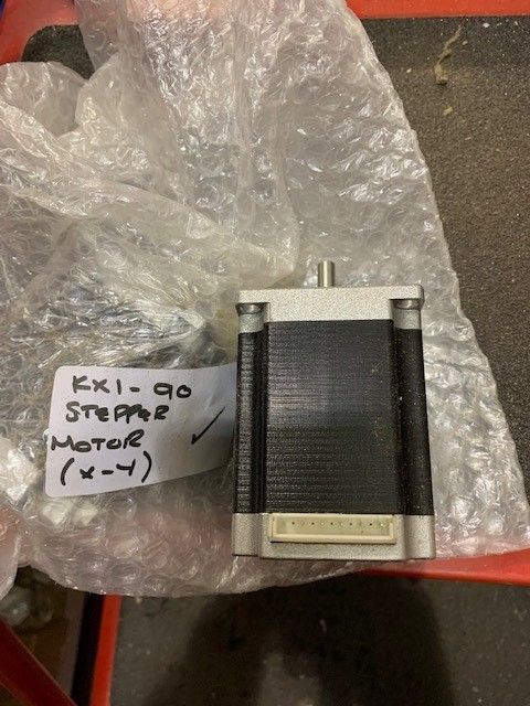

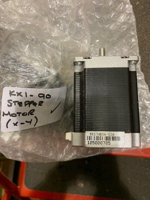

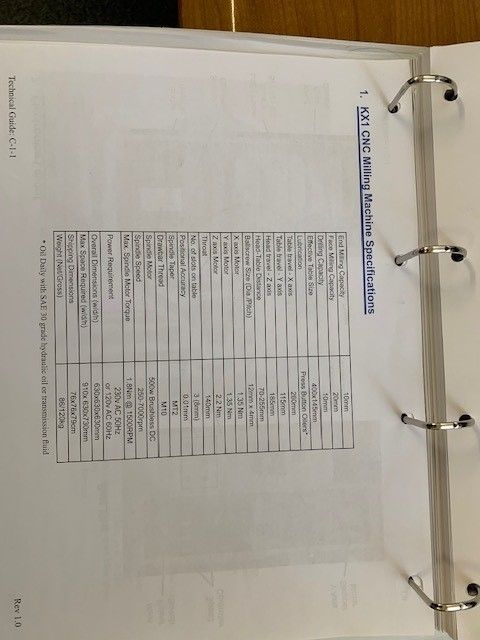

                    From the KX1 Manual put together by John Stevenson, Adam Stevenson and Alan Simmonds in 2008:
                    X & Y axis 1.35 Nm each, Z axis 2.2 Nm

                    • the KX1 machine which Adam Stevenson currently has, has different drivers, breakout and control board from the ones used in 2008/2009.
                    • The user may need to look at all the electrical connections to confirm non have become loose over time, or become loose due to some adverse event.
                    • Check the connections and operations of the micro switches,
                    • check if the ball screw has not got contaminated, but to remove the screw and nut from the screw a specific procedure needs to be followed to avoid balls falling out of the nut- see You Tube videos (50% good/50% crap). Just winding by hand from the end does not prove that the ball screw is okay. contamination/swarf can move randomly, an observation which has been made in the past.
                    • the existing stepper motors as they stand (if they have not developed a fault) have enough torque to run the axis in question. To check if it is faulty/cause of the bind, one needs to disconnect it from the axis ball screw which is effected. (As I did not get involved in this dismantling process, I cannot guide.). Once disconnected from the ball screw, run it to see if it is okay. The stepper motor should/will be connected to the ball screw with an oldham coupling and/or similar. Most KXs made for supply through ARC at the time had be requested with such couplings.

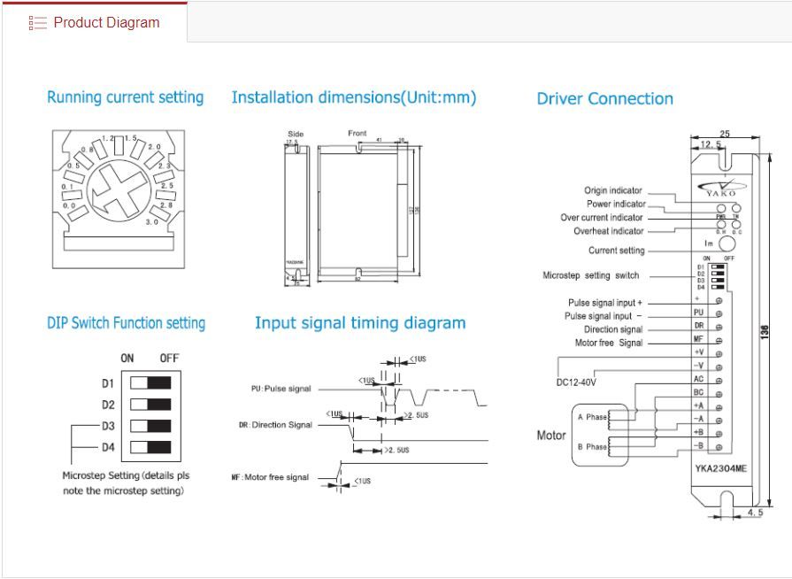

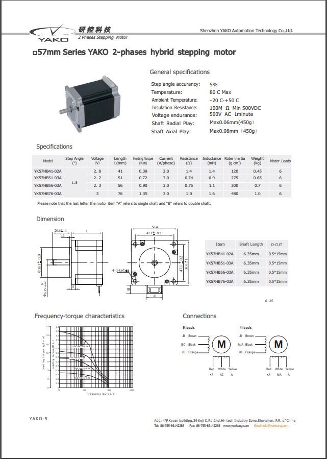

                        Here is a summary datasheet for the motor.
                        It's the third one down in the shaded table. Torque 0.9Nm at 3A per phase. Shaft diameter 6.35mm if it isn't clear in the picture.
                        From Ketan's pictures the drives look as if they are the same as in the KX3, which would be logical as I guess you wouldn't want to have two designs. If they are the current is set by a screwdriver-operated control just below the screw terminal strip.
                        The top left diagram shows the switch in close-up, from looking at its setting you can see what the current is set to at the moment. With this drive the maximum setting is 3 amps. This is the YKA2304ME, an alternative the YKA2404MA/B can supply 4A/phase. If the current setting is close to these maxima the scope for an experiment to increase the current is limited.  Interesting that the manufacturer torque rating for the motor is less than what Ketan quoted.

                          Though looking at Ketan's photos it looks a longer motor, more the size of the next one down the list which is 76mm long compared with the mount @56.4mm sq so could be the 1.35Kn even though the label says it's 56mm long

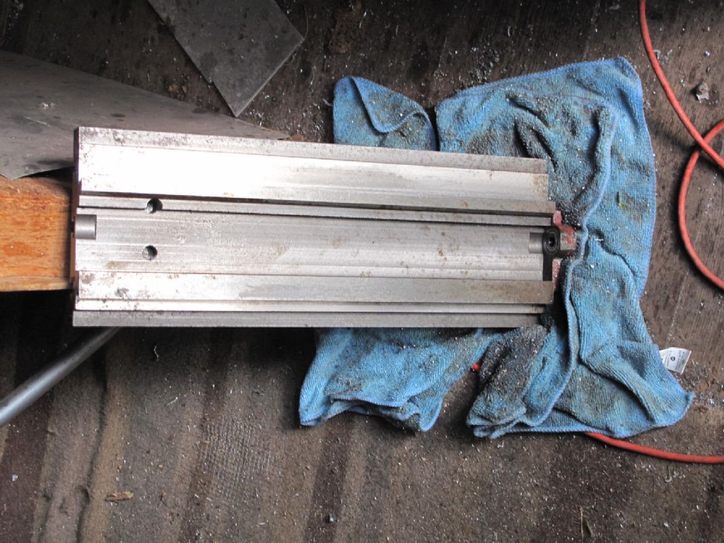

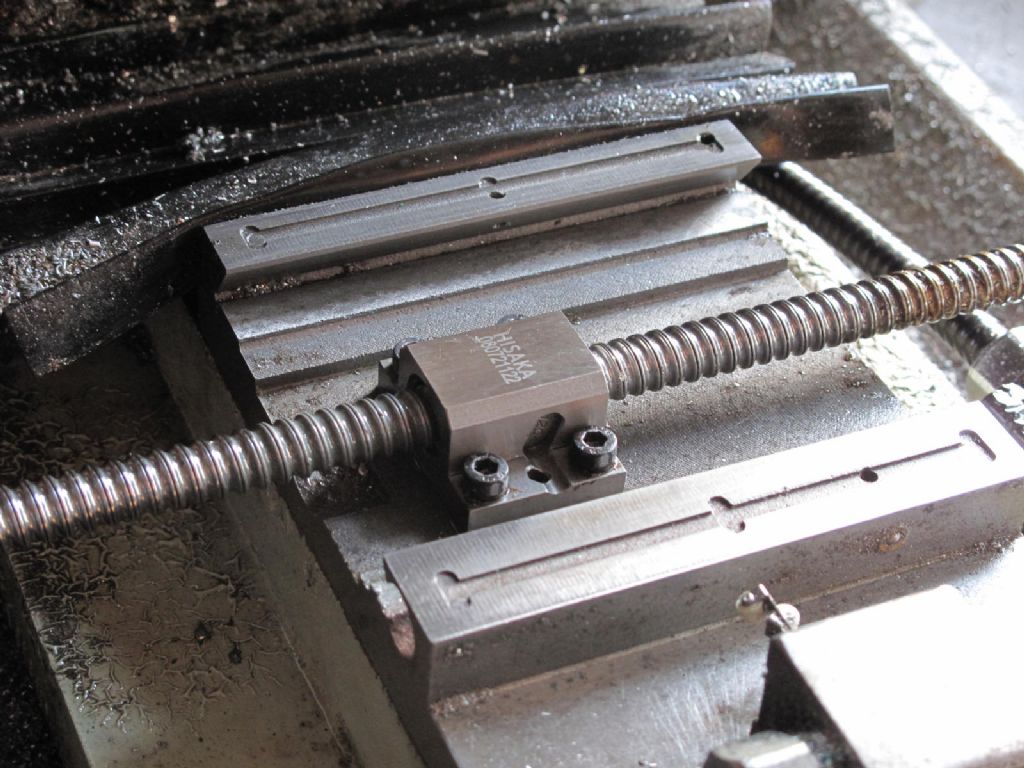

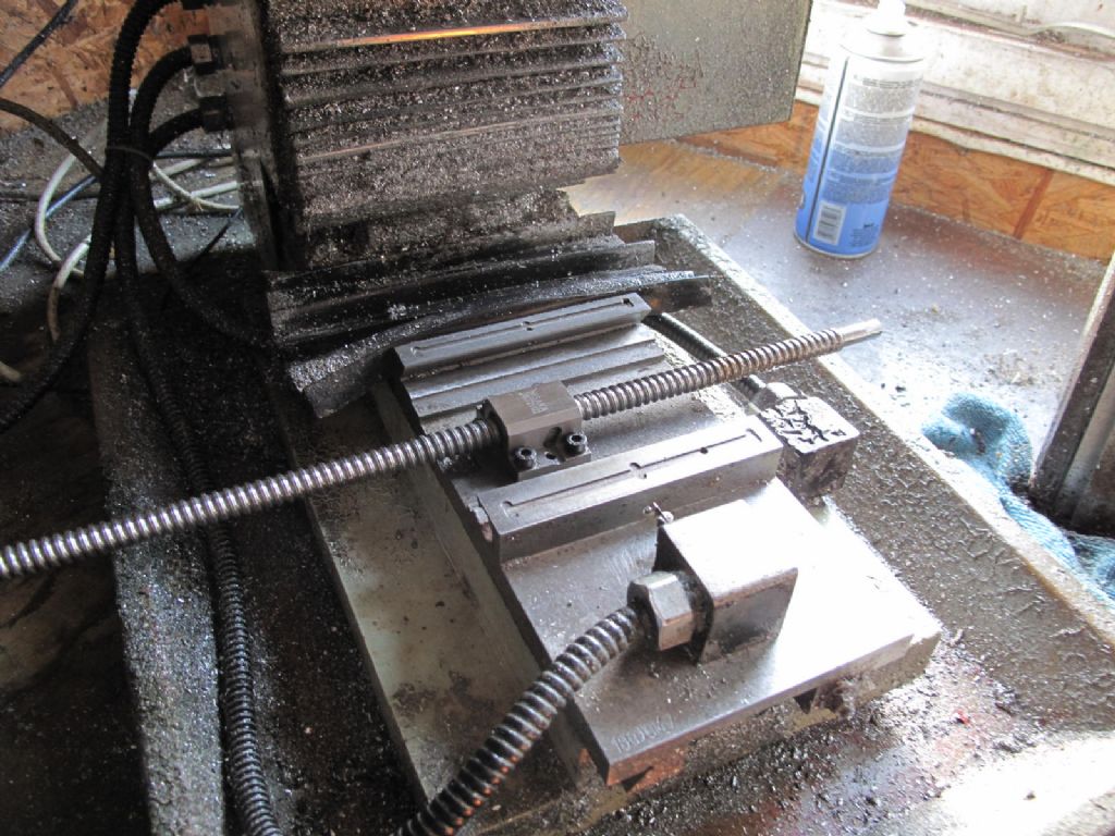

                              kx3.jpgkx2.jpgHello again. This morning I removed the stepper motor when it became clear how to remove the slide, which I did and totally cleaned all slideways and the ball screw. I coated the ball screw in Moly lub and worked the screw back and forth to get all the balls coated, at this point the ball screw moved freely. With all the slide ways coated with slide way lub I re-assembled the slide, introduced the gib and adjusted until the slide moved freely to both limits with only light hand pressure. When the ball screw was re-introduced the slide became stiff and would even jog across the 100mm area it did before. the stepper works when away from the machine. Options are narrowing.kx1.jpg

                                Does the slide run free with the ball screw installed and "back drive" (i.e. push the slide and the screw rotates)?
                                But it sounds like something is misaligned when you couple the motor up. Dismantle, clean and re-lube the Oldham coupling?

                                  Oldham couplings (not flexi-couplings) are designed to deal with mis-alignment, and do not introduce any stress on the motor or the ball screw. Usually they do not need lubrication. There is an acetyl disc in between the couplers.
                                  Difficult to figure out what mechanical issue is causing the bind.

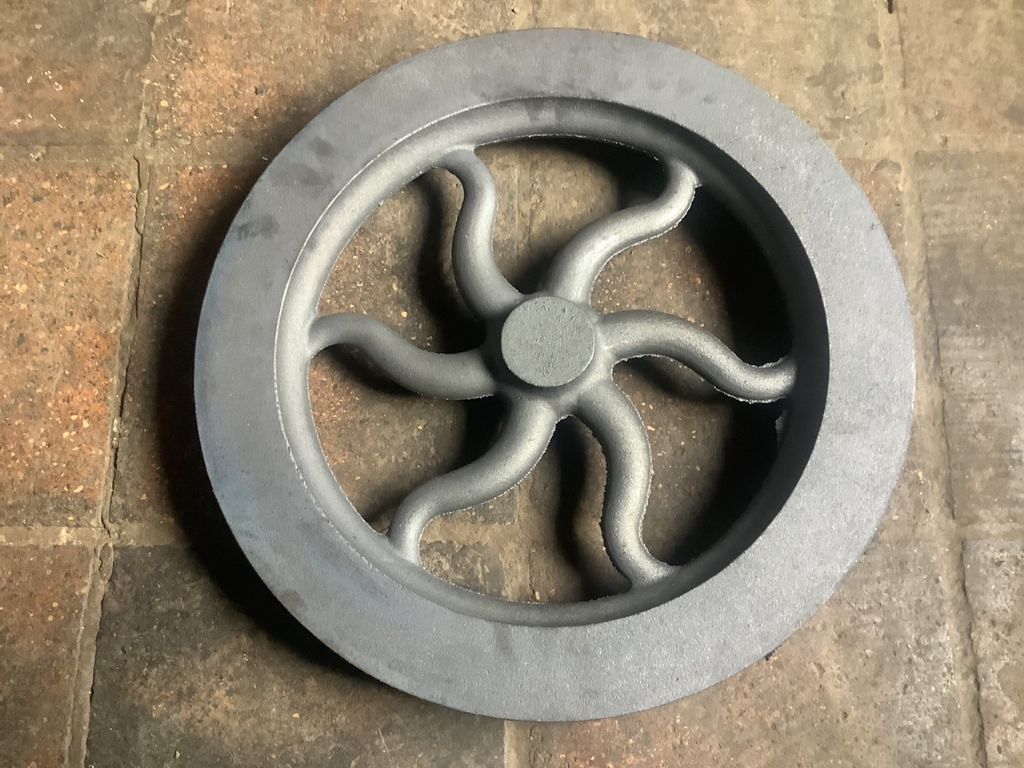

                                    Hardly seems like 15 months ago I was posting about making a flywheel pattern here. Well I've just seen a photo of the fruits of my labours.
                                    20kg of iron and 15" dia
