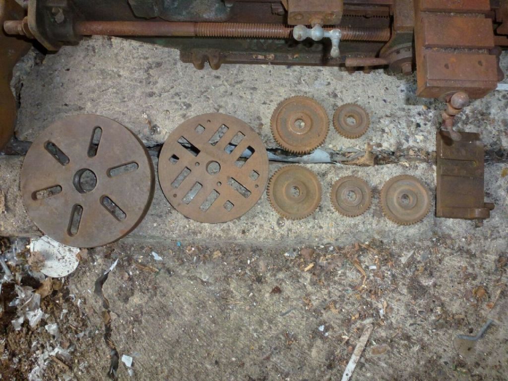

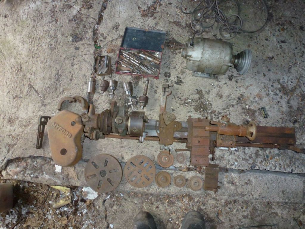

      JohnM
        @johnm51917
        Sure that the seller dug this one up from his back garden. It looks in such a sorry state but I'm determined to give this a whole new lease of life.I will be working day and night to bring it back to as near to original as I can. Please check back often as I will be posting my progress as I go. Already getting some great help on these forums.

        #403360
        Nigel Graham 2
          @nigelgraham2
          I'm sure we all look forwards to seeing the poor old thing back as it should be!
          It's noticeably far worse from saddle to tail end – under a leaking roof?
          The right-hand faceplate looks Drummond-pattern though the Myford name's clear on the guard.
          The four small holes in that – and those two in the cross-slide – look as if user-drilled to hold specific work-pieces or accessories, but overall it does look as if that user was a careful one – no obvious "oops" grooves in the faceplates, or missing teeth visible in the headstock wheels.

            #403457
            Hopper
              @hopper
              Looks like it was possibly a woodwoorker's lathe with the motor belted straight to the lathe spindle pulley with no countershaft, making rpm too high for most metalworking. Holes in the cross slide possibly then for a woodworker's tool rest.
              Looks like you have a job there for sure. But if the half of the bed towards the headstock is not too bad you should be able to make something useable out of it. Surprising what these old lathes can be nursed into doing. Beware though: vintage machine tool restoration can turn into a hobby of its own!
              Edited By Hopper on 04/04/2019 00:33:50

                      #403506
                      JohnM
                        @johnm51917

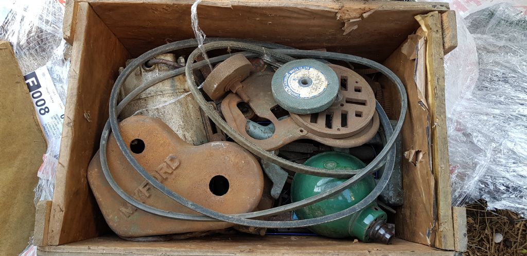

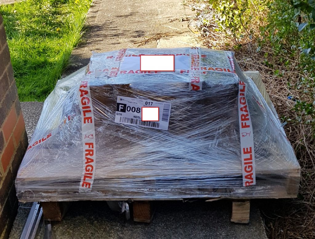

                        So starting here, I came home to find this parked in my front pathway and set about unpacking like a little boy with a new toy.
                        I always find there are a few little bonuses when you buy second hand and already noticed an old Lathe lamp in the box.Possible up-cycle for some posh architect auction sale in the future.
                        horror of horrors one of the Chuck teeth is missing! After a call to the seller it was found on the floor of the delivery van and posted to me by the courier. I was worried it would be swept out but it all turned out well in the end on that part.

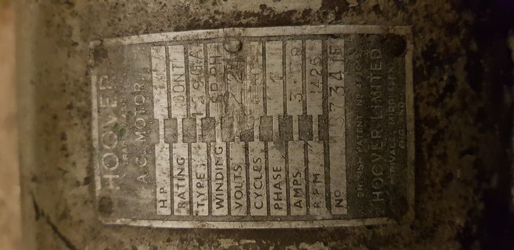

                        20190328_230949.jpg Hoover motor ,checked out okay and very quiet despite looking very tired. will probably run forever though.

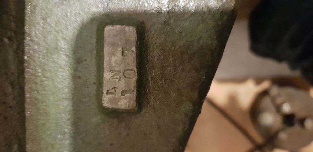

                        There are no serial numbers I can find online for any of the early Myford Lathes. I noticed that there are some newly found documents that are being sifted through and will be posted when scanned and sorted.

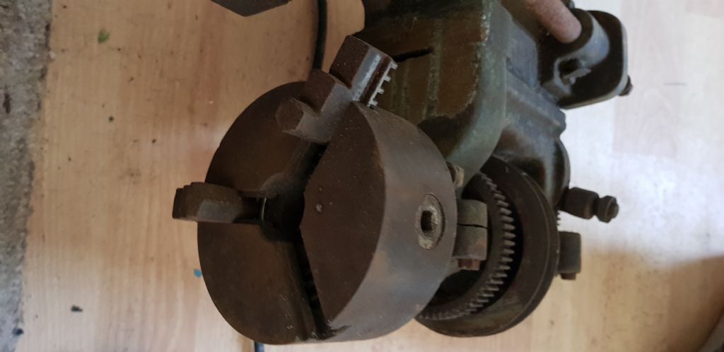

                        #403511
                        JohnM
                          @johnm51917

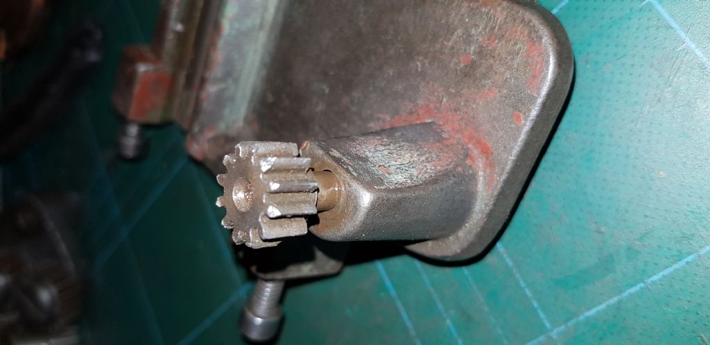

                          More broken or damaged teeth found. This is sitting on the screw thread and is attached to the saddle. Hopefully using the correct terminology here. Should I be worried?
                          #403520
                          JohnM
                            @johnm51917
                            Should I Heat? Beat? or Replace? If only I had a Lathe to make one or two! hahaha
                            #403526
                            Georgineer
                              @georgineer
                              Some simple measurements and observations can identify which of the different models ML1 to ML4 one is faced with:
                              ML1 & 2: 3 1/8" centre height, 15" between centres, 3 1/2" cross slide travel.
                              ML3 & 4: 3 1/2" centre height, 24" between centres, 4 1/2" cross slide travel.
                              ML1 & 3 ('Standard' models): Spindle bearings direct in headstock.
                              ML2 & 4 ('Superior' models): Bronze spindle bearings, shrouded ball thrust race.
                              My understanding from lathes.co.uk is that the cast-in headstock was abandoned in 1937, so from then until the ML1 and ML3 went out of production in 1941, all models had the removable headstock.
                              George

                                #403531
                                Hopper
                                  @hopper
                                  I would heat that handle up red and bend back straight. I've made a few similar for the old M-type using a ball turning tool. Stick the toolbit forward past the pivot point to turn the convex curve. You'll be able to do that once you get her up and running.

                                    Posted by Brian Wood on 04/04/2019 09:35:38:
                                    The ML2 spindles had 3/4 inch x 9 tpi Whitworth nose thread, yours matches those dims
                                    Brian
                                    The presence of a serial number, the latest type of changewheel guard, the proportions of the bed and the tumbler reverse makes me think that you have a late model ML4.
                                    If so, I would expect the spindle nose thread to be 1 1/8" x 12 tpi, Whitworth form. The only difference between this spindle nose and the later ML7 is that the register (the plain bit at the left-hand end of the thread) is the same diameter as the thread, whereas the ML7 has a 1 1/4" diameter register. ML7 accessories will fit, but with limited accuracy. For full accuracy you would need to fit an accurately turned collar to enlarge the register to 1 1/4"
                                    Earlier ML1-2-3-4s had 7/8" diameter threads with either 9 or 12 tpi and a 7/8" register. I have never discovered whether this was model specific or at the choice of the purchaser. That said, my ML4 has a 7/8" BSF thread (11 tpi) on a non-myford spindle, so there are oddities to be found.
                                    George

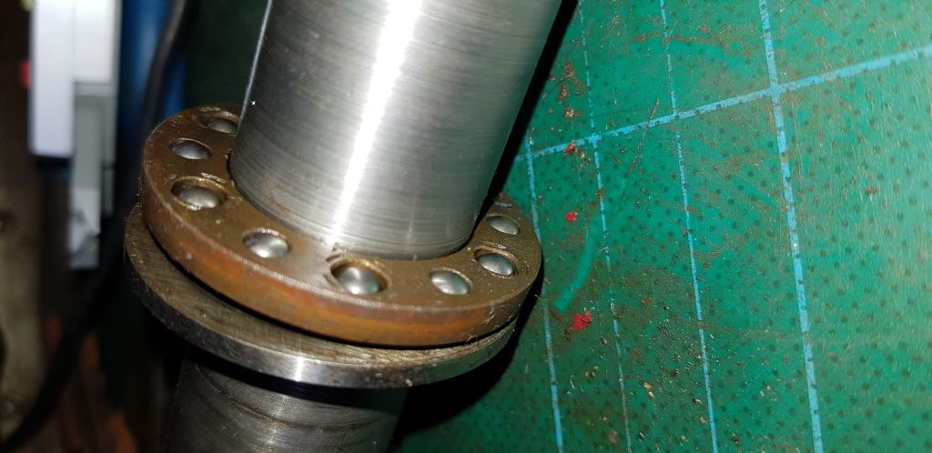

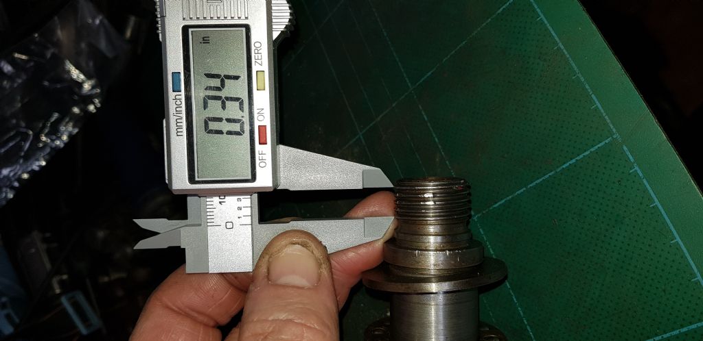

                                          I have a cheap digital caliper if that would help in the measuring and identification? All in bits now so no problem. I appreciate all the help and just glad to have a unique Lathe possibly an ML4 1/2
                                          #403544
                                          JohnM
                                            @johnm51917
                                            Any help?

                                              @johnm51917
                                              #403546
                                              JohnF
                                                @johnf59703
                                                "More broken or damaged teeth found. This is sitting on the screw thread and is attached to the saddle. Hopefully using the correct terminology here. Should I be worried?"
                                                John M, not 100% sure but that looks like the drive gear that connects to the rack ? not the lead screw ? Difficult to be completely sure but it looks to me as though it should clean up and work OK.

                                                #403554
                                                Nicholas Farr
                                                  @nicholasfarr14254
                                                  Posted by John Milton 2 on 04/04/2019 12:37:19:
                                                  Any help?
                                                  Hi, by my reckoning, it is 12 T.P.I.
                                                  Regards Nick.

                                                    Georgineer
                                                      @georgineer
                                                      John,
                                                      Yes , a very helpful view. Taking 0.34" for four threads, I agree with Nick that it's 12 tpi. Scaling the view from that, I get very close to 1 1/8" for the register diameter. The thread diameter should be a little less than that to give a slightly slack fit. This allows the register to align screw-on accessories accurately. The register should be a very accurate 1.125" with no lumps or bumps or burrs.
                                                      The lathe was conceived and built in inches-and-fractions, so taking measurements in millimetres (usually a practice to be encouraged) doesn't provide very much help.
