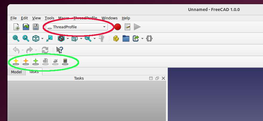

                    1. Start the ThreadProfile Workbench and create a new model:
                    Screenshot from 2025-04-14 09-27-10
                    The buttons ringed in green create the thread profile(s) and helix, and run the sweep.

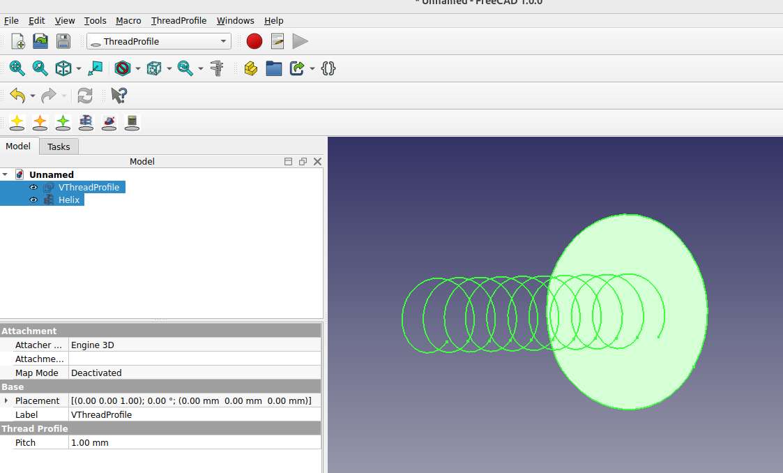

                    I clicked the Yellow button to create a V thread profile, and doing so activated the helix button:
                    Screenshot from 2025-04-14 09-39-22
                    The thread profile and helix can both be edited.
                    Clicking the sweep button generates a 3d model of the thread:
                    Screenshot from 2025-04-14 09-44-47
