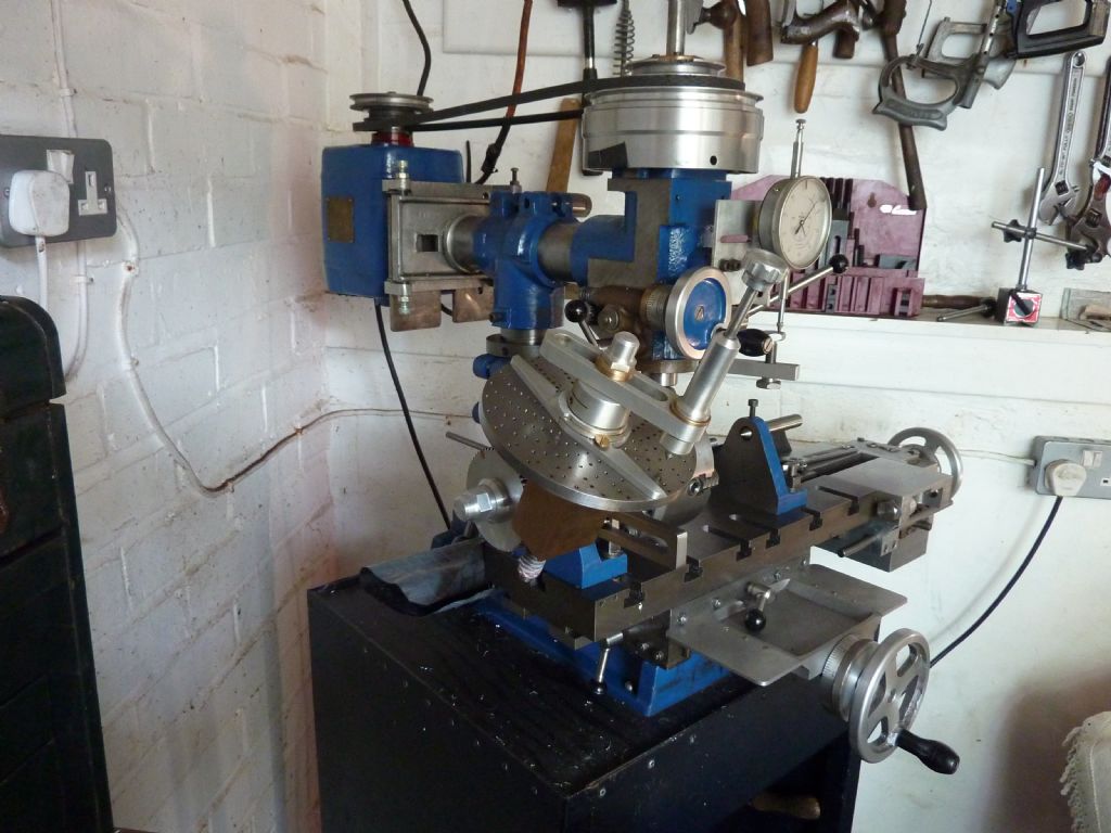

              Hi Rob , heres a pic of my DW mk1 , the plinth is 18 inches wide by 17 inches deep and the back of the motor is 10 inches behind the back edge of the baseplate of the mill with a further 2 inches to the back edge of the plinth, it fits nicely in the corner of the shop and when the table is fully to the right the handwheel is a few inches from the wall but enough room for manoevrep1010541.jpg

                Kettrinboy, thank you very much. Dullard that I am, I hadn't thought of mounting it at an angle! Back out to workshop with tape measure right now!

                  I've mounted my machine at an angle to to the wall, and partially covered the corner at machine stand height. This gives a cubby-hole for things not needed in a hurry, and more usefully a compact tool shelf.
