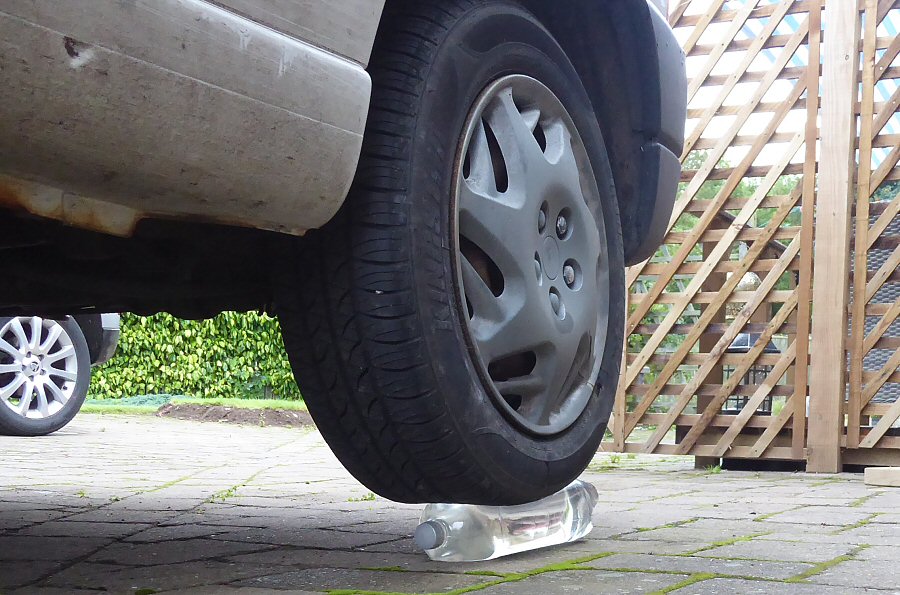

                              I was curious to see just how strong these bottles were, so I parked my van on top of one
                              I was impressed
