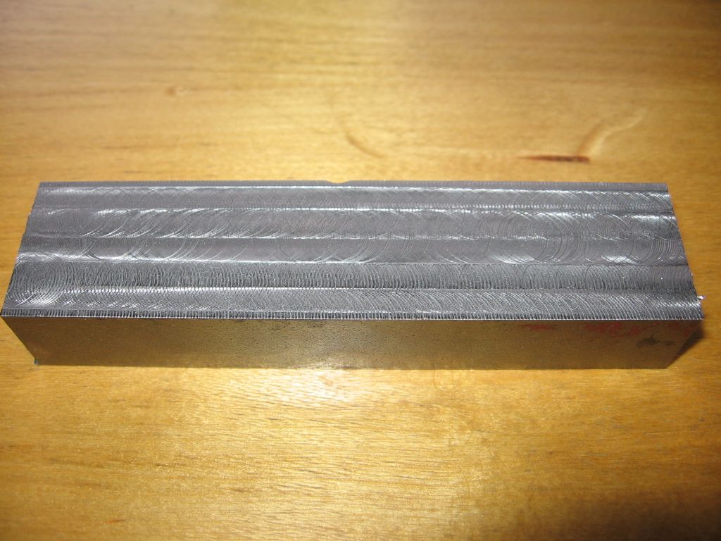

      I am making some clamps for the machine vice which involves starting with a piece of steel 30mm by 20mm, reducing the smaller dimension to 18.8, and then creating wide rebates on two faces. I have tried mutliple passes of a 12mm cutter, which didn't turn out too well, and logic prompted the realisation that the cut in a single pass is the best way. The title gives my thinking, a fly cutter with a HSS tool will undoubtedly be a bit cheaper but the offside is the resharpening of the bit by grinding which I'm not good at. By contrast a carbide insert face mill will cost a bit more initially but there is a lot less grief to reach the end, however other views are always welcome to aid the decision making process, any thoughts?

          What speed are you running the (presumably) HSS cutter at?
          How deep are your cuts?
          I had problems with TC tools as I was running too slow, TC should be (roughly) twice the speed of HSS

                Right, in answer to some questions I was cutting at 400rpm, which appears to be too slow, and with a v small DOC just to see what the finish was like. I have put a pic below, pretty it ain't, and I do wonder whether the cutter is a bit blunt. There are distinct ridges between the passes which certainly shouldn't be there. I have never used either a fly cutter or a face mill so I'm well in the dark, but from Jason's comment it seems a fly cutter is the first choice.

                  Looks like a blunt cutter to me or poor chip clearance. Poor tramming of the mill can also give this result where a trailing edge messes up the finish.

                    Hmmm, looks like the sort of finish you can get on hot rolled steel if the parameters aren't correct. To add to the parameters from Douglas I'd add feedrate. You need the cutter to cut not rub. I'd run the full depth in one go with a chip load of 0.1mm per edge. To summarise:
                    1. Check the tram of the mill
                    2. Make sure cutter isn't blunt
                    3. Run at a sensible spindle speed and feedrate
                    4. Brush the swarf away – if you're running fast 'n' furious the swarf tends to get thrown away, which helps
                    Andrew

                        Feed rate is revs x number of flutes x chip load so say 800rpm x 4 flutes x 0.1mm = 320mm/min or about two and a half turns of teh handwheel per second.
                        I have found the 2.7 likes a lower chip load, this is somewhere around 120-150mm/min.

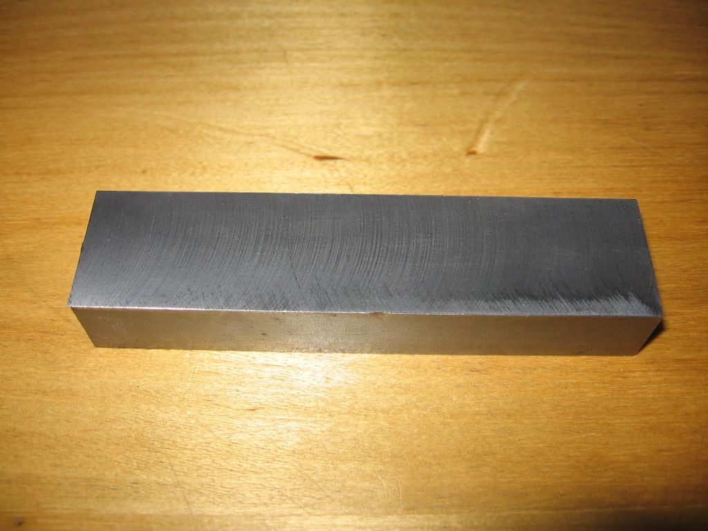

                                      Arc delivered to me a 2.5" flycutter and a pre ground HSS cutter, so thought I should try it out. Obviously never having used one before I didn't expect perfection however as you can see from the pic it is several hundred percent better than the first effort. I cut at 570rpm, a doc of 20 thou, and a fairly conservative feed rate, and whilst it's not glass and the tool marks are feelable it would suffice if surface finish wasn't critical, it isn't. I will do the other side at a slightly faster rpm to see whether that finesses the finish.The chips were definitely hot and tending towards blue, does this indicate the feed rate is still too high? A huge step forward nonetheless.

                                        Colour of the chips is probably more to do with cutting speed rather than feed.
                                        As slower feed rate will make the gap between each cut smaller so you will get a smoother cut the slower you feed.
                                        You can also get a smoother finish with a slightly rounded tip as the ones from ARC are angular, have a go at grinding the other end of the tool to match the preground one but just round the corner that is lowest, only needs a vert small radius that can be stoned on..

                                          Thanks Jason, I'll give it a try tomorrow.
