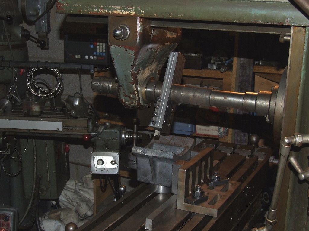

                  I don't generally use flycutters for flat surfaces, but I use a homemade one for curved surfaces:
                  I've never thought about angles; I just grind as per a lathe tool, in all cases, and it seems to work fine.
                  Andrew
