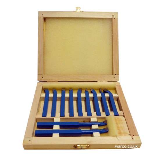

      Hi,
      Recently I have bought https://www.chesterhobbystore.com/shop/tooling-accessories/cutting-tools/taper-shank-fly-cutter/ fly cutter.
      As you see fly cutter comes with blank hss bit. Instead of grinding, can I use tungsten carbide lathe tools https://www.warco.co.uk/carbide-brazed-lathe-tools/193-11-piece-tct-turning-tool-sets.html
      Or do you have any document, what should be ideal shape for processing mild steel?
      Thank you

            No, the brazed carbide set you have linked to is not really suitable for a flycutter! – these tools are meant to be presented to rotating work and the shapes & angles are all wrong. Also they often need honing or sharpening before use.
            With apologies to Warco (if you had one, I’d link to it) – you can use one of these – I’d measure the slot in your fly-cutter and see if it will accept a 10mm shank.
            It is possible to buy your tooling so that most of the ‘everyday items’ take one standard type of tip/insert (i.e. CCMT06020*) which keeps things simple.
            https://www.arceurotrade.co.uk/Catalogue/Cutting-Tools/Lathe-Turning-Tools-Indexable/ARC-Indexable-Turning-Tools/ARC-SCLC-L-95-Turning-Tool-Holders

                    Regarding the specific set mentioned by the OP, I couldn’t really see anyone with a std. flycutter getting much value out of it, by pure chance the great majority of the included bits being almost extraordinarily unsuited for that particular purpose –
