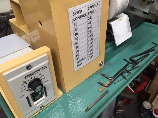

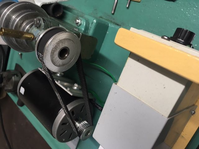

                                      img_0677.jpgAndy,
                                      I have also used that supplier and had good service, I decided I would rather have a plastic enclosure for the controller and sourced the one in the pics.
                                      Its actually an old early Perris lathe that I use to touch up lathe tools etc.
                                      #659774

                                            Hi Andy,
                                            The motor supplier was very good – I had an issue with the metal speed controller on delivery and he replaced it immediately with many appologies.
                                            I didn't like the open nature of the metal controller – even shielded etc and found the 'boxed' one Iimg_0676.jpg have used.
                                            It comes mounted in a plastic enclosure on all sides with only very small vent holes on the rear where the wires connect.
                                            I can't comment regarding '100hz' noise as I'm not really up on electrics and I don't recall any noise.
                                            I boxed in the headstock – a bit like my Cowells to keep grit/dirt out and installed larger oil feed fillers to the headstock bearings as it only had drilled holes previously. the little hinge on top gives access without taking the encasure off.
                                            The pics seem to go where they want to – not at the bottom of post !
                                            I'm down the coast from Bristol if your are local.
                                            When you decide I can look up the ebay listing for the controller – they came very quickly -couple of days – but I think it was a chinese local supplier.
                                            Richard B.
